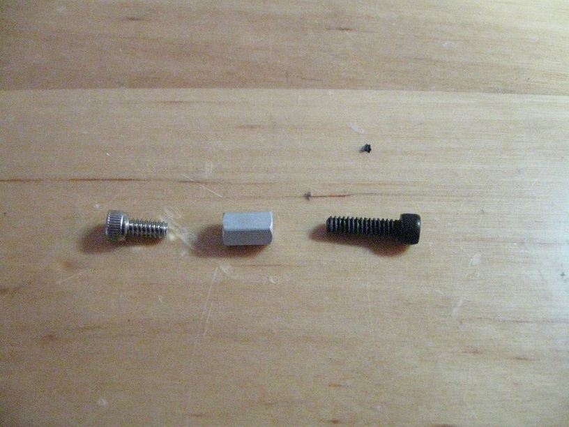

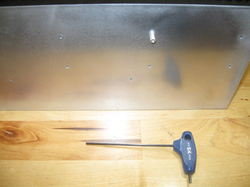

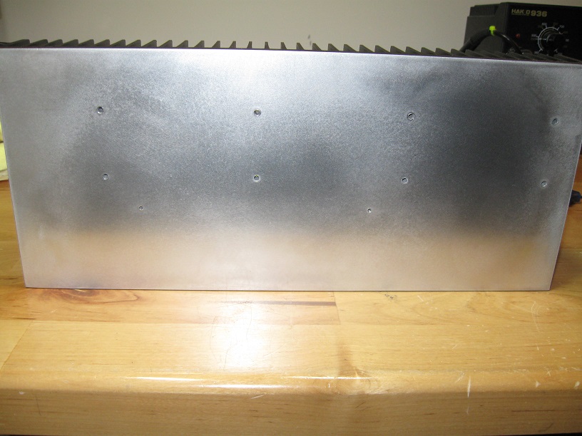

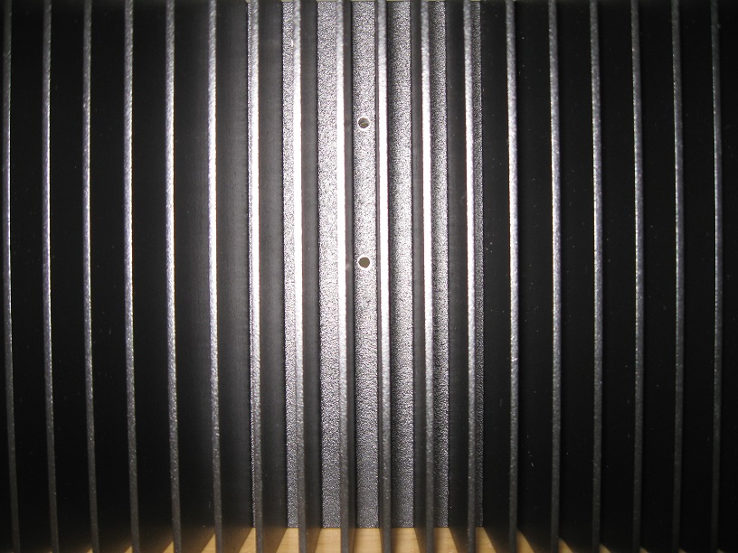

The HiFi2000 heat sinks, both the single-piece 300mm and the dual-piece 400mm have their fins spaced at 10mm. The same is true for the Conrad heat sink. That means the spaces between the fins also occur in the same 10mm interval. If you have a PCB with mounting holes on a 10mm grid, you can align them with the spaces between the fins and drill through-holes instead of blind-holes.
You can then insert a screw between the fins and attach to a female-female style standoff on the heat sink’s flat surface. That will save you the additional work of tapping those holes.

But even after I became comfortable with the process, I decided that there really isn't any reason to always drill and tap blind holes. That's when I decided to use the female-female style standoff with screws whenever possible.

The larger ones are through-holes.
One standoff installed and the long stem Allen tool I used to drive the screw between fins.
