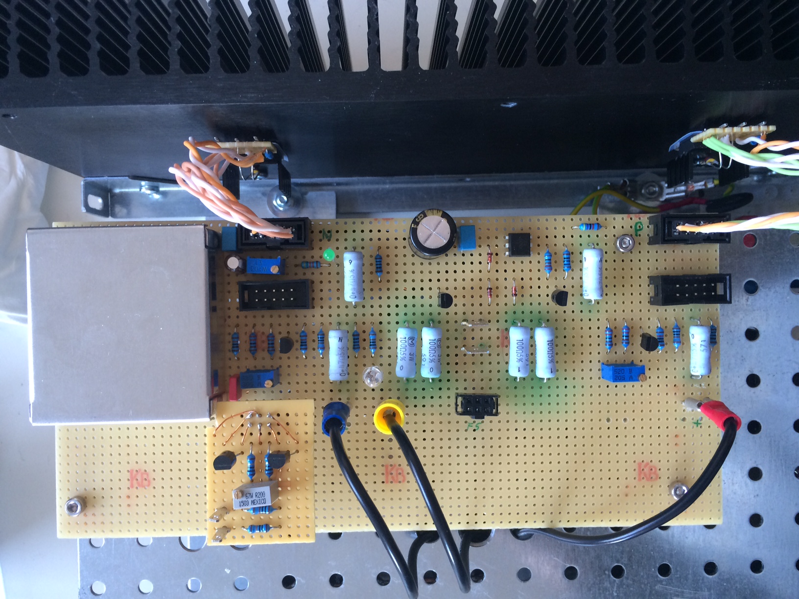

however , upon completing the amp , if output offset stubbornly stays negative , decrease R6 ; if it stays positive , decrease R7 ; I believe I needed 39K for one , but can't remember which ; even though I used FQP/FQN parts , Geschenk by my älterer Bruder Generg
Yes ZM, we did read your post. You described the solution to an "output offset stubbornly stays negative or positive" situaton, but ElFishi's problem was shifting output DC offset on mains variation due to Vgs difference of N and P output MOSFET.it seems nobody is reading entire thread as I said ...
Agreed. However, with all due respect to the design of the M2,ELFishi needs to make that amp properly , then reasons for worry will be non-existent ...
Of course the "some mv" drift should not be enough reason to worry about, I simply offer an alternative for those seeking more fun from diy, no disrespect intended.The offset of an M2 will drift with supply some mV due to the mismatch of Vgs of the N channel vs P Mosfets. ...
Green LED works.
It drops about 1.8V. DC travel now to +-2mV, still monitoring.
I have readings of the total supply voltage from 44.9 to 45.4 V.
Simple multi-meter stuck into wall plug waves from 220 - 228V AC, I have little trust in that measaurement, though.
Math is in line, too:
Optocoupler keeps the two gates 10.5V apart, for zero DC the remaining 34.5V are shared 17.7 and 15.8V by R6+P1 and R7, respectively, as Vgs(P) is 1.9V more than Vgs(N), in absolute terms.
That is, R6+P1 are 112% of R7.
12% of supply voltage variation will thus go to DC output. This is the order of magnitude I experience.

Turning off the amp sends ca 2V to the output, does anyone else have that?
problem is not in amp's design or even outputs used (any adequate type of vertical or lateral mosfet) , but in physical execution of constructional details
I measured all my connections again, and once more cleaned out the space between the soldering pads. I changed the PS cabling from clips to 6.3mm connectors. Looks like the attached now. (removed the other clips I use for measurement, too)
Not sure the 2V would give a thump as it needs 5s to build up and much longer to decay again. Do you know the Vgs of your MOSFETs?
I believe you're having a thump without dummy load ?
I don't have any , loaded with slightly above 4 ohms , ~94db/W speakers
dunno Vgs of mosfets , didn't care
whatever you use , it'll have approx. same or even lower Vgs (N vs. P ) difference as with IRFP
OK, hooked up an old speaker. Small thump on turn on, no thump on turn off.
Output voltage only rises to 1V with speaker as load. But as I suspected: too slow to thump.
According to spec IRFP have Vgs of ca 4.9V and 5.2V @ 1.3A, i.e. 0.3V apart. My FQAs are 1.9V apart.

Fired up the Toshibas (no LED). Way better. Bought them matched for Vgs (almost) and Gm
Warming up still, but stays within +-1.5mV, thats beyond what I trust my DVM.
Interestingly they run at slightly higher bias, 1298mV across R13+R14, that is 1.38A. Was 1256mV or 1.34A for the FQAs.
Turn off DC excursion is 0.15V only.
In situ I have Vgs = 2.58V for N and -2.11 for P, but I knew that, since NicMac sells them measured. For R7 I measure 46.9kOhm (put in a 47K), for R6+P1 I have 45.7kOhm. For those out there with Toshiba MOSFETs beware though, your values may be different. It just so happens that with my Toshibas the pot would need to go to the other side if you were to stick to 47k for R6.
