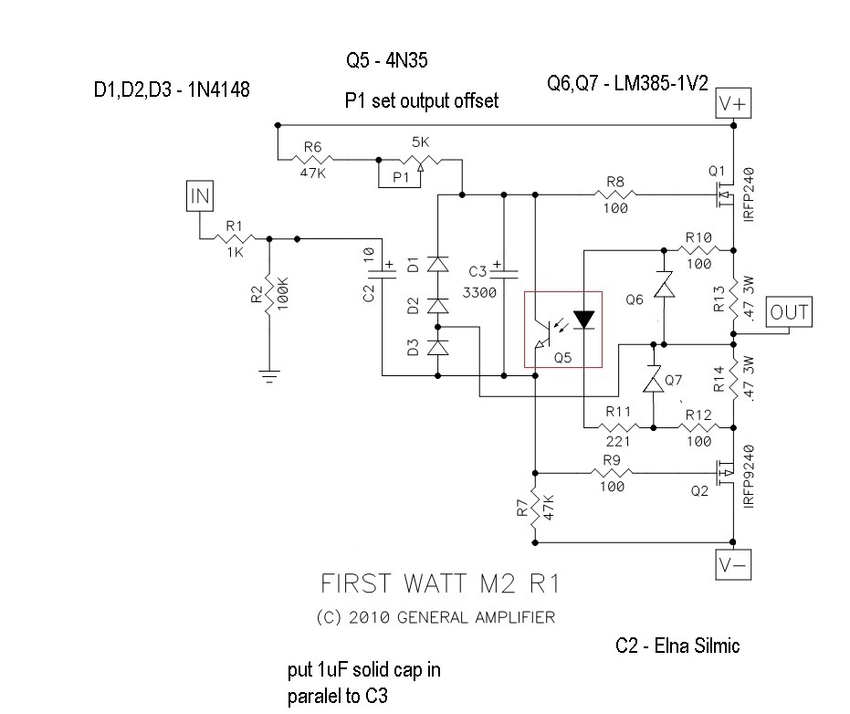

C3 voltage
Elna Silmic II 3300uF are available only for 10V. Is it sufficient voltage?
3300uF/16V sufficient
on the verge
use any decent electrolytic with minimum 16V voltage , bypassed or not with , say, 1uF solid cap
Roger that. Thanks!

Not sure I understand your question.
The data sheet shows the relevant contacts at
1 Anode
2 Cathode
4 Emitter
5 Collector
Have you come across a different pin-out?

in post #39 http://www.diyaudio.com/forums/pass-labs/281520-official-m2-schematic-4.html#post4495117
there is a pdf with , I guess , an error on the schematic .It make use of the Base ( pin 6 ) instead of the Collector ( pin 5 )
BTW no problem . I did already build a prototype and it works like a charm .
Nice sound .... and next days probably the other channel .
I did notice the PSRR being lower than the F5 . Should I look at a regulator or C-R-C-R-C until I am satisfy ?
Nope , not a different pin-out in se but
Well spotted. That is an error that has since been corrected by Jean-Paul in post #159
Yes, but what about R1-2?
Depends on what you want to use to drive the output. Without the transformer you have no gain.
Would there be an advantage to replacing R3 and R4 with a 200 ohm P2 as in the most recent versions of the F5 to adjust offest to minimal distortion?
Can anyone point me to the referenced F5 design and enlighten me why it would be 200 Ohms and not 20?
Is there a pedestrian procedure how to adjust to minimal distortion apart from my stellar hearing? Or is it simply adjusting to have DC vanish?
