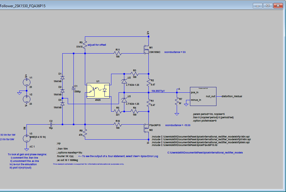

Official M2 schematic
Oooo.....I like this combo...🙂

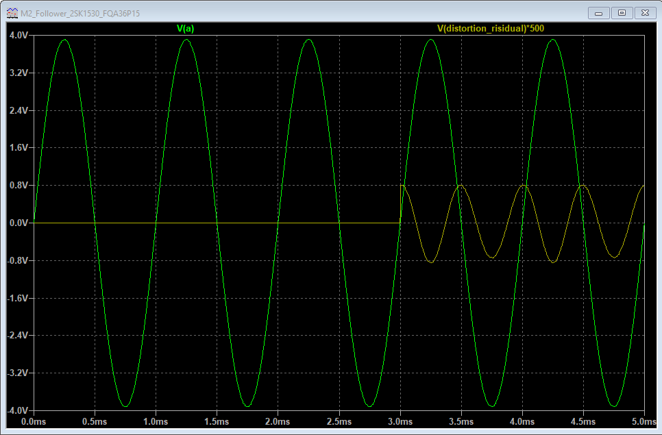

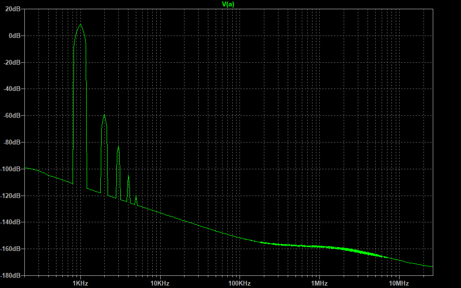

Easier to implement than a Schading. Just replace P-ch FET in my case 2SK1530 already soldered in the board.

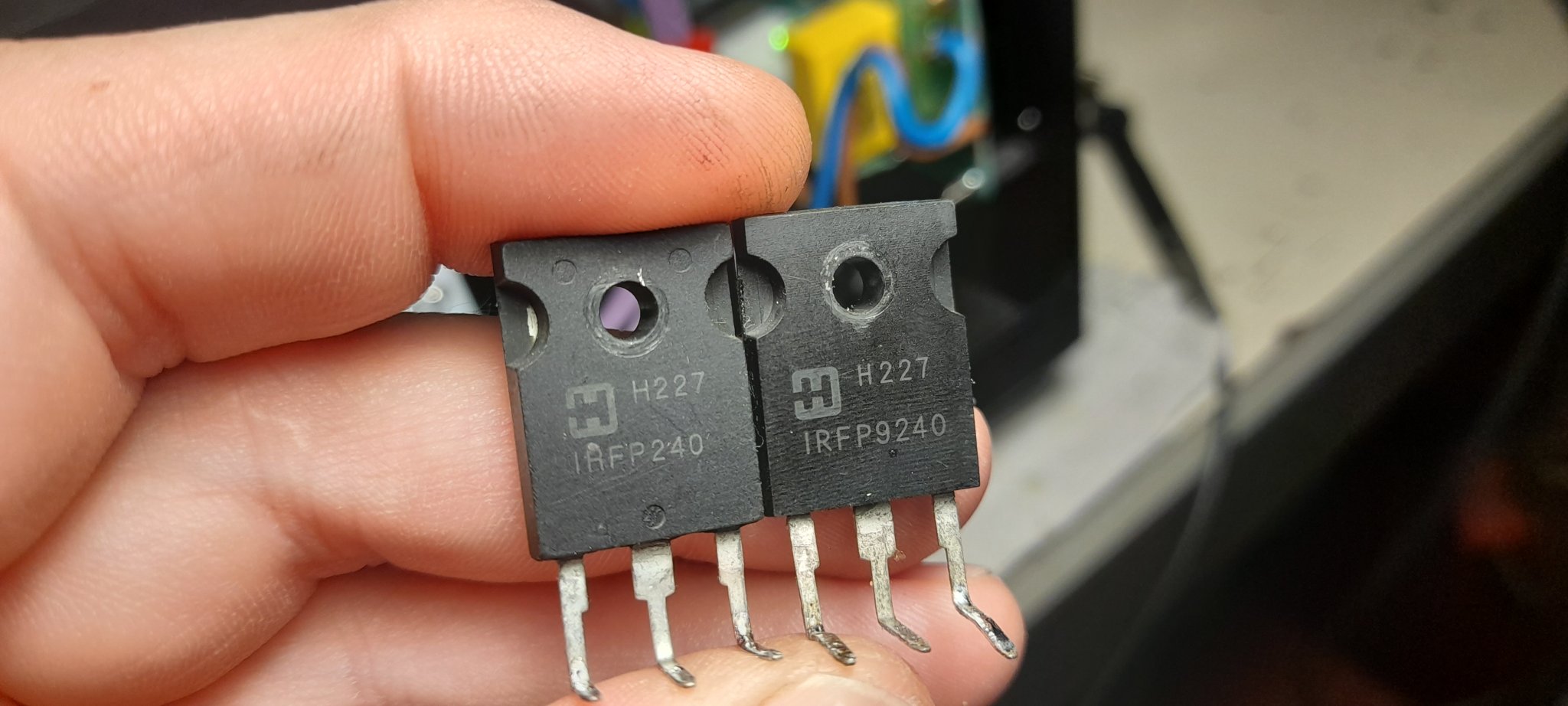

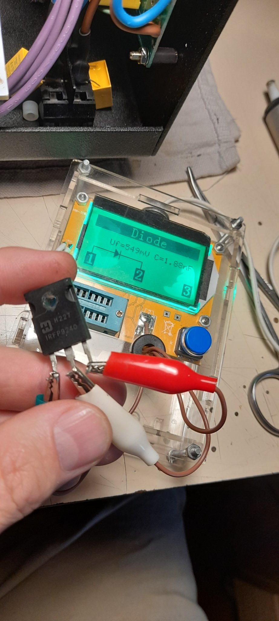

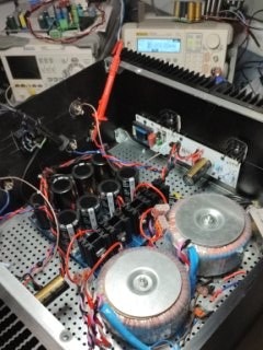

The trouble I experienced with the M2 DC offset that was drifting was due to a blown IRFP9240. I am convinced the supplied Harris Mosfets are fake - or at least the P channels. The surface texture of the package looks suspicious.

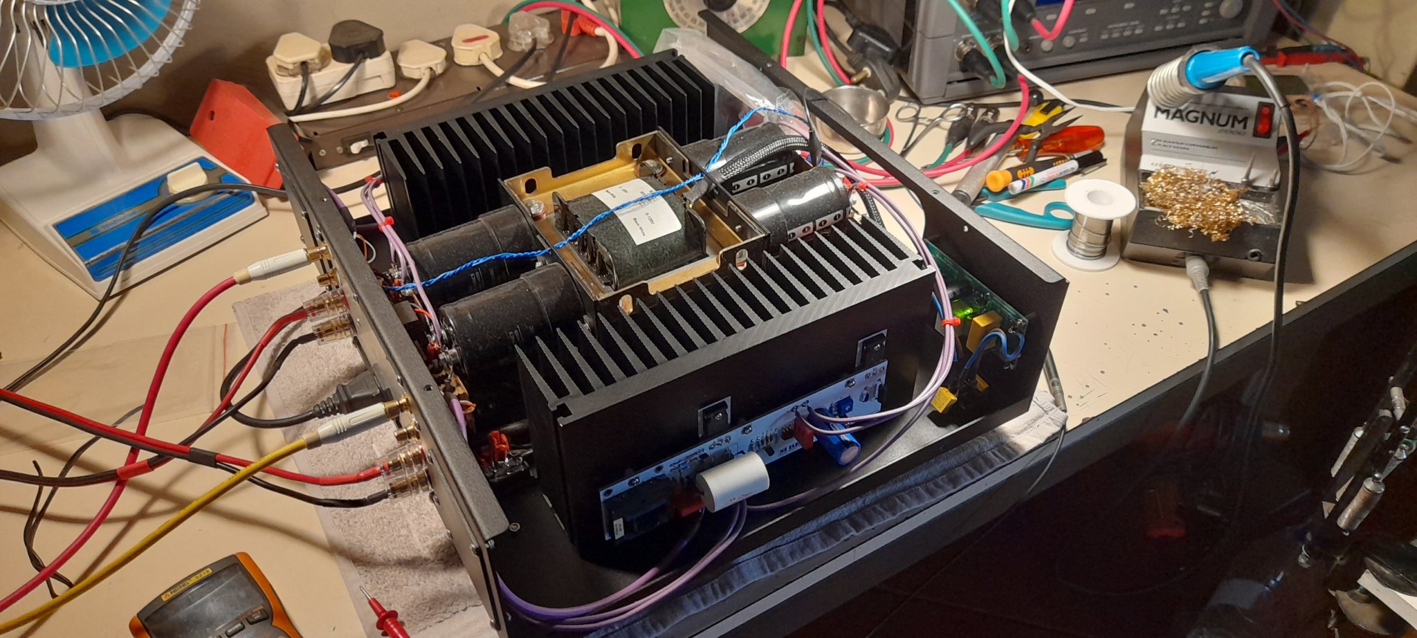

The last bit of trouble I am encountering is a slight bit of hum - but it is not magnetically induced. I have moved the channel with heatsink away from the mains transformer and the hum level remains the same. It must be some ground loop issue - yet I have connected everything as per textbook.

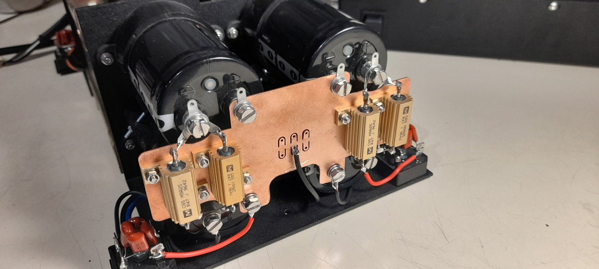

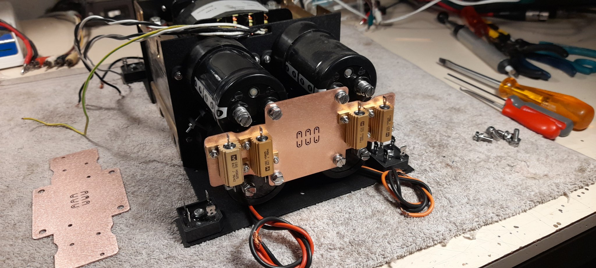

I had two copper ground connector planes made for the capacitor banks. Came out well.
