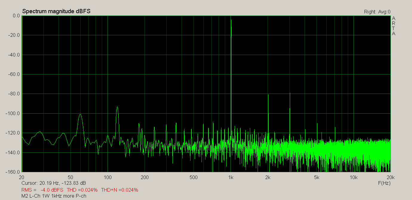

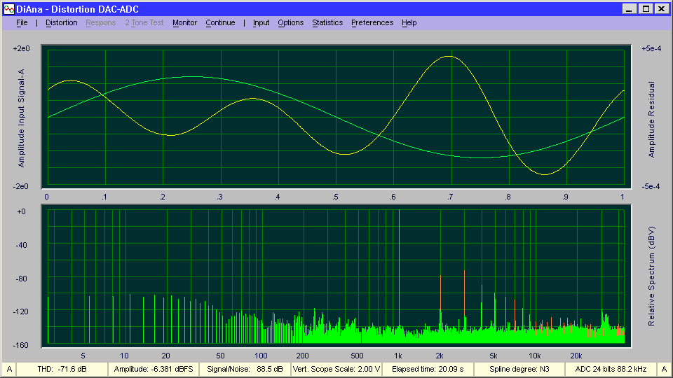

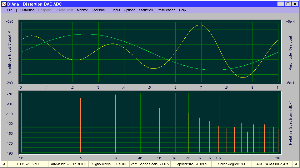

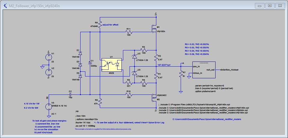

After what felt like YEARS of trial and error, I finally got my old sound card to talk to the DiAna s/w thru ASIO4ALL. So here's the residual distortion as seen in DiAna at 1W into 8ohms. Finally a way to confirm H2 (and H3) phase in vivo... yep it's negative.... coolIn my M2 clone, I added a 1R3 ohm resisitors in parallel with the original 0R47 source resistors to lower them to 0R345.
I simply removed them from the R2 positions and zeroed the output offset to try favoring the P-ch. It raised H2 to about the same level as H3 as seen in the measured spectrum.
I like the sound, more relaxed and spacious was my impression. I'll leave it like this for a while.
I need to get a twin-T notch filter built to look at the residual distortion in real time.

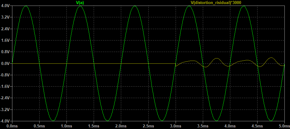

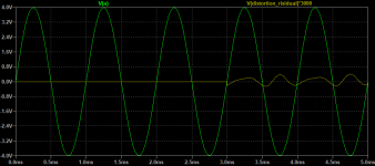

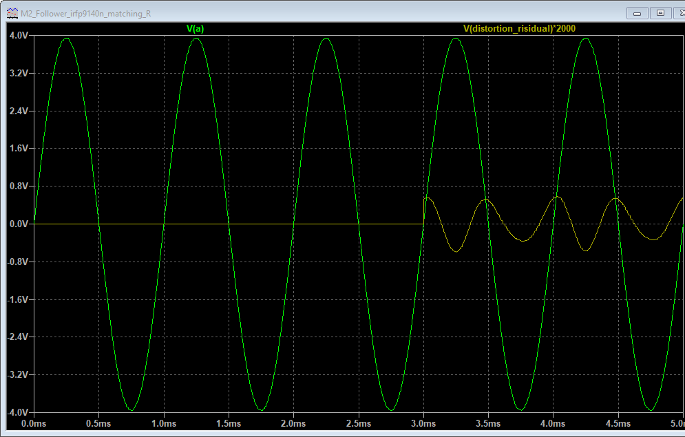

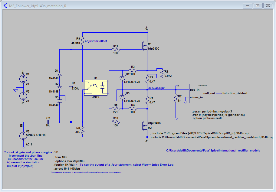

you can alter it - changing type of mosfet in OS
different xconductance, different THD Spectra
see what you get with IRFP150 in place of IRFP240
not what I was saying
leave same original source resistors, just add another IRFP240 up, ( so having pair of 240 up, just one 9240 down)
that's cheating LTSpice , in vivo IRFP150 is practically pair of IRFP240 in one case
Yes Diana is a wonderful woman! Thanks to the creator!After what felt like YEARS of trial and error, I finally got my old sound card to talk to the DiAna s/w thru ASIO4ALL. So here's the residual distortion as seen in DiAna at 1W into 8ohms. Finally a way to confirm H2 (and H3) phase in vivo... yep it's negative.... cool
- Official M2 schematic
