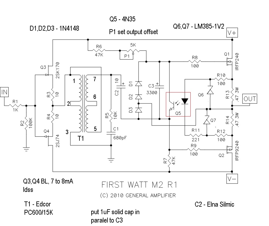

He means Q6 & Q7. LM385 are shunt regulators and due to C3 it takes some time until bias voltage rises up to its final value.I too had a good look at the pictures on 6moons and didn't see any regulated supply. But this line from http://www.firstwatt.com/pdf/prod_m2_man.pdf is what prompted me to guess so, "It takes about 1 minute for the regulators to come up to full voltage, so don’t expect full output power for that time." (page 7).
nope
LM385 are there for safeguarding duty (so no chance that opto-diode goes poof)
you can go without them ....... or change with 1V25 zenners ...... if you find them 🙂
try to analyze circuit without any diode - it'll work
then add one by one , and you'll find what each one is used for
LM385's have important function that is not protection.
The 1.2V shunt reg is balanced off against the 1.2V forward bias of the
opto, and keeps the bias circuit from reacting to output current much greater
than the bias current.
This way you can go into Class AB mode with low impedance loads without
creating problems.
Without it, a high current transient would be interpreted as high bias, and
would drain the capacitor, requiring some time to recover.
creating problems.

After examining my build, I finally found the problem. I followed the schematic in post 39 of this thread (Official M2 schematic) wherein the Base of the transistor in the Optocoupler is connected instead of the Collector. Need to make modifications in the home etched PCB to verify M2's proper working now.

damn
next time you'll know better - always use original schm .......
let us know outcome .......... though , I couldn't wait no longer than Pronto! to redo the pcb and try .....

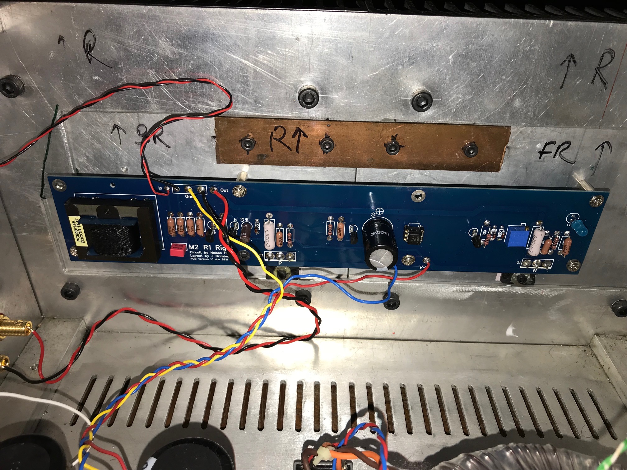

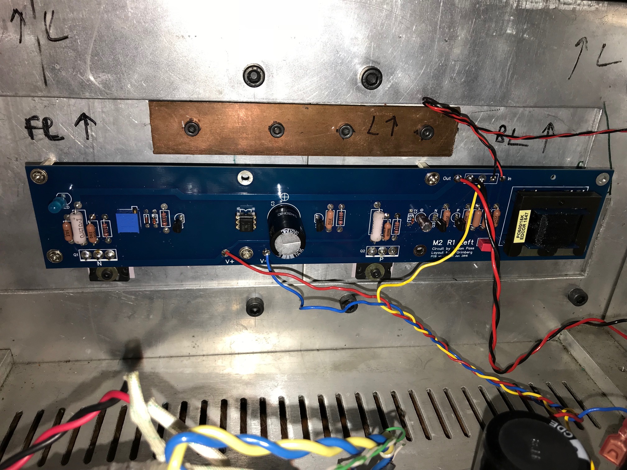

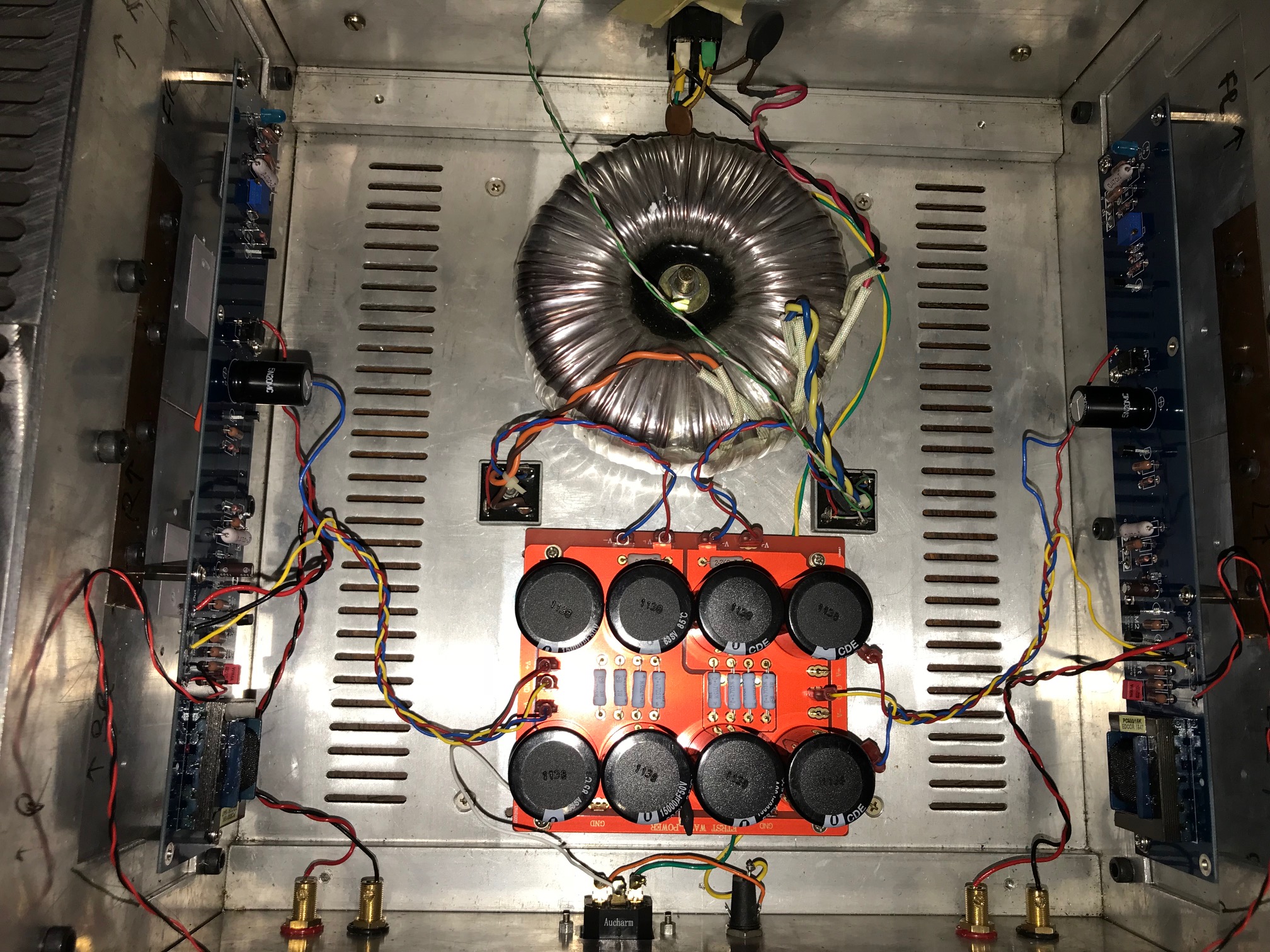

Every Christmas vacation, I end up building one amp from Papa. This Christmas I set about making a M2 using an existing F5 chassis. The boards are from Grimberg group buy.
Used light bulb to test out each channel and things are fine. No short or anyu other smoke.
Both the channels show up a +ve offset at the output of around 3V (yes volts) and not able to get it to zero on either side of the offset adjustment trimpot.
I am using some random Toshiba 2SJ201/2SK1530 pair (not matched). Could the offset be so much due to big possible variation on VGS of the Mosfet pair?
I do have close matched IRFs which I bought for F4 build (IIRC). Should I try that option or adjust the R6/R7 values? I am baffled by this large offset.
There are no parts getting heated up other than R13/R14s getting warm.
Need suggestions/advice on reducing the offset.
Thanks in advance.
Cheers
Anil

please post actual schematic and pictures of build
write down what is voltage across source resistors , what is exact (minimal) DC offset you can get with trimpot on end , taking care of proper polarity (probes)
then we can help with more specific steps
