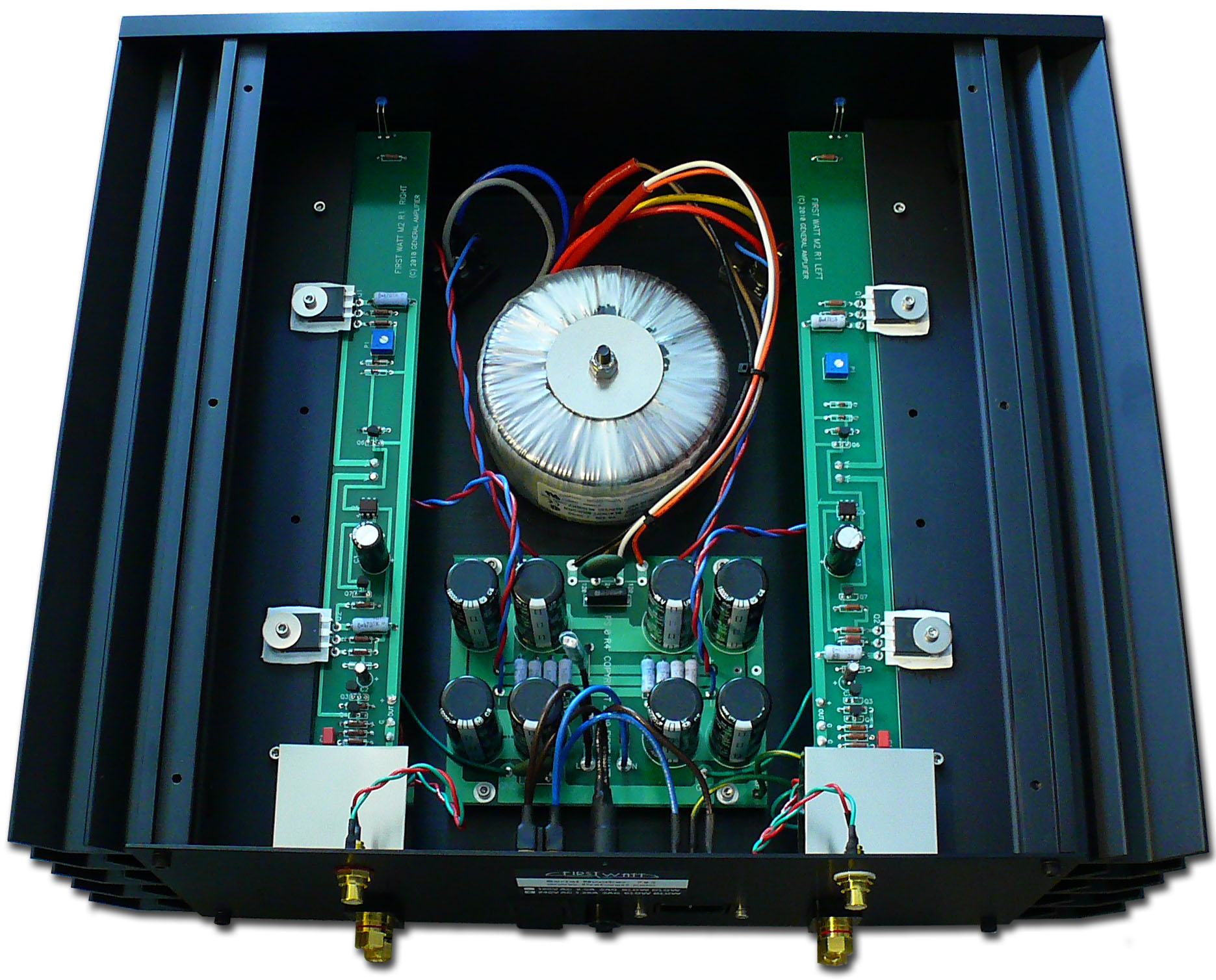

Last night I listened to M2 singing with grimberg's board and Fairchild mosfets from buzzforb (FQA12P20/FQA16N25C).
Was able to zero output offset so the amp was dead quite.
At turn on (when amp is cold), you need to wait few secs. (~15) to stabilize before you can hear output from speakers.
However, I noticed the supply voltage sag different from both polarity (~0.3-1Vdc). Also, Vgs between N and P channel is different being 3.7Vdc from the N and 4.3Vdc from the P channel.
Is this normal due to the variation of N and P channel mosfets?

In Teabags instructions, he noted that it was just a personal thing, and made the Harris unit available.The Vgs between the P and N channel are just differnent. No worries there.
There is an anomaly with the one unit, I have used them with no personal issue, and as I remember back when I was building F5, Peter Daniels noted it, and had no issue with it. In that amp I found it rather nice.
As to the M2, I personally have only used Teabags sets, which included the Harris mosfet. If I was in posession of just the Vishay units, I dont think I myself would be alarmed.

Tried the Toshiba OPT 2SK1530 & 2SJ201 been keeping some time, I thought its a good place to put this. I bought it from Blues intended for F5 few years ago. Highs and low significantly improved compared with FQA.
Vgs +/- diff now the same and supply drop tends to get closer probably because of the closely matched outputs. Slightly higher bias (R13/R14 drop 0.6Vdc compared with 0.4/0.5 of the FQA).
Used 1KVA torroid tranffo from a defective UPS having secondary 21.5Vac (14Vdc). Several hours playing did not even get warm🙂
