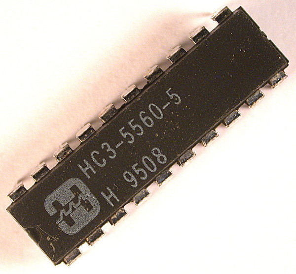

Yep; judging by the date-codes on my parts and yours, it happened sometime between 1991 and 1994.

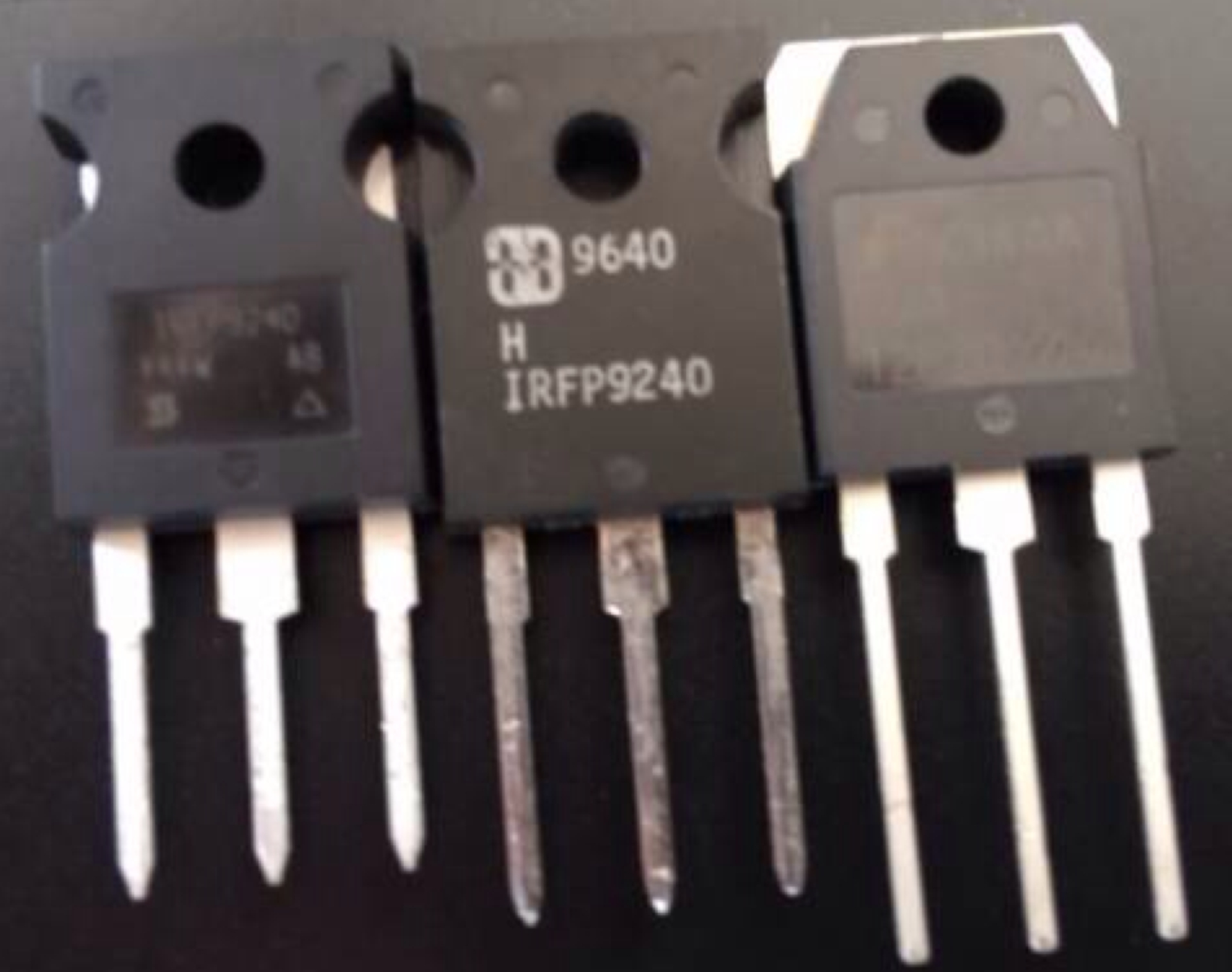

Interesting. 1996 date-code with old logo.
Makes me wonder if the first one you posted (948) isn't the 48th week of 2009, rather than 8th week of 1994.

Thanks Jeff interesting interpretation.
So is 3 digits date code.
48 is the last week of the year
The logo change most likely occurred at the time when Harris decided to sell its commercial and military semiconductor product lines, which happened in 1998.
The IRFP9240s I have display the newer italicized "H" and have manufacture date code: 9840.

I have a couple Harris IRFP9140 with date code of 9540 that looks like
the middle one in post #2183 by Soundhappy. Got it for the original
Zen amp from Mouser around 1996.

Just to be clear, it is my understanding that the outputs Teabag has, (but I do have an inquiry to him) is that these are not Harris pairs, but a combination of Harris on one side, and Vishay on the other.

... but a combination of Harris on one side, and Vishay on the other....
That's what I use too. It's only the IR/Vishay P-channel parts that have the linearity glitch.
Jeff.
Mine uses Vishay FETs in both positions, I suppose time will tell if I'm disappointed with that choice 😉
