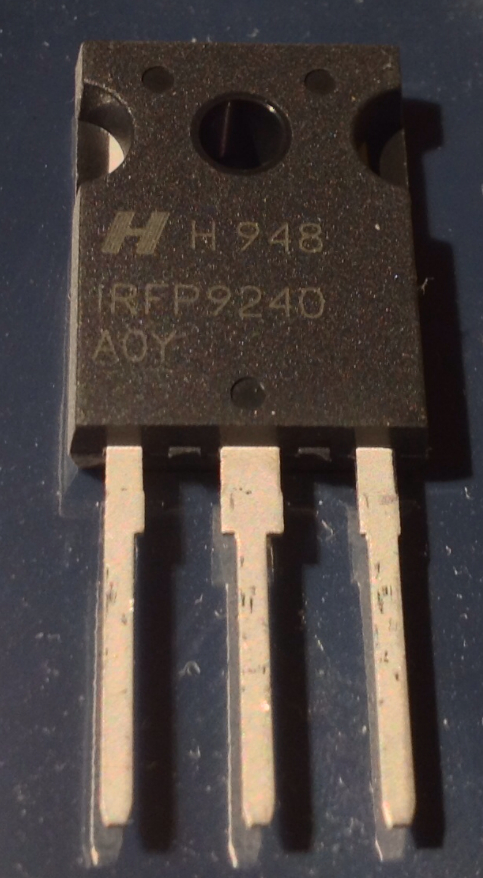

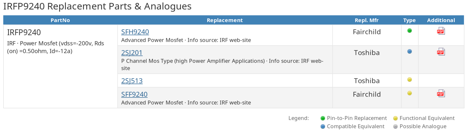

It just occured to me that vishay may have merged both IR and Silconix parts under the same irfp part number.
Anyone know if this is true?
Either way, no one ever talks about siliconix, have they ever been tested by anyone here?

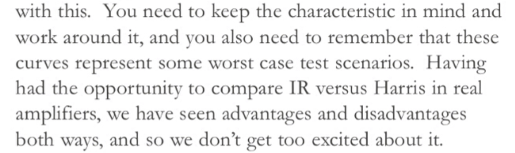

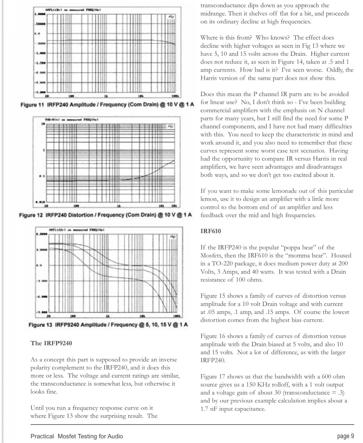

I am sure you already have it printed and plastered on a wall, but here is a link to the relevant article anyway.
http://www.firstwatt.com/pdf/art_mos_test.pdf

Yes by Mr Pass
Page text and graph show by courtesy of First Watt

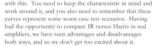

I try both Siliconix IRFP9240 and Harris and i agree with Papa conclusion.I'm certainly not losing sleep over this one. I'm just curious about the Siliconix parts.
Nothing to be excited too much about it 🙂
Those parts Nelson is referring to in that article are not Siliconix parts.
They are the original International Rectifier parts.
What I am wondering is if there are differences between Siliconix and IR.
Vishay now own both product lines.
To be specific, I wondering if there are differences between Sihfp9240 and irfp9240
Yes, they have not original IR package logo, but inside is the same.
IR = Vishay= Siliconix
Vishay - Company Info - Vishay History
the stuff we find at Mouser for example are IRFP9240PBF and is RoHS compatible now.
This new Pb free version don't mean is not the same old IR semiconductor technology line product inside.
Vishay is packaging and this Guy's doesn't invest any money to make them perfect for audio
because this applications is not the big market place purpose.
Equivalent transistors can do the job and Rochester 8K pcs of Harris wait for Diyers.

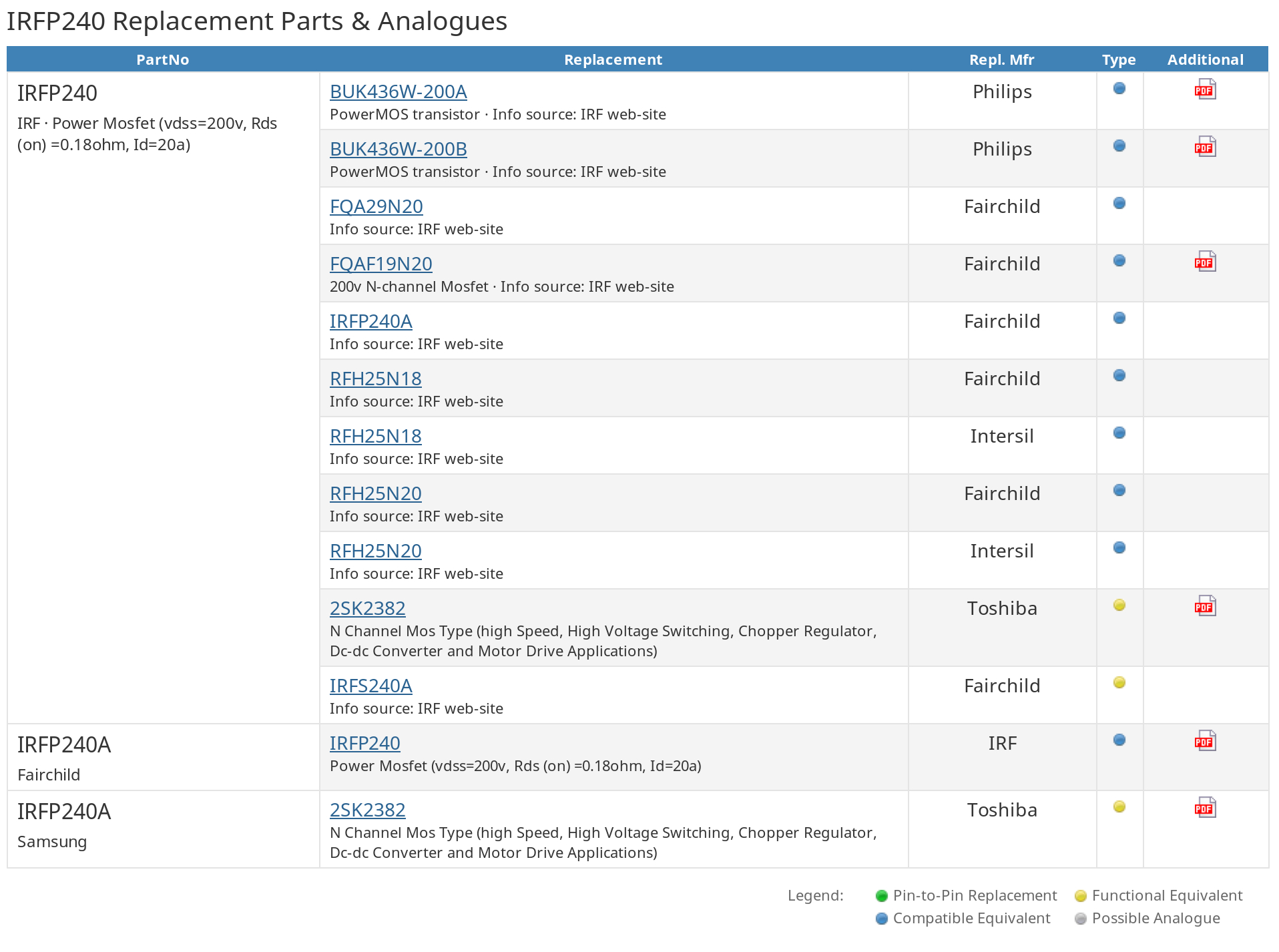

I know IR = Vishay
But does IRFP9240 = SIHFP9240 ? That is, are they manufactured from the same plant to the exact same procedure and materials using the same manufacturing equipment.
SIHFP9240 only place i know is in Vishay documentation,
don't see any specific SIFP transistor reference we can buy somewhere.

Could we find some IXYS brand pairs maybe for M2 ?
I like IXTQ36N30P and IXTQ36P15P, which seem a pretty good match to me. Kind of like two IRFP240/IRFP9240 glued together in one package, but with higher transconductance and a better junction-case thermal resistance.
Haven't tried them in an M2, though they are currently serving nicely as source followers in another of my amps.

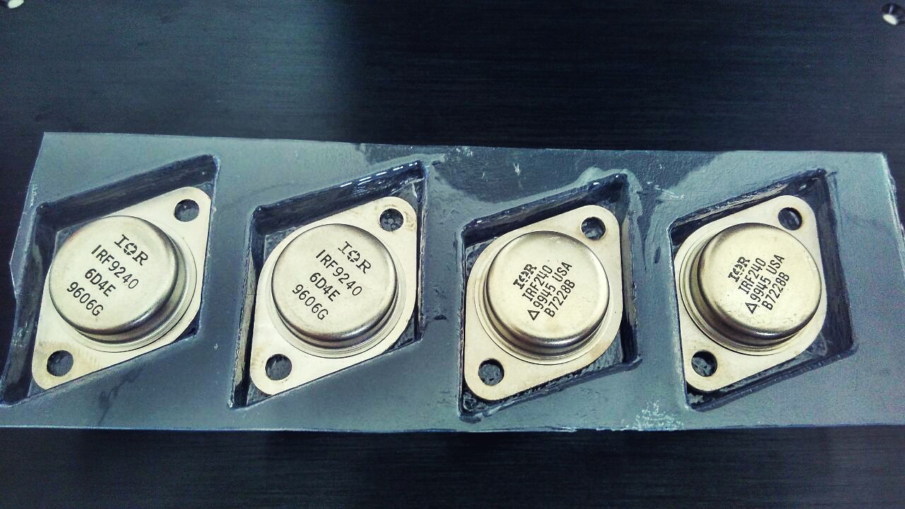

anyone tested M2 using this metal can?
Yes, and I have a few thousand of them. Same chip as the plastic.
That character of P channel types was an IR phenomenon - Harris and
Samsung and a couple others do not exhibit the transconductance shelf.
I seem to recall that at one point Samsung parts were acquired by IR,
so there were examples of IR parts that didn't have it.
The IR parts work, but you can measure a difference, which shows up as
an alteration in the distortion character between lower and higher
frequencies. Not a big deal, more of an issue for no-feedback amplifiers
and Common Source use.
Last time I tested Vishay IR's, the parts behaved the same as earlier.
