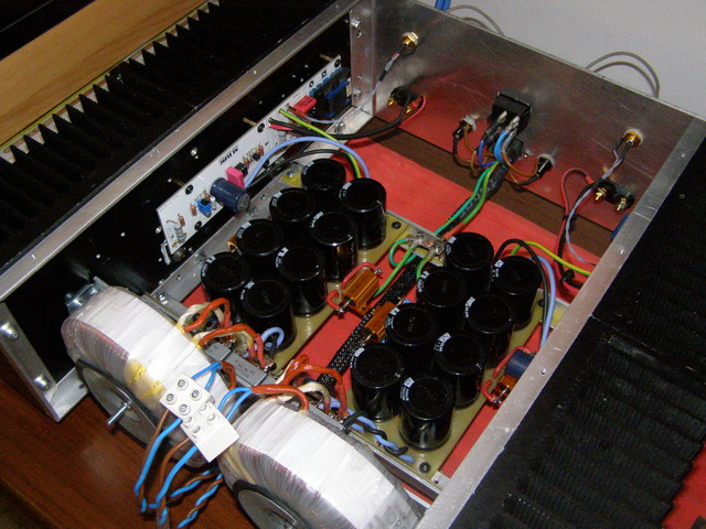

(drazen, i think your heatsinks are too small LOL. Nice amp)
yes, the whole case was left out of another unfinished project, so I used it for M2, and heatsinks are enough for Aleph 5.
