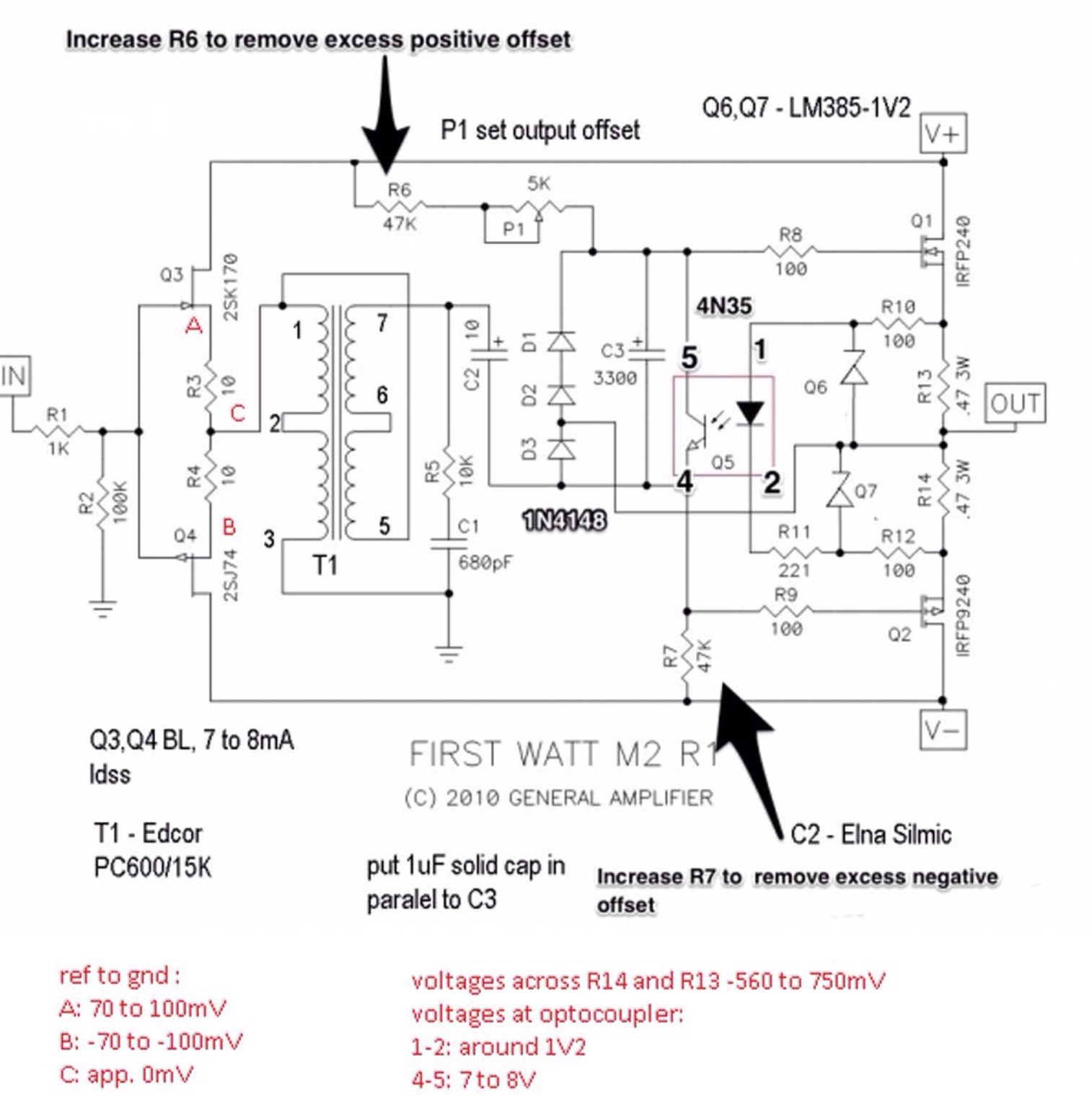

Official M2 schematic

As for my issue regarding the left channel bias. I still need to go through the board tonight and check all the resistor values. However, could a faulty LM385 be playing a roll? I just want to make sure too that I am correct in understanding that R11 (221R resistor) sets the bias. I'm going to try and find time to get this all sorted out by the weekend, I want to give this thing a listen!
:cheers:
The opto-couplers appear to be positioned correctly (glad I used sockets on those) and all the resistor values appear to check out. I traced everything on the pcb and it all seems to check out fine, I wanted to ensure that the coupler was in there correctly. Pin #1 is the LED anode, which is marked with a dot on the Vishay 4N35s that I am using. On the left channel PCB, mounted with the FETs pointed down, the pin #1 dot should be in the upper left corner.
If the opto-coupler was in there backwards it wouldn't work at all right? I need to look closer at the back of the board, but is it possible I could have a solder bridge lurking across one of the LM385s?

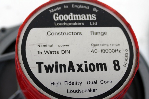

20 watts is plenty of power with efficient speakers especially with 4 ohm's
you get twice so non need for parallel transistors output stages.
Goodmans Axiom8 is happy with 15 watts for example 😉

Offset regulation is more easy and precise with add of another trimmer connected to R7.
Maybe future M2 pcb's in DiyAudio Store can be with this option included.🙂Greetings

considering that there is already one trimpot in series with R6 ........

I have do it and work very well for me.
In a situation of excess negative offset
with the series connected trimmer to R7
that precise resistance value is made easy for optimal ~ 0 MV offset.
Without that you roll resistors in R7 position who are soldered and re soldered on the pcb to find right spot ?

Earlier in this thread Nelson Pass described different aspects of how the circuit works and reminded builders that the commercial version used Fairchild devices.
After I built my own PCBs I talked about adjusting the resistor values when using IRFP240/IRFP9240 MOSFETs. Zen Mod also added information regarding adjusting the offset. As you can see, other people already provided ALL the information you need. You just failed to read it.

I do use 10K trimmer ( 2K5 position at start )
so not worry about incrase of resistors if needed.

A silly idea:
What about soldering machine pin sockets at R6 and R7 and then
start by fitting them with the nominal 47K resistors? One can
then easily adjust the resistors as required and then add a little solder
from the top after verifying that P1 can null the offset.
