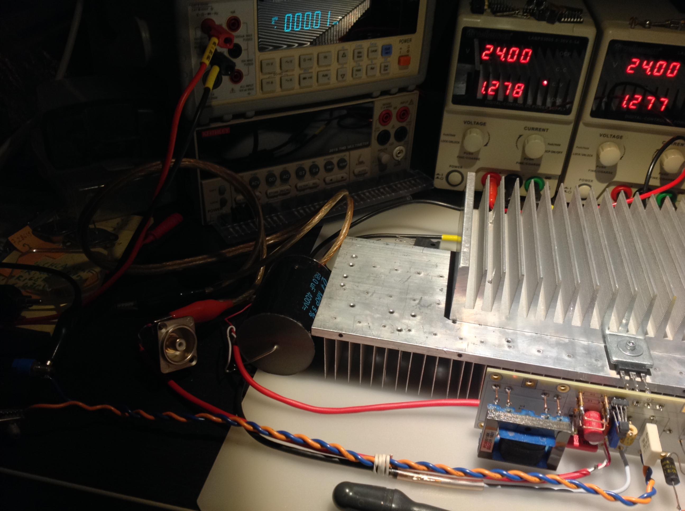

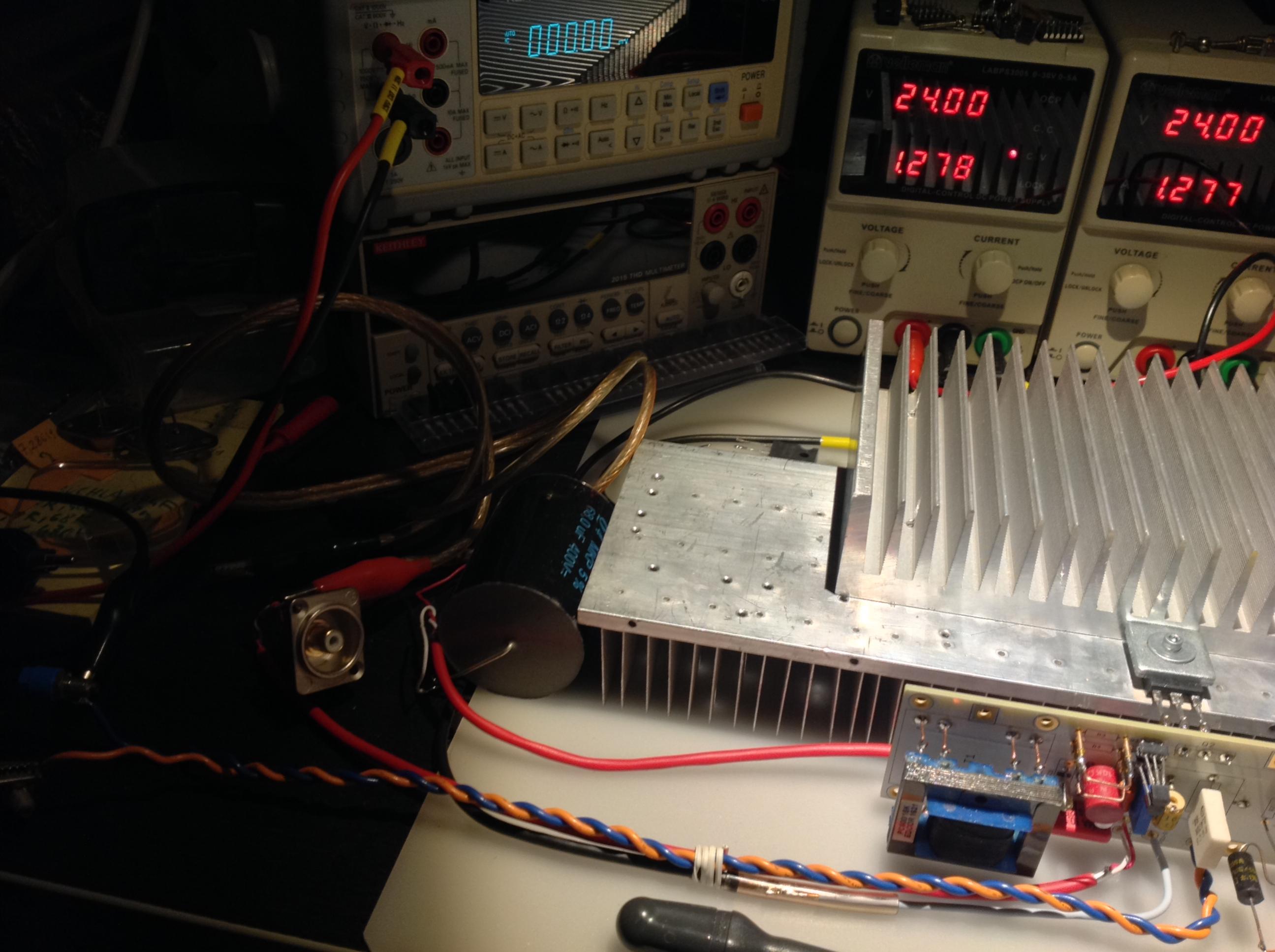

I've finally taken some time to work a bit on some of my audio projects, it has been some years since I worked on anything audio related. I finally have my fall/winter M2 project to the point that I could fire up the right channel for some testing (a little a head of schedule). The left channel is 99% done, but I need to give it one last check to make sure I don't have any solder bridges around the input JFETs as the solder pads are pretty close together. I'm using grimberg's boards by the way, which are fantastic!

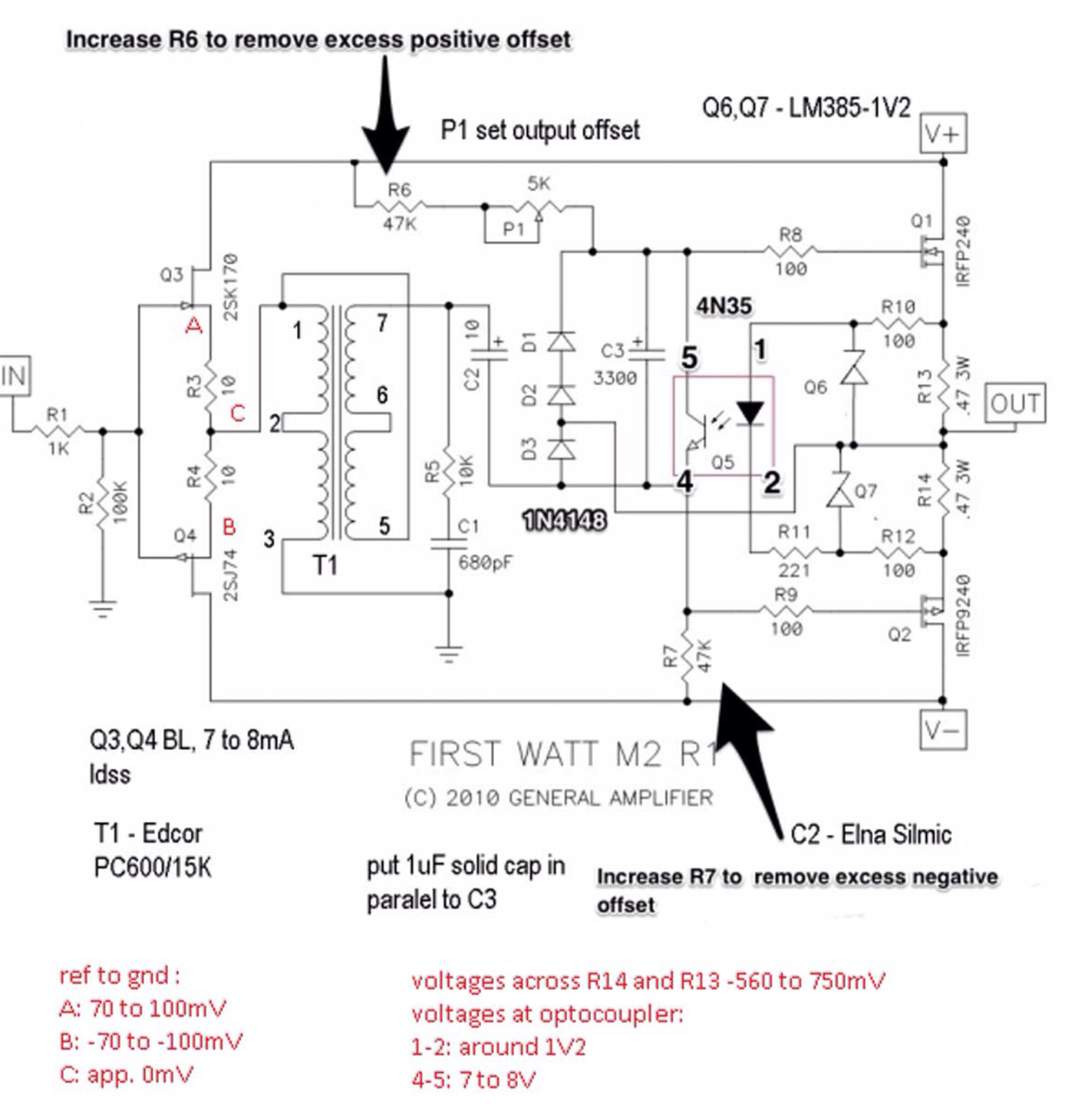

The left side seems to be working fine, it bias up to about 1.3A. However, I've only been able to get the offset to about -0.126v before I reach the limit of my 5k pot. I just wanted to confirm with the experts before I changed anything; to adjust that last bit of offset out I need to lower the value of R6 correct? I just want to maker sure I'm interpreting what ZM suggested way back in post #17 correctly. Thanks in advance!

I am glad the boards worked out well for you. Regarding the stubborn offset, you have the option of adjusting the values of either R6 or R7. In my case it got stuck around -50 mv. I resolved it by replacing R7 with a 49.9K resistor.

My information and Zen Mod's are not contradictory. There is more than one way to skin a cat.
With the positive multimeter probe on the positive output and the negative probe on the negative output, what is the lowest DC offset you can achieve? The polarity in your answer is important.

Yes, short the input.
No dummy load necessary.
So, what is the DC offset in each channel?

Offset values is close to perfection so i don't touch it.
<1mV, way less. +- polarity, does it matter?
Soundhappy thought he would have to make changes to his M2. He was not sure what to do, that's why I asked him for the polarity of the DC offset. It would be useful in determining what resistor value to use.
If yours has <1 mV, to me that's perfect. No need to do any thing, just enjoy the music.

Thanks for the info everyone about the offset, I'll play with some resistor values and see what I can do. I'm using IRFP240/9240 FETs from Vishay by the way.
I have the other channel hooked up and another issue has arisen. Upon full power-up the bias takes off and rises steadily to a tad over 1.166v across the source resistors (about 2.5A), almost exactly double the bias of the right channel. Parts values seem to check out OK, but I'll give the board a better look when I'm less tired. I switched out the 4N35 and no change. Only thing I think of is wrong resistor values(?).
