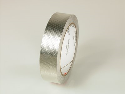

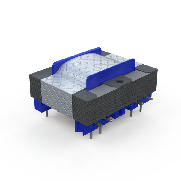

I have Mu metal for this, but I like Soundhappy's suggestion to ALSO use copper tape. Looking at Edcor's site, many of their transformers come in a shielded version. Poking around, they fully describe the material they use, which is a purpose-made solderable tin plated copper from 3M:
EDCOR - Copper Shielding
Lots of places carry the 3M Embossed Tin-plated Copper EMI Shielding Tape 1345 in various widths and lengths. Not cheap for the continuous rolls, but I think I'm going to try it.

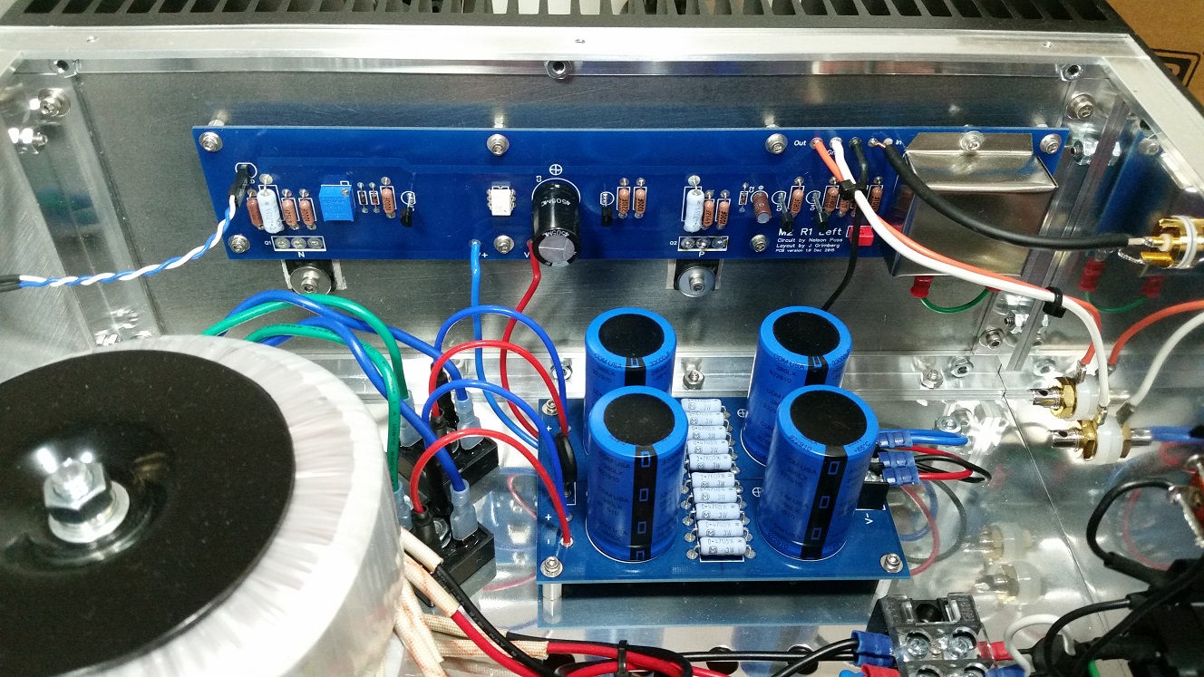

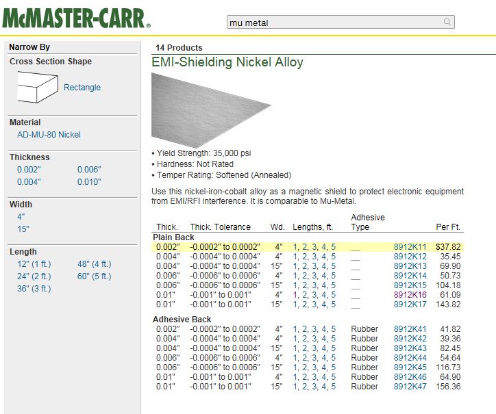

The shiny box at the rightmost end of the PCB is made of 0.010" Mu-Metal, purchased from McMaster-Carr. Why not use the material you already have?
I WILL use the Mu metal. The 3M tape is extra/easy and routinely employed by Edcor. Belt and suspenders approach, and reversible if it creates a problem.
Can you share your construction method for the shielding box? It looks really great. Sheet metal is a new medium for me.

I traced the flat box on the mu-metal sheet using a thin-tipped Sharpie. I cut the metal using metal snips. I then folded it using a piece of scrap 1/2" square aluminum profile. With a hammer and the scrap aluminum, I made the corners on the sides square. I decided to leave the top corners slightly rounded, but you can use the hammer and scrap to make them square also.
Nice result, grimberg.
Thank you! Back in February I posted other pictures of the build. You can see them at: http://www.diyaudio.com/forums/pass-labs/281520-official-m2-schematic-72.html#post4975080
Looks great. So does the mu metal box have to be grounded? And does it work?
Yes, it has to be grounded. In the picture you can see a short piece of green wire below the mu-metal box. It connects the box to the nearest screw holding the PCB to the standoff. And yes, the shield does work.

I have 18ft of the 3/4" 3M 1345 tape to use as a "flux band" on the Edcor.
I guesstimate ~6"/per transformer is more than enough. The tape has a peel-off liner, so sections are easy.
