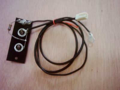

I think you must be refering to this setup where the soldering lug is connected to the power ground (0V), right?
