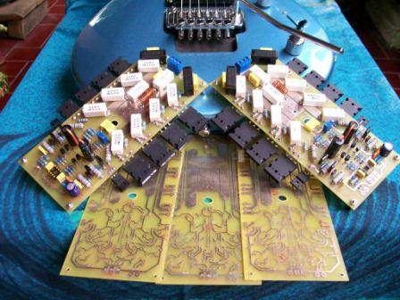

Here! Frest ! from soldering Department! i want to giv the name of my Lynx power Amplifier is LP5150 he he he, The maening LP Lynx Power 5150 is 5 Channel @ 150 watts! Yups! I want to build 5 channel for my Home Theatre power Amplifier and these will be my surround channel power amplifier
and than for center and front power not yet finish because i am waiting for 5Watt MOX resistor .my out put devise are
2SC 5200/2SA 1493 driver are : 2SC 4883/2SA1859 because i have ready stoch on hand!

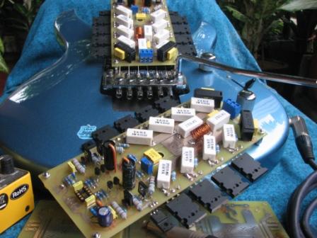

Hai Jan i am would likes to ask.. if i am used 5 watts Mox resistor for out transistor. Is sound significantly better ? i am should be waiting for long time for thats. my supplyer don't have stock any more!
here an other picture
Thank you Jan
regards!
Thank you Jan
regards!

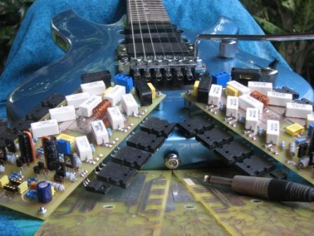

and here the other Picture of my modul LP 5150
all so i am waiting for OP AMP with High Slew Rate for all channell iam need that because my second favorite music is Jazz rock! i am likes the sound from electrick guitar with hard distortion effeck!
I have never tried the Mox, but I don't think it will sound significally better.... Those different types I have used, didn't make an difference.if i am used 5 watts Mox resistor for out transistor. Is sound significantly better

Nice looking amps you got there
