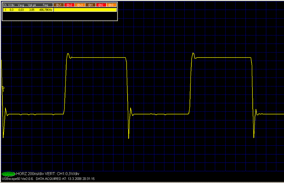

It's official, the Lynx doesn't like OPA134's
I took the plunge and ordered 4 OPA627's.
I swapped them in and everything is beautiful. Oscillations disappeared, and I was able to set the bias voltage.
Can someone explain however what is meant by "a slow op-amp" ?
I look at the spec sheets and see a gain-bandwidth product of 16Mhz for the OPA627 and 8Mhz for the OPA134. Does the higher number mean a slower op-amp ?
P.S. Power transistors going in tonight, I can't wait to hear these babies rock !

Glad you got your oscillation problems solved
However this makes it a bit more a mystery
A slow opamp is in the range of 1-2 MHz (in my terms), so solving the oscillation problem by using an even faster opamp is quite interesting......
I will some day try some other opamps with similar specs as the OPA134 to see if the problem is opamp based (OPA134) or has something to do with the bandwith of the used opamps.

Hi Jan,
OPA134 and 627 have different shape of open-loop amplitude response, and they differ in phase margin. Depending on application, the faster OPA627 is sometimes more stable than the slower OPA134. BUT, it really depends on the application. Especially in case of more complex feedback circuit, with active devices in the loop, the replacements have to be verified carefully.
Pavel

Thanks Pavel
I know the difference in shape of open-loop amplitude respons (thanks for posting the image of the OPA134 respons) , but what puzzels me most is that the OPA134 works perfectly on some LYNXs' and not on others.
Seems like a very carefully component selection is needed for running the LYNX with the OPA134. I must be lucky to have select the right components to my LYNX amps from the very beginning......
