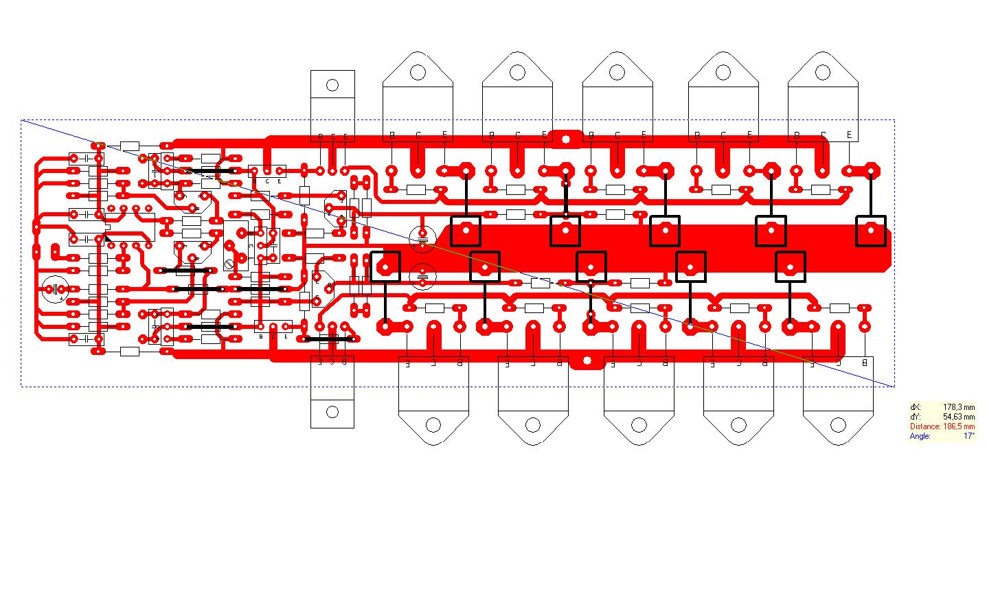

I think this time i outperformed my shelf i redesigned the lynx pcb to make it fit in a specific application
----- 10 outputs totaly
----- zobel is still located else where
----- and vbe will be attached with a piece of cable on one out trs
----- and of course due to cost limitations its done on a single layer pcb
havent check for any mistakes yet but for starts it looks very compact and symmetric
enjoy

put the speaker output just above the left most Emitter resistor. Thicken up the trace to the left and use a 6mm 2pin male spade. This gets the feedback right next to the output.
I would prefer the Zobel to be on the PCB.
To reduce the loop area of the power leads move the two power input pads as close as possible to speaker output and PCB Power Ground pad.

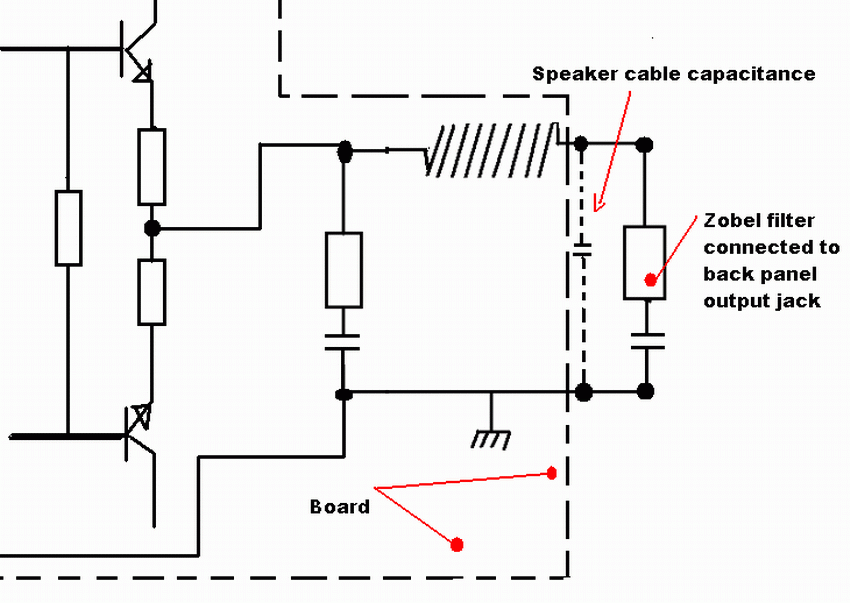

I will try to split the zobel in two parts...one to the speaker output... the back
panel output jack and another very near the output power emitters.
This way, a greek letter "P" filter will result.... will watch in the scope what happens this way.
Maybe will ressonate....because it is tune circuit.

uncle charly !!!! how are you ???? i am ok ...my German though is terible ( !!!!)
the idea to relocate zobel is very much related to star ground topology which is a technology that i ve seen that you dont use at least in your demo pcb
then the return to ground from the zobel is to be made with a seperate lead to starground .... not to the speaker lead ....
