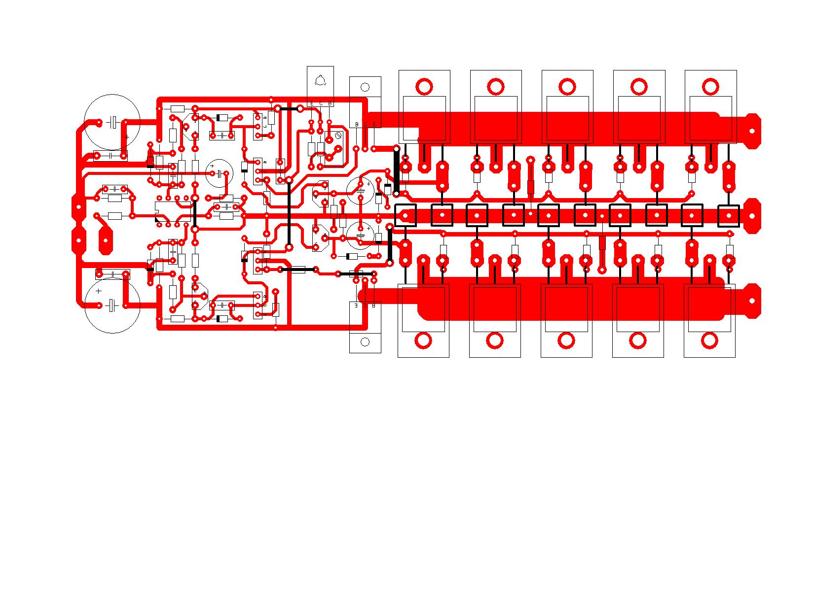

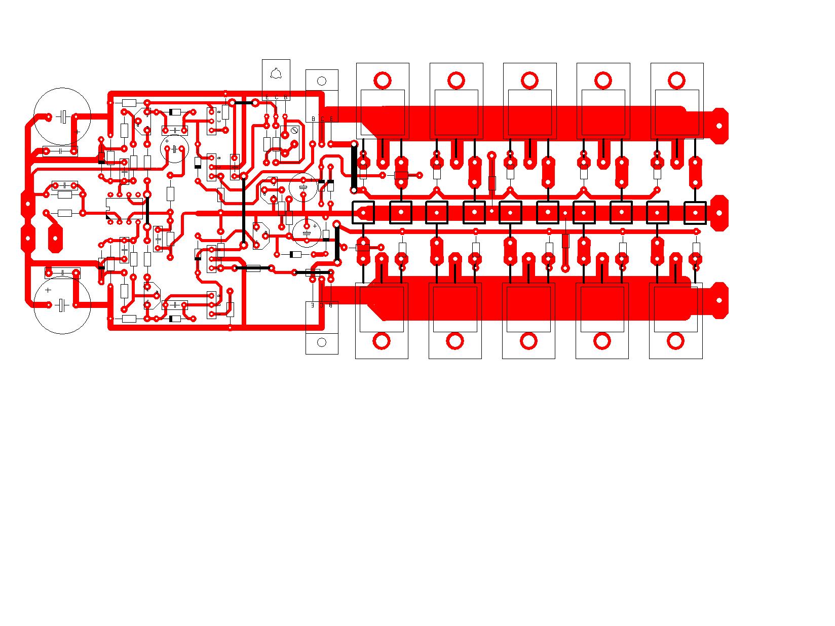

hello to everyone ....
been trying to e mail Jan but he is probably on vocation ....
seen the lynx many times before but never took a close look at it it till now
what i realy like about this amp regarding the design since i never listen to it is :
---- symmetric design
---- triple darligton topology
---- Vi limmiters
---- well guarded at every stage of the drivers
---- op amp driven
---- relatively easy to make
now the problems i face is 2
----one is the size of the pcb
---- second is the rail voltage ( it would be perfect for me if rails was max 70 volts or even better 80 )
so i designed a single sided pcb that fits my size and needs hopefully i didnt make any mistakes , in between i had pre drivers located in a way that can be fited on one small heatsink and then added one more pair of transistor outputs .
also kept zobel + inductor away from the pcb since i like it located in the output with separate return to ground
so ...till Jan gets back and share his opinion about higher rails here is a picture of the pcb
kind regards sakis
