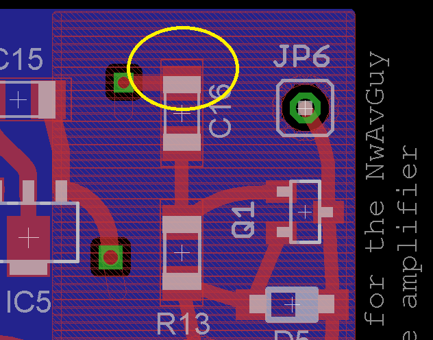

Well it looks like I am having a problem with the relay again. The amp played perfectly fine all day yesterday both on AC and battery power and this morning I was listening to some music and the relay started switching on and off rapidly. It does it both on battery and AC power. Any ideas?
I found something that may be causing the problem. When I was installing the booster board and ran the wire from JP6 to R8(O2 pcb) I had remove and reinstall R8 since I had it mounted tombstone style with the end I needed to attach JP6 to face down. When I desoldered R8 it looks like I may have damaged the trace that goes from R4 to R8(O2 pcb). I soldered in a small piece of wire to repair the trace and so far so good the amp is playing normally again. I'm keeping my fingers crossed that my fix will solve the problem but only time will tell.
Good, that might be it. Also lets try a couple of more things. I'm going to send you a replacement U2 chip for the O2 board. There have been some bad ones that have caused some strange O2 problems over the last couple of years. I'm also going to send a through-hole resistor. If the new U2 doesn't solve it, then try unsoldering that wire from R8 and instead solder it temporarily to one end of that resistor, then solder the other end of the resistor to the end of C16 closest to the edge of the board, as below. That changes the relay circuit from "no turn-off thump" to just "reduced turn-off thump". And if that fixes things it will provide some more info. Note: don't connect that wire to C16 though without the (47K to 100K) resistor in series to limit the current.
The relay circuit essentially gets told what to do by the O2's power management circuit. If the O2 PM circuit is have some fast transient troubles it can show up in the relay circuit.
I'll get that stuff in the mail today. 🙂
Fsatsil - also remember that while waiting for this stuff to arrive in the mail you can convert your unit back to an O2 by just unsoldering the 3 booster board wires, unplug it, and plug back in the 2 NJM4556A chips.
It is entirely possible for the U2 chip to have a problem that isn't showing up as a standard O2, but does show up when the relay is added. The relay circuit essentially can be "amplifying" an existing timing problem in that O2's PM circuit. Changing that U2 chip is a good place to start.
I've been listening to the amp for the last few hours and it has been working fine so hopefully my fix worked. I have a spare U2 chip and spare resistors so you don't have to mail them to me though I really do appreciate the offer🙂 If the relay starts to act up again I will try swapping in another Lm2903. While I had the amp apart I also drilled some holes in the front panel for the LEDs🙂

I've sent the chip and resistors anyway, one can never have too many O2 U2's on hand. 😀 Hopefully the trace repair will take care of it. I'll study the circuit a bit more tonight and see if I can spot anything I may have missed there too.
I tried adding a 100k resistor in series with the jp6 wire and it's working fine. I will let you know if the relay starts acting up again but hopefully the problem has been solved🙂. Thank you for your help ADGR😀

Looks like I may have removed a resistor that I shouldn't have between the V3.0 and V3.1 boards, which may be the cause of the relay issue Fsatsil ran into. If this turns out to be the case I'll send resistors to everyone with V3.1 boards. 🙂 The resistor goes where the photo shows, just in series with the long wire going out to the O2 board. None of this is in the audio path, just the relay control circuit.
I think I found my issue by looking at Fsatsil's pix. I didn't realize that R6 and R7 are not supposed to be soldered in a parallel position to C6, but perpendicular to C6. Guess I was moving too quickly. In the meantime, I ruined my 49600 by accidentally breaking off pin 2. I was grounding Pin 2 to test if the 49600 was working or not. After replacing U2 and swapping positions for R7 and R6 let's hope things are looking up for this project.

Good find! That would explain what you measured. Your inverting pin on IC1 essentially wound up floating, since the loop was broken and C5 would have blocked any DC feedback. So that would have just left the O2's input to the IC1 non-inverting pin, which would have pegged the output of IC1 up to the positive rail - what you measured.
