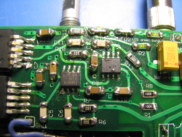

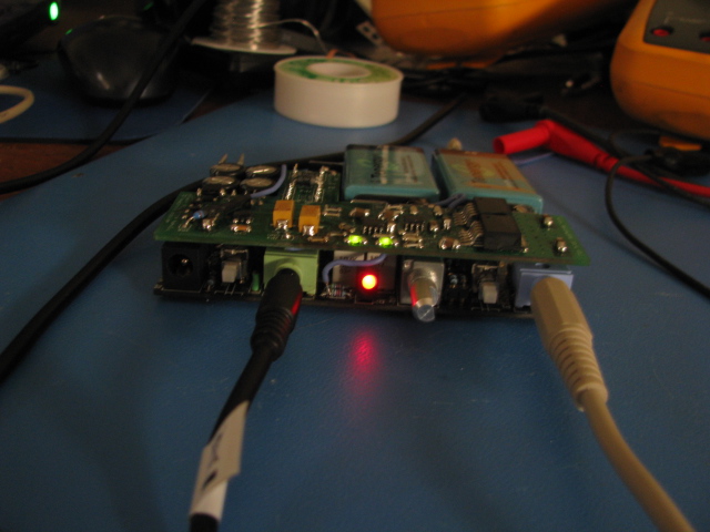

I built up another O2 booster board today with OPA827 chips this time and wanted to post some new stuff. 🙂
I'm also going to let the cat out of the bag about something. John at JDS labs has agreed to dScope test the O2 booster board too, along with the ODA, and is in-process with that right now as time permits on his end. We will finally have some dScope measurements for the O2 booster board! A huge thanks goes out to John for the testing.
I've decided to adopt a change that John has suggested, reducing the O2 booster board relay turn-on delay from 5 seconds to 3. The relay timing capacitor C16 has been 10uF which produced 5 seconds. Going forward I'm modifying the BOM (and will repost today at the project's Google Drive link) to make C16 just another one of the 2.2uF MLCC capacitors that are also used for chip decoupling, which results in 3.1 seconds of delay. This removes one part type from the BOM, which is always a good thing.
I agree with John that 5 seconds was long enough to get a bit annoying if you turn your O2 on and off a lot. In the fast-peak detect photos below 3 seconds of turn-on delay still results in zero transients out the headphone jack going from O2 power off to O2 power on (and relay on), then zero transients going from O2 on to O2 off (and relay off). Down from the 200mV peak transient I measured for the stock O2, or the 800mV on/off transient that NwAvGuy measured in his writeup - and called OK. 🙂

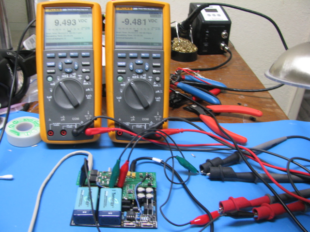

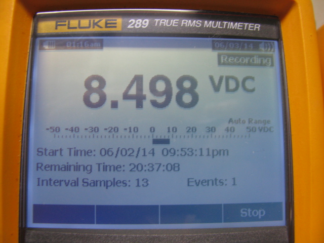

In the photos I have DMMs connected to the batteries and set up for 15 minute recording. I've fully charged the batteries and will just let it run until cutoff. If all works out I should be able to post a full discharge curve, in 15 minute intervals, for the O2 + O2 booster board with OPA827's. This is playing music was some fairly sensitive test headphones the whole time, around 50mVrms into 32 ohms. I've changed the relay sense resistor in series with that R6 jack to 1meg ohm to see if that lowers the battery cutoff voltage.

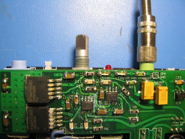

In the photos I posted a close-up of the OPA827 chips' orientation. With the OPA140s things are pretty easy because of the gold bar on the "pin 1" end. The OPA827's have a white dot near the "pin 1" end and the pin 1-4 side is beveled. Good luck seing that bevel though. I've tried. If you look at the chip right at the end with a strong light you can kinda see the bevel. It is better to go by the dot. Remember that the IC1 and IC3 op amps go in opposite directions! The dot on IC1 is towards IC2 (and marked on the silk screen). The dot on IC3 is toward the relay side of the board.

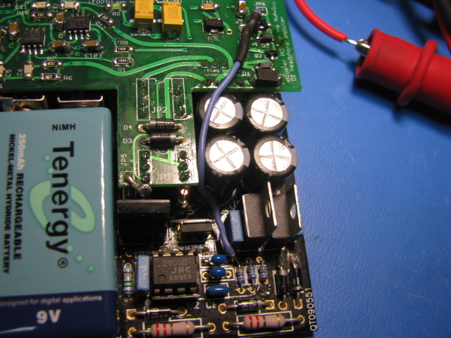

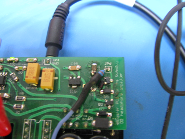

The photos also show how the JP5 hole is used. I ran a wire up from the bottom of the booster PC bosard, out the top of JP5, and tied it to pin 4 of the O2's U4 socket that is sticking up off the end of the booster board near JP5. This gives you a second connection to the O2's negative rail. The booster board already makes to connections to the O2's positive rail. Just lowers the connection impedance slightly.

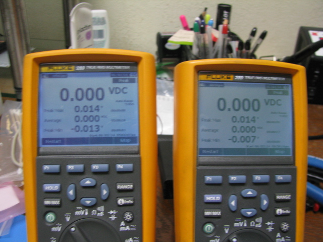

* The first photo shows the DC output offset with the OPA827 on first power-up of the new board running on batteries 26uV on one channel and 1uV on the other! These stayed stable over time. On AC with the full +/-12Vdc power rails the offset was about 20uV on each channel.
* The next photo shows the 2.2uF capacitor in the D16 position, along with a 1meg soldered in series with the JP6 wire. I'm done it exactly like Fsatsil did, which some heat shrink over the resistor end.
* Next shows the orientation of the OPA827 for IC1 with the while dot in the lower left corner of the chip in the photo. Unfortunately IC3 got drowned out in glare, but it goes the other way with the dot to the right.
* Next is the connection from JP5 to the nearby connection pin sticking up past the edge of the board that goes to pin 4 of the O2's U4 holes. This makes a second power connection to the O2's negative rail for lowest connection impedance. The O2 mosfet right there is the fully insulated one in the O2's BOM. If you use a different mosfet with a metal back, and you make this connection to JP5, make sure the jumper wire doesn't short to the mosfet.
Also, in this photo, notice the O2 PCB resistor wedged in between that blue capacitor at the bottom of the photo and the O2's batteies. That is the O2 R25, the bottom of which is also OK as a connection point for that relay sense wire (in place of connecting it to the top of the O2's R8).
* The next photo shows proper spacing between the parts at the front of the booster board (like the LEDs) and the edge of the board. Make sure your LEDs don't hang over the edge. Also make sure none of the solder joints go all the way to the edge to prevent any chance of shorting against the front panel.
* The next photo shows that relay sense wire routed a little neater around the O2's filter capacitors on its way to the top of the O2's R8.

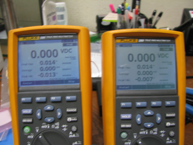

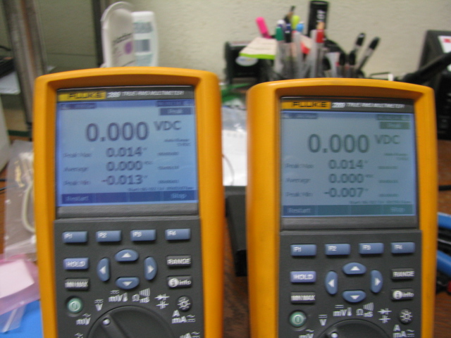

* The next three photos shows the fast-peak voltage readings on the headphone outputs. A pair of headphones is connected as load, otherwise just atmospheric noise would be picked up by high impedance meters during the open circuit when the relay cuts off. The first photo is O2 power off, the second is 4 seconds after power on (after the relay has turned on) , and the final is O2 power off. From the meters you can see there is just zero turn-on or turn-off transients - still - with the new reduced 3 second relay timing (down from the previous 5 seconds).

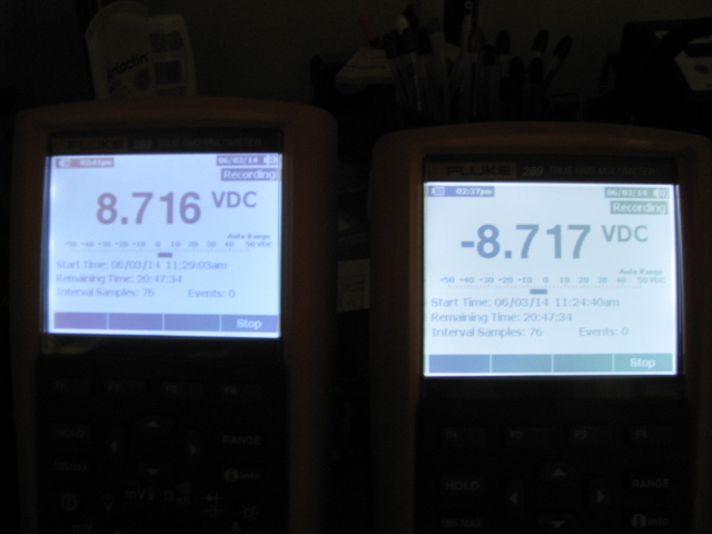

* The final photo shows the test setup to record the O2 battery voltages every 15 minutes until relay cutoff. At least that is the theory. 🙂 If it works and I can graph it with the Fluke software I'll post the results.

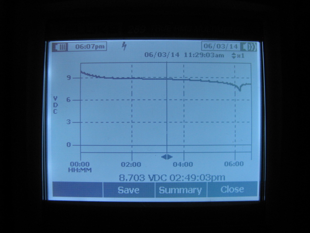

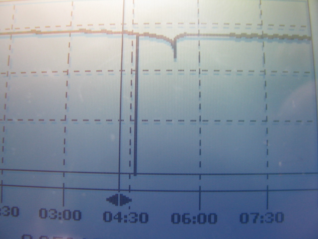

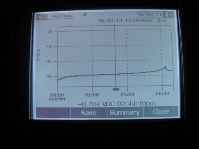

O2 + O2 Booster Board battery discharge curve
OK, it looks like the data logging for the battery voltage worked.
The first photo below shows the discharge curve, which is just about as typical as it gets for NiMH batteries. About 5 hours and 30 minutes all total. The big spike at 4hrs 30min is because I accidentally knocked the ground test lead off and didn't notice it for one 15 minute sample period.
The batteries start out at 9.6Vdc fresh off the charger. They are down to the nominal 8.4 volts after about 1hr 15 minutes, then stay relatively flat there for about 3 hours until about the 4 hour mark, when a slow dropoff starts.
That dropoff at the 5:15 mark to about 6.5Vdc tells the story. NiMH batteries stay relatively flat then suddenly just drop off the cliff like that when dead. Then it rebounds back to 8.2Vdc or so once the load is cut off. This is why the voltage has to be measured in that last 30 minutes or so before the O2's mosfets cut off. Measuring the battery voltage after cutoff will be rebounded back to a higher voltage.
This is why I have an O2 power management latch circuit board in the works to replace the O2's U2 chip. 😀 When that sudden battery dropoff happens the latch board will latch the O2's mosfets so they can't turn on again when the battery voltage rebounds. That prevents the "motorboating" sound some people get when their O2's cut off.
These voltage readings are with the OPA827 which pulls a couple of mA more than the OPA140. Using the OPA140 will give the best battery life. The greed LEDs also pull about 2.4mA with the 4.99K resistors in the BOM. You can increase those resistors to anything higher, like 10K, which will make the LEDs less bright but will save some battery power. Or remove the LEDs entirely - they are optional, but recommended for toubleshooting purposes. Even dim(er) they will tell you a lot about the O2's power rails.
I'm going to try the test again today with 5 minute samples rather than 15 minute to get some finer granularity on the curve.

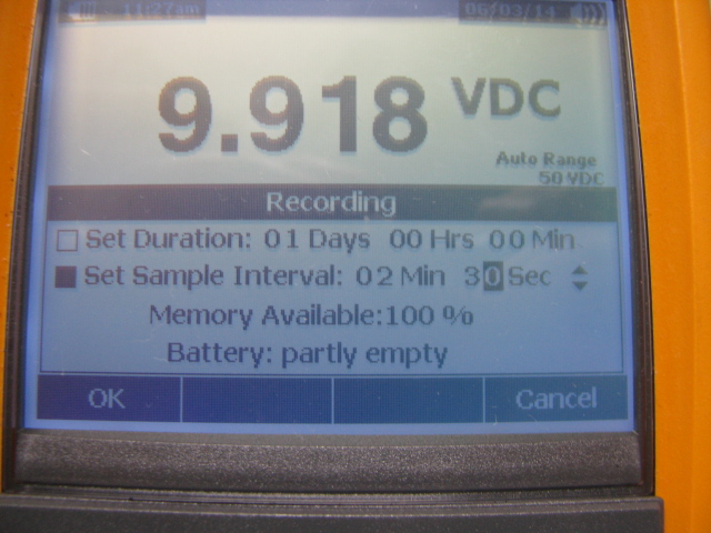

I'm running another test right now with 2.5 second sampling instead of 15 seconds. I've also increased the (green) LED current limiting resistors R2 & R3 to 10K which will cut the LED current draw in half. I'm thinking that I may make that a permanent BOM change, leaving the 4.99K in as an alternate. The LEDs are still plenty bright at 10K being the right angle variety.

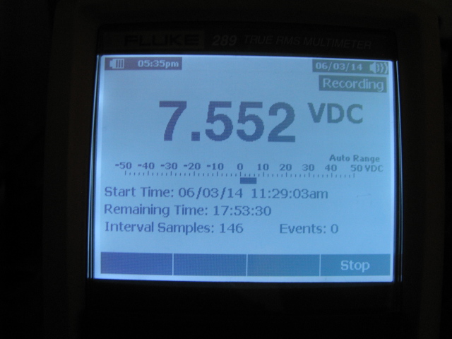

I ran another battery life test this time using a pair of very sensitive Sennheiser Ampheriors(18ohm 120db/1v) and the run time was right around 5hrs with a shut down voltage of 7.42v with a jp6 resistor of 100k. Do you think it's worth changing the JP6 resistor from 100k to 1meg?

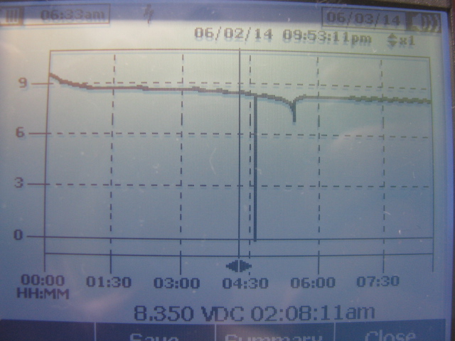

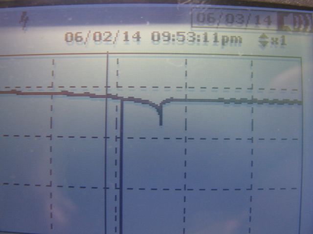

Probably not worth changing that JP6 series resistor. Below are the results of the second run I did yesterday with 2.5 minutes sampling. The result was also about 7.4Vdc cutoff with the 1 meg resistor. 7.4Vdc is OK. The various things I've read and some email exchanged with the manufacturer say the discharge should never go below 7.0Vdc to prevent damage to the battery. It looks like NwAvGuy has his set at somewhere around 6.5Vdc which was too low. Your batteries will last longer at the 7.4Vdc cutoff.
But it may be worth changing R2 & R3 to 10K from the 4.99K. The next to last photo below shows the brightness with 10K. That will reduce the battery current draw a little. This test run went for about 6 hours and 20 minutes. Some amount of that extra runtime was likely due to the smaller LED current. I also had different music playing which probably had an effect. Even the music involved can effect run time if the average level is higher and/or has more bass notes.
Photos below:
* The first two are 76 samples along, so 2.5min * 76 = 190 min = 3.2 hours. Stil 8.7Vdc! The discharge voltage is very symmetrical between the two batteries at this point.
* The next two are 146 samples along, which is 146 * 2.5 min = 365 min = 6.0 hours. As luck would have it the cutoff was just about 20 minutes after I took these pictures. I could easily tell when the cutoff occurred by when the two green LEDs went out. 🙂
* The next two are plots of the points for each battery. Notice how the battery voltage rebounds immediately after the load is cut off. That is what sometimes confuses the O2's power management circuit into thinking the batteries are charged up again and turning the O2 mosfets back on, resulting in a "motorboating" sound. If anyone gets that the best solution is to try fresh batteries, or try the O2 power management latch PC board I have in the works.
* The next photo shows the brightness level of the green LEDs with the 4.99K SMD resistors R2 and R3 replaced with 10K. Still plenty bright, IMHO.
* The final photo shows the starting conditions with the batteries fully charged at 9.92Vdc.
