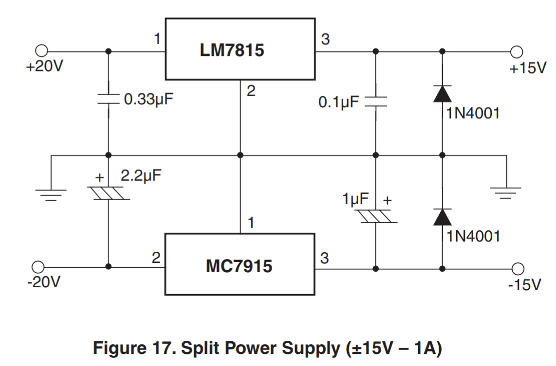

Thanks to CHiroshi, I have a booster board on the way!!!
I'm excited about taking advantage of the extra power and I'm thinking about doing the 15Vrms mod along with relocating voltage regulators to the backplate for heatsinking. The heatsinking mod is discussed in agdr's o2 mod thread.
He mentions that the bypass/decoupling capacitors & diode should be mounted directly to the regulators. I've attached the diagram I believe he refers to. I have basic soldering skills, but I dont know enough about electronics to know which caps to order from digikey. agdr says that he uses MLCC caps,but the schematic shows two polarized caps and two non polarized caps.
Are there specific caps that I should be using? After I do this mod are there any components on the o2 that need to be shorted or removed?

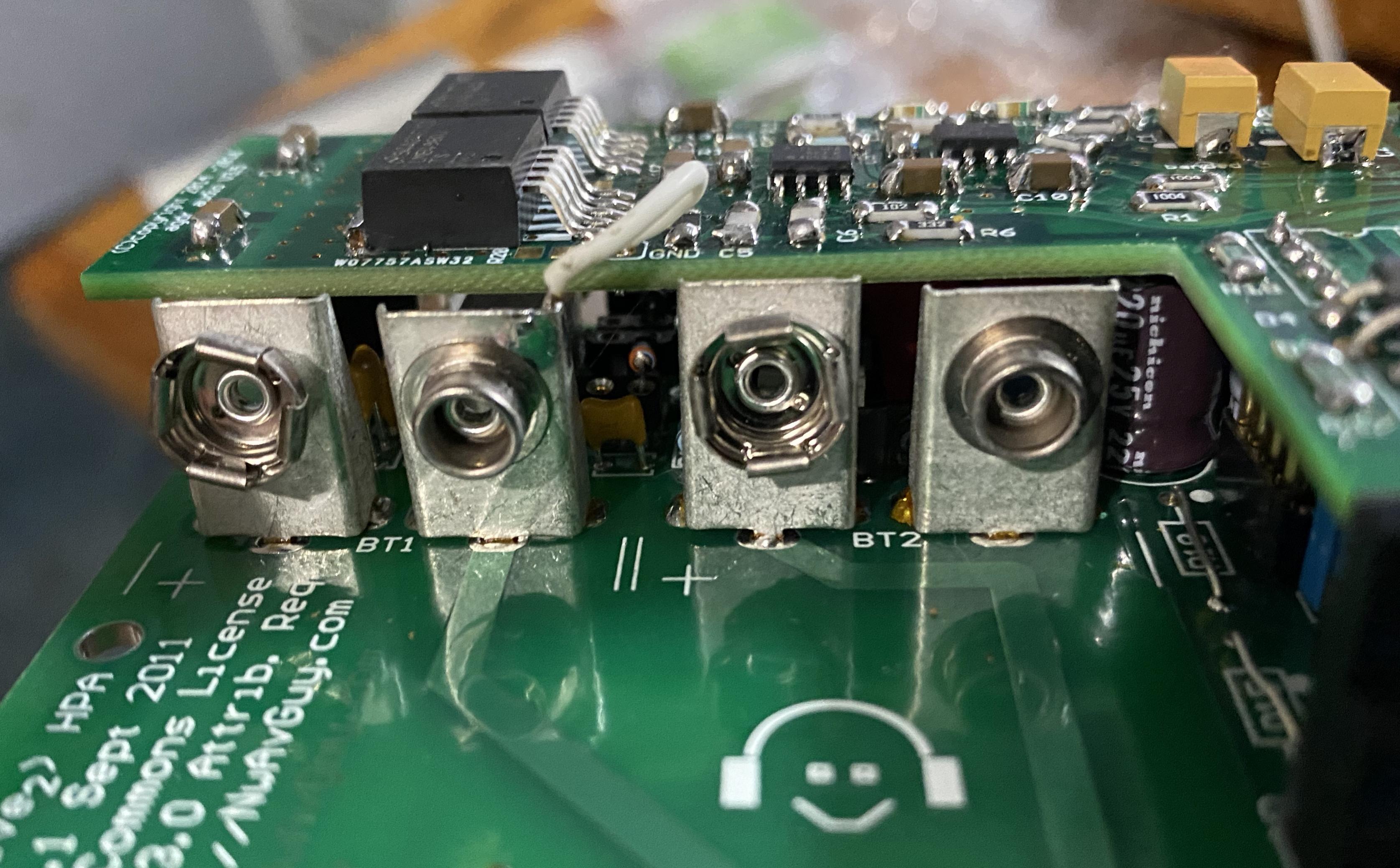

I am undoing a mod agdr did on my O2- I am reverting back to the original gain structure (reverting R7,R3,R14, R20, C12 and C11 back to the original values, thereby removing voltage divider I had agdr install). Will end up with 1x and 3x which should work well with my source and headphones (45Ω Ety ER4XR and 250Ω Beyer Amiron. Also replacing the pwr supply filter caps per the recommendation on his website.
I am hoping to do this without removing the Booster Board. Since I don't need battery power, I will remove the two battery terminals closest to the edge of the board to gain access. I'm hoping this will give me sufficient access to remove R19 and R23 (which fortunately were socketed when the original mods were done.
My concern is that I may have to get the booster board out of the way completely to insert the gain set R's and I'm wondering how to safely do that if necessary. Can the white wire there be soldered to another terminal (I think that wire will reach the terminal on the right)?
Wish agdr was still around. My eyes ain't what they used to be and this is a densely packed PCB so I am depending on a helping hands/magnifier to get this done. Pwr supply filter caps are easy to get at out in the open but the parts under the boosterboard could get tricky. Any advice or tips welcome.
