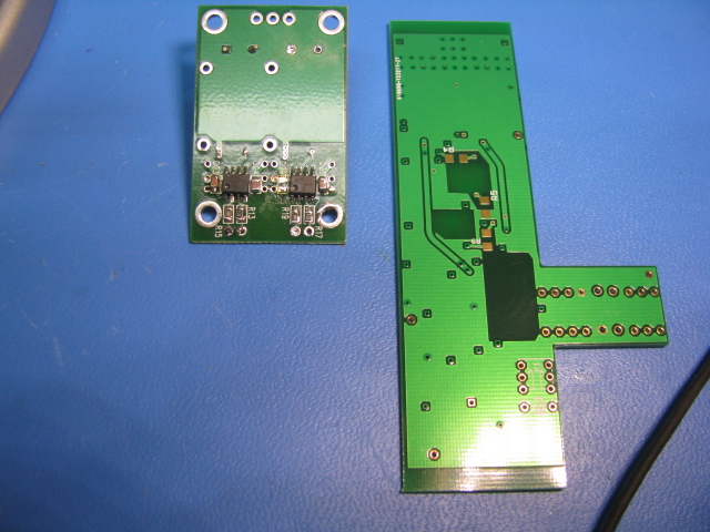

Also below are some interesting comparison photos between the LME49600 foil heatsink area on the O2 Booster Board and the previous version (a couple of years ago) of OPC's "Wire" board using a similar side-by-side arrangement for 2 LME49600s. The booster board has about 25% less foil on the top, but about 2x to 3x more on the bottom with a bunch of thermal vias. I'll have to admit I've never tried cranking a "Wire" board up past 4Vrms into 32R, which it should be able to do from a power supply standpoint since the Wire runs on +/-15Vdc vs. the +/-12Vdc with the standard O2 headamp. Given the foil areas I would suspect the Wire would experience the same thermal overheating above 3 or 4Vrms or so into 32R with 89dB/mW or less sensitivity headphones given the similar foil areas. Anyone with a Wire out there tried it? 🙂
I'm open to suggestions here, too! 🙂 One thing I've already done on the layout is add longer front foil past the front of the LME49600 chips, then added another row of thermal vias to transfer more heat ot he rear foil Might be worth adding thermal vias on the LME49600 pads themselves like OPC has done with his new LPUHP board. That certain did draw the iron heat away well while soldering! If I poinder it long enough there may even be a way to make a thermal connection between that small strip of front foil above the LME49600 tabs and the top of the case with a small block of metal clamped down.

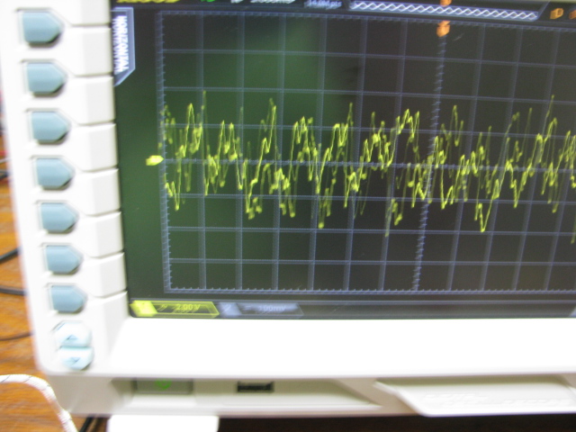

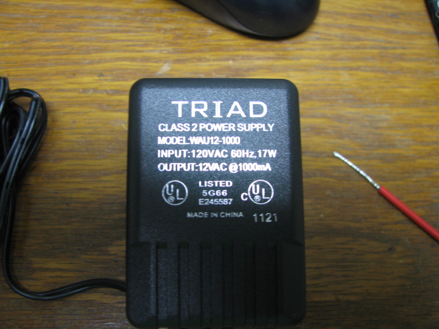

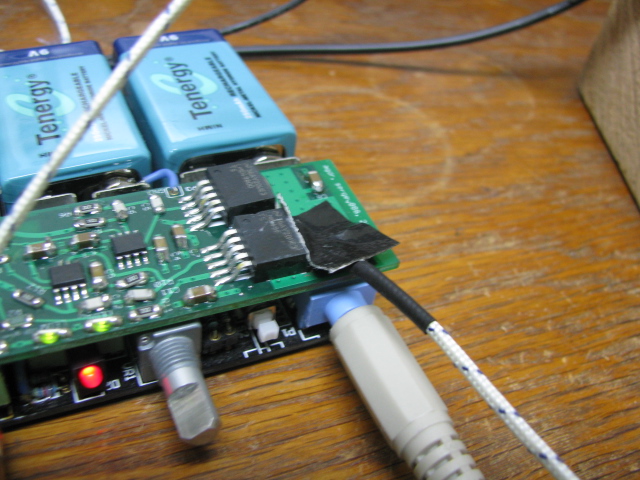

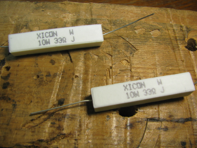

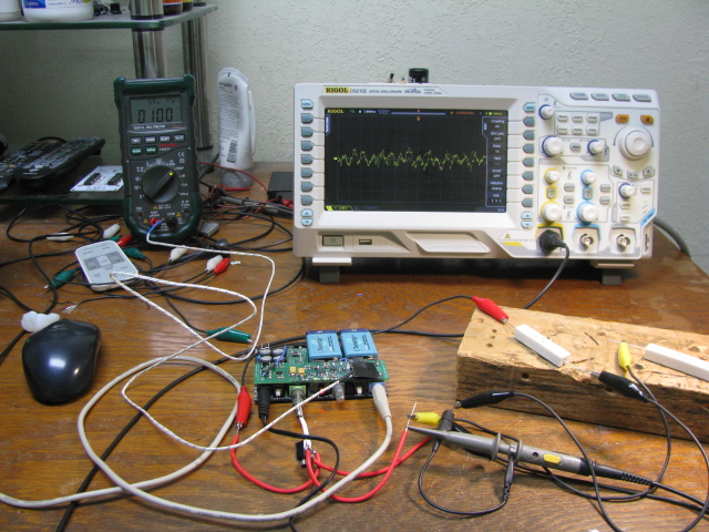

OK, I took off early this afternoon and set up a power dissipation test rig for the O2 Booster Board with 33R loads on each channel. I believe that I've found the problem: music vs. testing with pure sine waves. NwAvGuy himself mentioned this in his blog, that if using pure sine waves the O2 headamp should only be run for 10 minutes or less at full power. The same will apply to the O2 booster board + O2 headamp combination.
In the test setup below I first used music with 4Vpeaks (2.8Vrms), then ran it all the way up to 7V peaks(5Vrms), the maximum before the O2 and the 12Vac power adaptor clip. The result: no thermal power dissipation problems at all with either the booster board or the O2's voltage regulators. I did not try the tests with pure sine waves instead of music. The power dissipation with sine waves would typically be 2x to 3x more and would likely cook both the booster board and O2's voltage regulators over time. I'll bet the dScope puts out pure sine waves. dScope or Audio Precision testing should probably be limited to 10 minutes at a whack, or preferably even just 5 minutes, before letting everything cool down.
* The first photo is the transformer I used with the testing, the WAU12-1000 12Vac 1Amp transformer. If you use a 16Vac transformer it will keep the O2's voltage regulators out of dropout at maximum load current but will put 4 additional volts across the O2's voltage regulators. Which in turn means your maximum output power will be more like 1Vrms to keep the O2's voltage regulator power dissipation about the same as with the 12Vac transformer.
* Next two are the load resistors used, 33R at 10W, and the test setup. The green meter has a type K thermocouple attached and taped down to the top of one of the LM49600s.

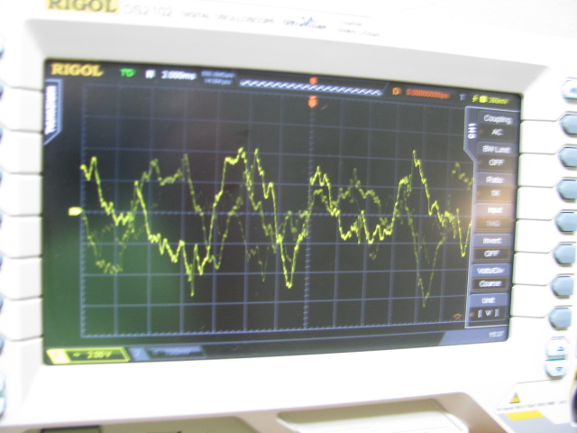

* Next is the scope shot showing 4Vpeak. Hard to see - sorry about the blur - but that is 2.00V/div in the lower left corner. The probe and multiplier menu on the screen are set up for 1X.

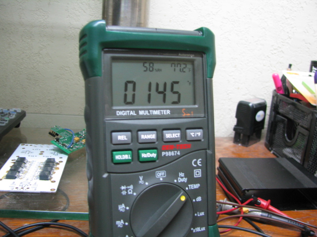

* Next photo shows the steady state temperature on top of the LME49600, 109F. No problem. Ambient is around 77F.

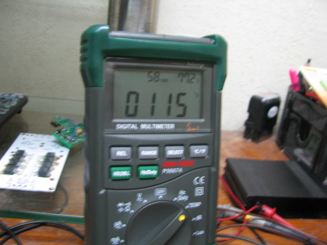

* Next two photos shows the thermocouple moved to the top foil, where the solder joint with the LME49600 is located: 115F. Also OK.

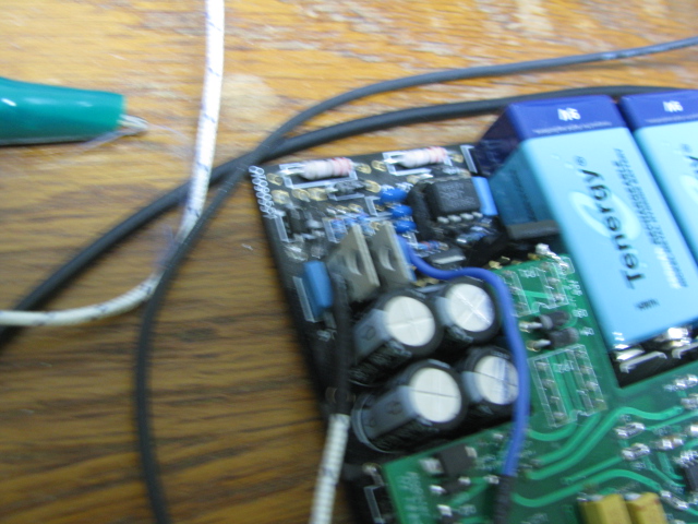

* Next two photos are the O2 voltage regulator at 145F. Back in 2011 I measured the heatsink of one of my O2 voltage regulators at 165 driving a 16R load and exchanged some email with NwAvGuy about it. He came back saying he considered anything under 200F OK, working back from the junction temperature. Definitely wouldn't want to touch that with your finger though!
* Next two photos shows the output level now cranked up to 7Vpeak. You can see it from that one peak on the bottom half that is just barely touching 7V. I tried running it up higher but clipping became evidient, as it should since that is all the O2 gain stage can put out. The net result is 125F on the top booster board heat sink foil, which is still OK.

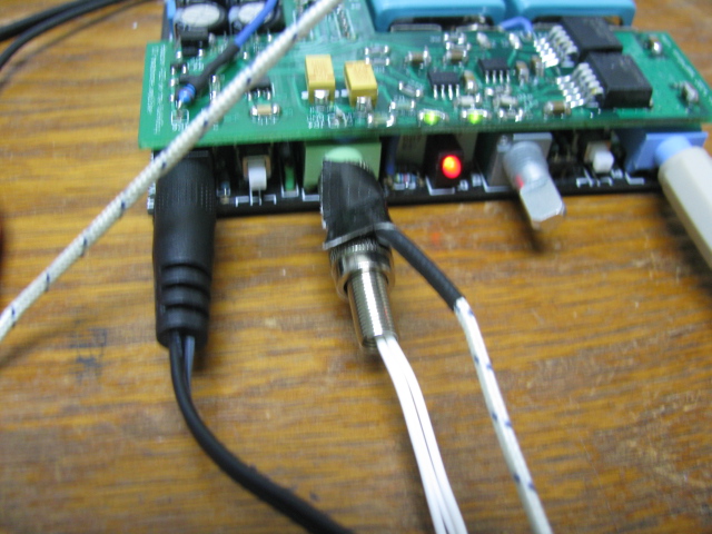

JDS Labs had noted in their testing that the output jack gets warm. That is correct! Remember that the thermal vias around the LME49600 chip transfers the heat to the booster board bottom foil. The bottom foil goes the whole length of the board including right over the output jack.
I put the thermocouple on the metal output plug to quantify the temperature rise. The photo shows about 88F vs. 78F ambient, so about 10 degrees F with a 7Vpeak output signal into the 33R loads, the maximum output signal for the O2 + booster board combo. But remember this is with real music, not sine waves. If the dScope was putting out pure sine waves I wouldn't be surprised if that output jack and plug got downright hot during the dScope testing. Thanks again to JDS for noting that!! Anyone doing pure sine wave testing on the booster will be best off letting it cool down after 5 or 10 minutes. But with actually music everything is fine long term, as all these steady-state temperature readings show.

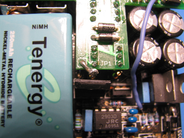

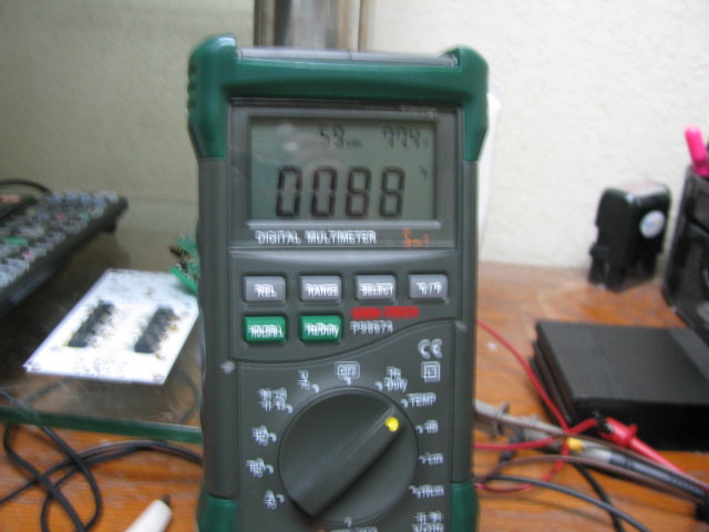

My booster board has developed a small turn on/off sound like a click through the right channel when the relay turns on and off. Any idea what would cause this? It has never done this before it was always completely silent when I turned it on or off.
Measure your DC output voltage again on both channels with the input cable disconnected (inputs grounded). DC on the output can cause that. Are you using the OAP140 chips? Remember that you have to wait that 5 seconds for the relay before the output voltage shows up - lol, I forget about that myself when testing. 🙂
Also are both of your green LEDs on and about the same brightness? Unbalanced power rail voltages can do that too, although it would usually affect both channels.
I've probably forgotten to post along the way that part of the super-silent turn on and turn off is having that DC output offset voltage so low, along with the relay.
This is so strange it happened all of a sudden. I checked the DC offset a week or two ago and it was so low my meter couldn't read it and now I have a dc offset of around 50mv on one channel! My batteries are both reading 9.37v so it's not unbalanced rails and both LEDs are on and the same brightness. I haven't changed a thing since i tested the dc offset a week or two ago and the amp has been working perfectly up until yesterday when it started making the turn on/off noise.
Ok I swapped out the opa140s for a different pair of opamps and I still have the offset on one channel so I thinking it is most likely one of the buffers. I have one spare lme49600 I can try but first I need to figure out which one on the board is the bad one. Which is the right and which is the left buffer?
IC2, the one closest to the batteries, and IC1 are the right channel.
I would recommend going through the procedure in post #150 at this point for IC2 and IC1, which breaks the loop between the buffer and op amp to test each individually. 50mV is still within the normal input offset voltage for the buffer (it can go up to 60mV) with its input grounded. I'm guessing that IC1 is still not doing its thing for some reason. The procedure in post #150 will measure that too, the output of IC1 with the loop broken. But first, measure one more thing. Measure what you get on either side of R1 to ground. It should be zero, unless IC1 is shorted inside, or 50mV is coming up from the O2 PC board.
Ok I measured from R1 to ground and I'm getting about 3mv on the side if the resistor closest to the buffers and 0 on the other side. I also tried switching the opamps from left to right and nothing changed so It looks like the opamp is not bad. Would you reccomend I swap out the buffer next or should I still go through the procedure in post #150? Thanks for all your help!

Well I followed the procedure in post #150 and I've traced the problem to the O2 board. Here's the measurements I got
Pin 2 of IC1 grounded
12mv on pin4 ic2
Ic1 pin6 output -6.15v
Ic1 pin3 input -65mv
So I pulled the buffer board and installed the njm4556 opamps back in u3/u4 and I am measuring about 65mv dc from pin3 of U3 to ground. I don't get any dc on pin 3 of U4 so it's only the right channel that's effected. I've checked the solder joints and they all look good so the only thing I can think of is that the socket is bad. Any other ideas?
12mv on pin4 ic2
Well it looks like I'm gonna have to build a new O2 I buggered up the board trying to remove the u3 socket.
I had something similar happen once and the cause turned out to be extremely odd. I was reading about 100mV on one channel after just installing a booster board on an O2 board that had been sitting on a shelf for awhile. I traced it down to the 100mV coming up from the O2 board also. At first that just makes no sense given the only place that input line goes on the O2 board is a 40.2K resistor to ground and the 2.2uF coupling capacitor. How could voltage get on that line?
After inspecting the board with a magnifying glass I saw a tiny bit of blueish corrosion around two of the part leads and a thin film of something transparent in one small spot on the board. Turns out I had the O2 board sitting right next to an open can of "damp rid" moisture absorber. Over the months some of that stuff had landed on the board and it turns out the stuff is conductive. It formed a high resistance path from one of the power supply lines to the the input line of the output op amp. I cleaned the board off with isopropyl alcohol and all was fixed. 🙂 You might give that a try. The booster board chips are FET input so the gate impedance is fairly high, that 40.2K resistor on the booster board.
I'm sorry to hear about that! You might be able to salvage it. The booster board only needs two of the signals out of all the 8 U3 pins IF you connect JP5 to the pin near it hanging off the end of the booster PCB, as in the photo below. That lets the booster get V+ and V- from U4.
Then you just need to wire what was U3 pin 3 on the booster board to the end of R12 on the O2 closest to the O2 red led. Then wire what was U3 pin 1 to to the end of the O2's R11 that is closest to U3.
