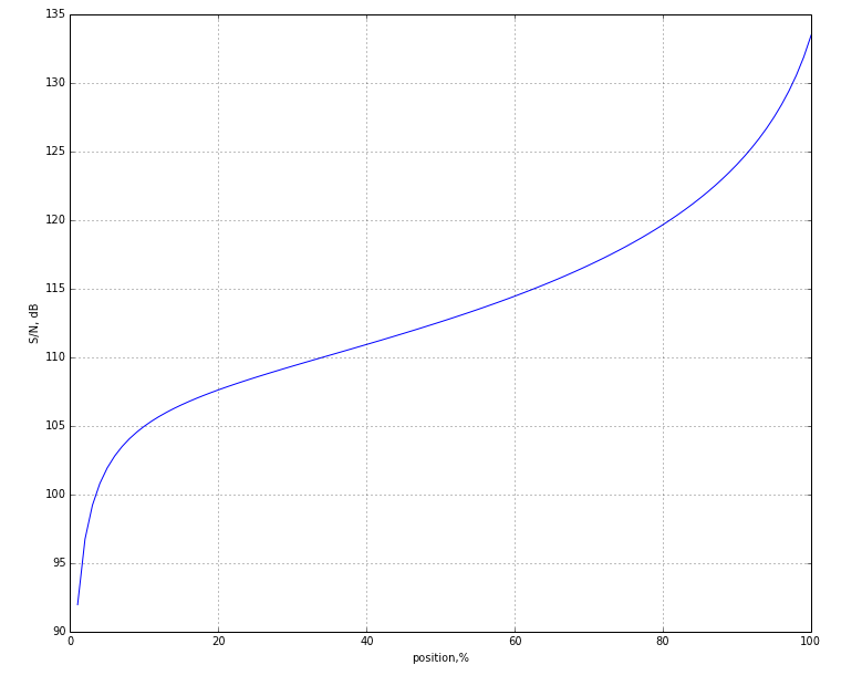

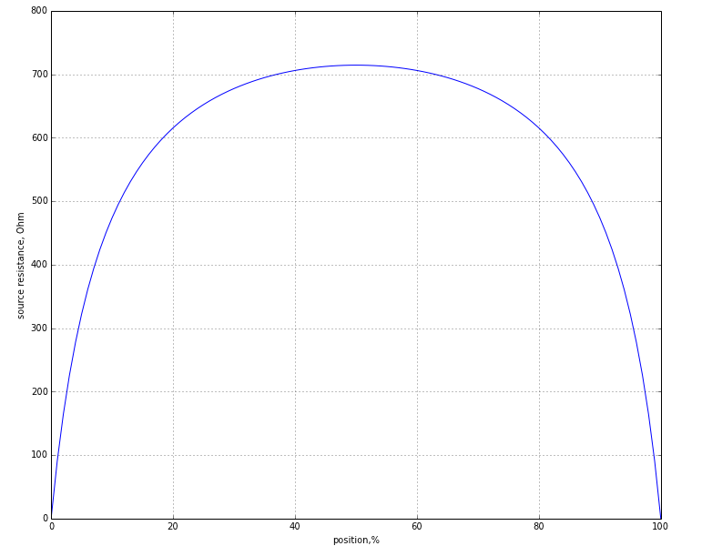

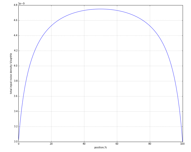

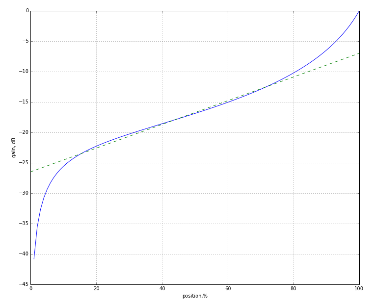

I mentioned earlier that it is possible to use linear potentiometer and achieve some sort of emulation of exponential characteristic. Here is some estimation of gain vs position, input noise using LM4562 based buffer after the pot, plus S/N graph assuming signal is 2Vrms (only for the buffer+pot). I also made a "source resistance" plot this case to see what would be maximum DC offset caused by input bias current.
On the first graph the green reference lile is an exponential function with look straight on semilog plot.

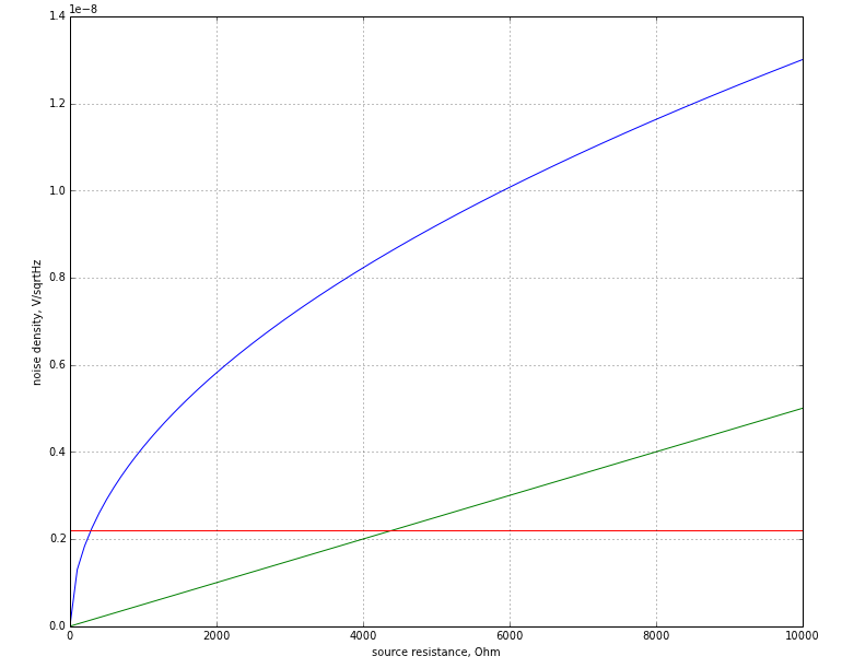

above 2K source resistance, the current noise of OPA209 will be above the noise of the source resistance itself.
I can not agree with that. Thermal noise of 2.5k resistor, for instance, will be around 6.5nv/sqrtHz, voltage noise of OPA209 is 2.2nV/sqrtHz and the current noise over the impedance in this case will be around 1.25nV/sqrtHz.
Current noise just can not dominate in this case even if it would be 5 times higher.
Here is a plot of noises of the OPA209 vs thermal noise of the source.
Blue - thermal noise, green - input current noise * source resistance, red - voltage noise.
The other thing that spec does not state what fraction of the current noise is corelated for the inputs.
