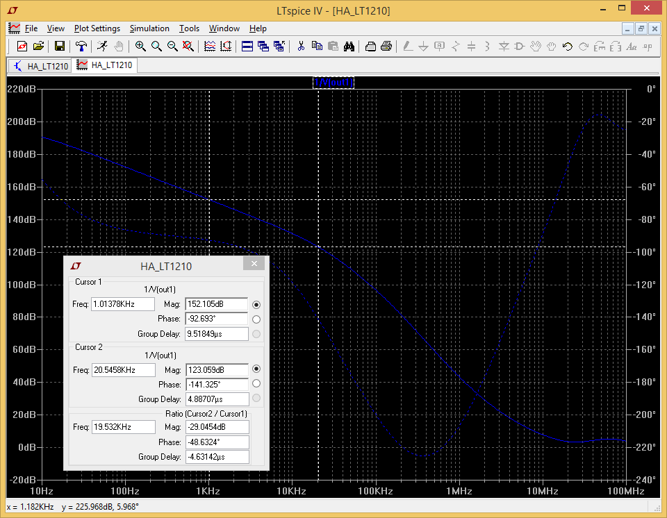

One of the main reasons why LME49990 has better THD performance is that it has one of the highest GBW among "audio" chips, as a result you have a lot of feedback depth around an output stage or buffer. The other way of getting this is using the output buffer that has gain itself. A current feedback amplifier with sufficient output current can be a good option. In this case you get an additional freedom in choosing the front end part.
Beside that, THD graphs in datasheets are usually made for 2k load or something like that, while LME49600 is somewhat higher impedance load. While output of an opamp remains in class A, it is usually more linear. I suspect this will be true for your design.

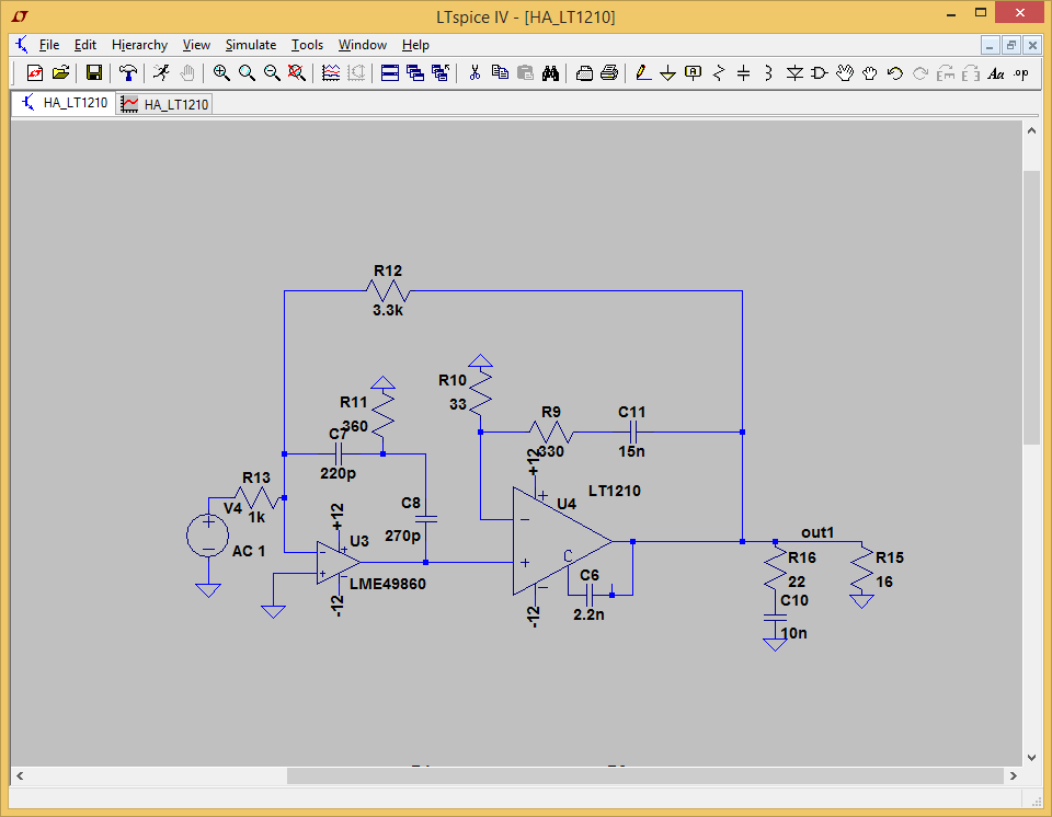

I think LT1206 or LT1210 can be an interesting alternative. They both have TO- 220 variant, so it is not a problem to solder. It also makes possible to make excellent heatsinking with pretty simple means. LT1210 has heaps of output current if needed. I even had a composite amp based on one working in HF channel in my multiamp. I do not remember it clipping 🙂
Here is one of possible variants, how it may look like and plot which shows total feedback depth (in two loops together) around the output stage. I'm pretty sure being properly assembled it will have very low level of distortion.
