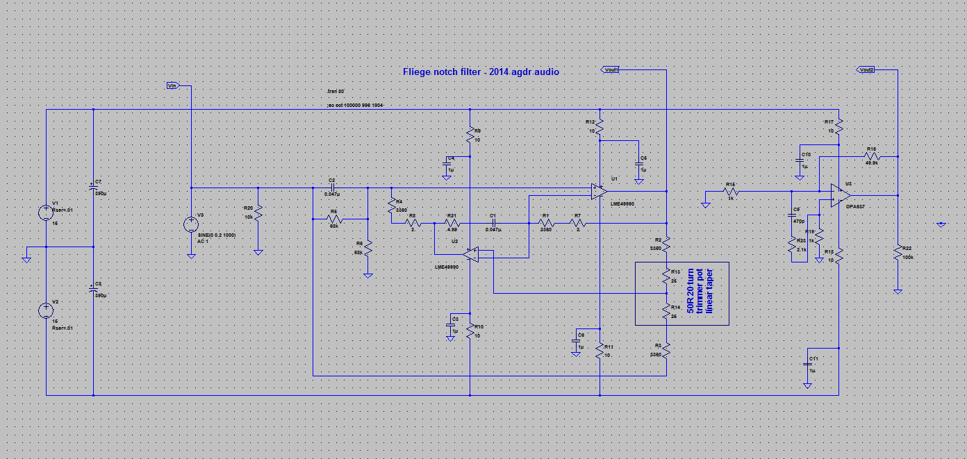

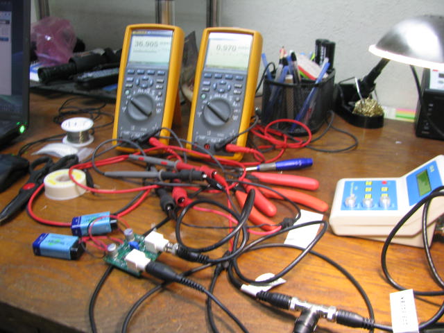

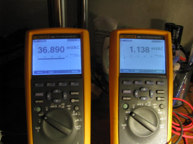

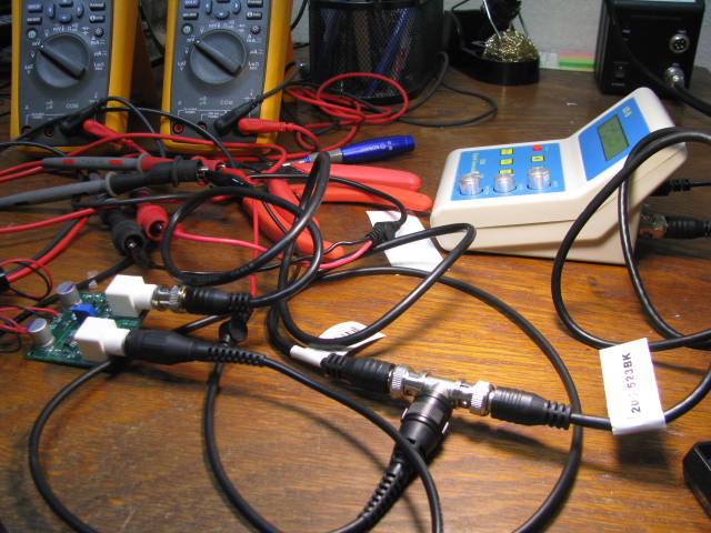

Fliege notch filter series resistor works after all..
Turns out I was wrong in my post above about adding a small series resistance to the center 0.047uF cap affecting the filter's Q and notch depth. I just handn't turned the frequency adjust pot far enough yet to fully null it. 😱 Took about 5 turns from the center on the 20 turn pot, which was centered when I installed it. Also turned out that only 4.99 ohms is needed to isolate that 0.047uF cap from the op amp output, not 20 ohms. So the other isolation method above, the BUF634 chip added to the inner op amp, really isn't needed since this simple resistor trick does the job.
The LT Spice simulation comes within the ballpark of matching the real-word results, if the 27R resistors are changed to 2R to shift the frequency to match the pot turn. The simulation gives around 2.4mV out with 200mV in at the notch frequency, or 20log(2.4/200) = -38dB. The real world results shown on the DMMs below are 0.97mV out with 37mV in, or -31.6dB. The pre-amp (not yet populated) on the Fliege notch filter board is set for +33dB. So the net result would be to restore the fundamental to its original level, but boost all the device harmonics by 33dB, useful for looking at the harmonics on a scope's FFT.

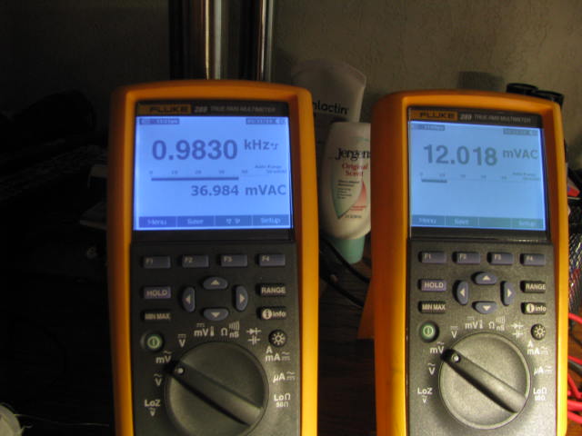

* The first two photos show the test setup. I'm using DMMs instead of the scope to get more accurate absolute values.

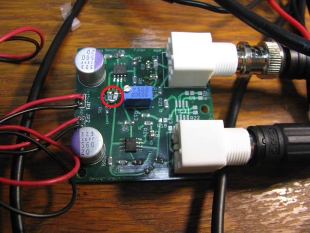

* The next photo shows the series resistor modification in the red circle. Just a 4.99R 1206 resistor put in series with the 0.047uF 1206 capacitor. The resistor isolates the capacitive load from the output of the LME49990 and restores the waveshape. The other LME49990 doesn't have that problem in the circuit. The board now has the proper filter caps on the power supply and BNCs after another bunch of parts from Mouser.

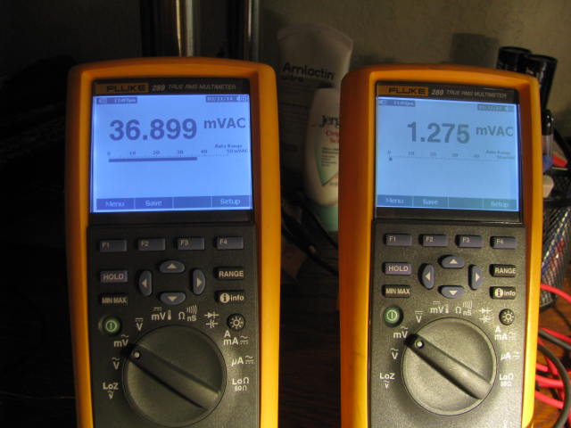

* The next two photos show in the input signal from the generator, 37mV, and the output from the Fliege notch filter, 0.97mV = -31.6dB. The pot is adjusted for maximum null, about 5 turns from center with the 2 27R frequency set resistors in place. The second photos shows the frequency out of the generator, 999.96Hz.

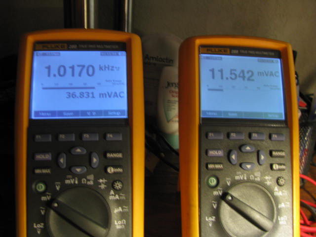

* The next two photos are a test of notch wall width and symmetry. These are +/-1Hz from the 1kHz (1001 Hz and 999Hz).
* The final two photos are the same thing, a notch width and symmetry test, but I'm shooting for -10dB here, up from the notch bottom's -31.6dB. This happened at +/-17Hz from the 1kHz Fc, as the meters show. 11.5mV on one side of the notch wall and 12.0mV on the other, reasonably symmetrical.
* The schematic has the 4.99 isolation resistor now in series with the circuit's middle 0.047uF cap.

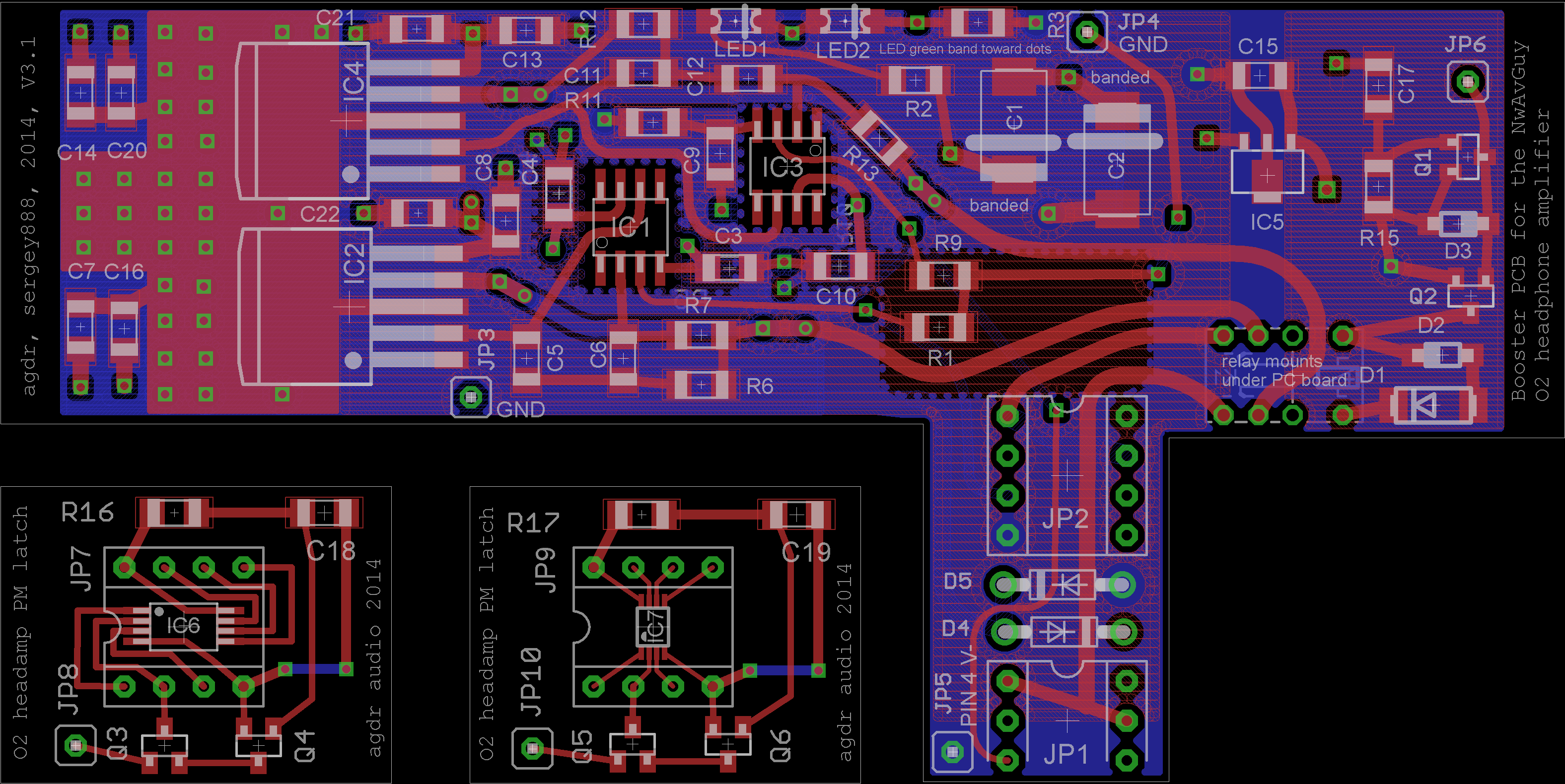

Hi Agdr, can you please confirm a couple of things for the V3 board,
-Is the positive end of C16 closest to the edge of board?
-When running the power management circuit in the stock config with R13 and no R14 does it need the jumper cable, or is that only for the modified version with no R13 and a diode across R14?

That is correct, the banded end goes closest to the board edge. Any other type of capacitor would have the band on the negative end, but on those SMD tantalums the banded end is positive. I just noticed in looking at the layout that I didn't put the additional text about the banded end on that capacitor, just the band on the symbol. I'll add that on the next board run in a few weeks.
That is right, no cable needed in that case. You will still get a small amount of turn-off thump though, although I measured it in one of the posts above to be greatly reduced. Removing R13, adding the zener for R14 and adding the cable will give you zero turn off thumps.

One bit of constructive criticism, the orientation of the diodes, LED's and tants isn't that clear so i had to refer to your pictures to verify i had them the right way around. Rather than the little dots can you make them a vertical line under each component so its more obvious. Would also be worth noting the position of the relay on the bottom of the board, only reason i knew that was from seeing a picture you had posted previously, most people would assume it goes topside. Or does it matter?
