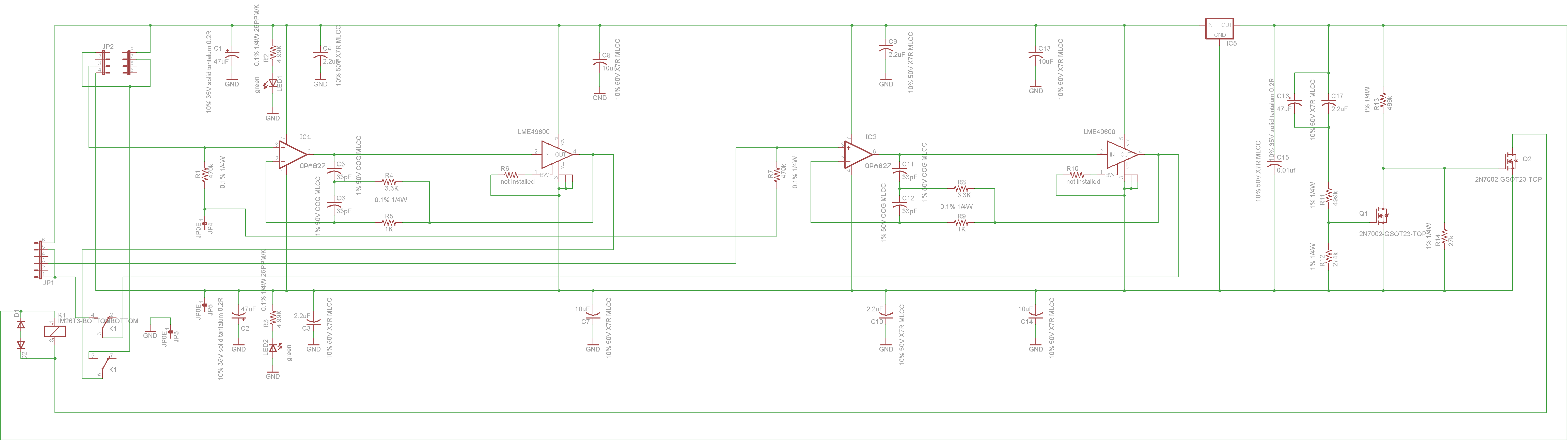

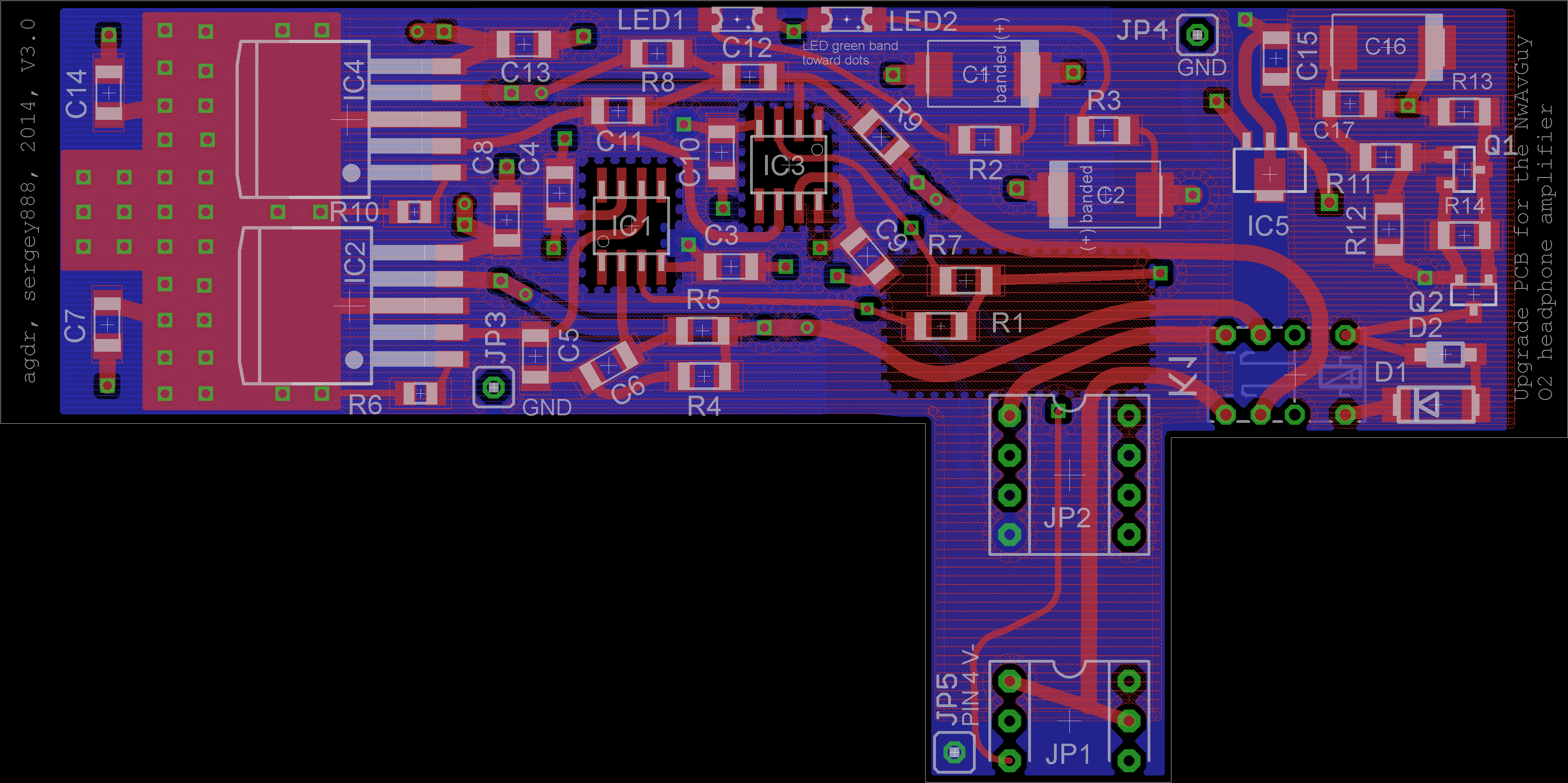

Booster board component identification diagram & R7/R10
I've put together the marked-up layout diagram below that helps show which text part labels go with which parts on the O2 booster board, especially in the middle where the parts are close together. The PDF file is the same thing as the PNG, just can be magnified a lot larger in the PDF viewer if needed.
It occured to me last night that it wouldn't be particularly clear which parts some of the labels were associated with, like R8 or R6, if someone hadn't been the one to layout the board. 🙂
I've also posted these pictures at the project's Google Drive link.
I also have realized there was no mention of R7 and R10 in the BOM. Fixed. Those are more optional modifications. Leaving those resistors out sets the LME49600 bandwidth at 110mHz (I recommend to leave it this way), while soldering in the 100R 0805-sized (smaller than the rest of the resistors and capacitors, harder to solder) SMD resistors I've added to the BOM will increase the BW to 180mHz - and double the idle current from 7mA to 13mA. 110mHz is more than adequate for audio. The higher BW setting shows a miniscule noise floor improvement in the datasheet, not likely audible and not worth the extra current draw. But... if someone is running their O2 mainly as a AC-powered desktop and really wants to give it a try, the pads are there so go right ahead. 🙂 Best to solder those resistors in before soldering the LME49600s. Soldering them in after mounting the LME49600s would be harder to do.

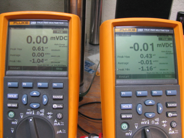

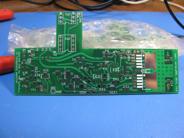

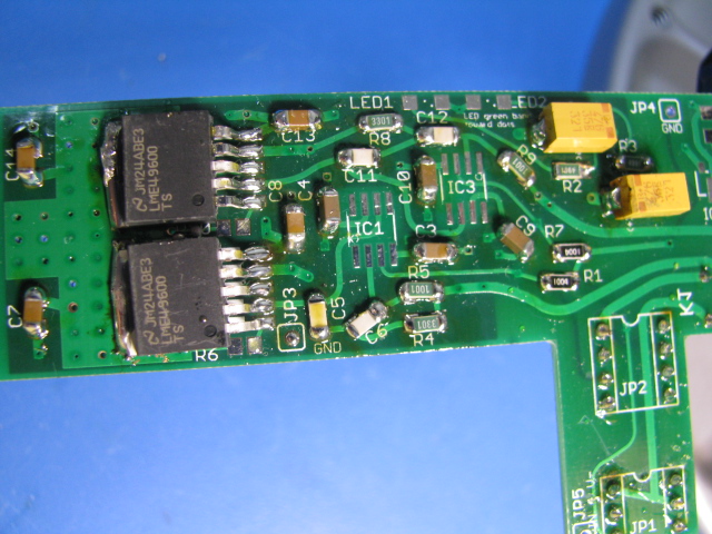

V3.0 boards work

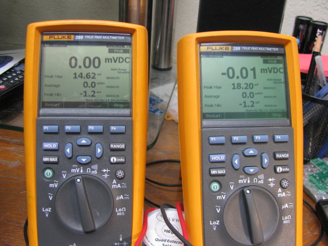

I just received the V3.0 boards for this O2 headphone amplifier booster board project and built one up. It works! 😀

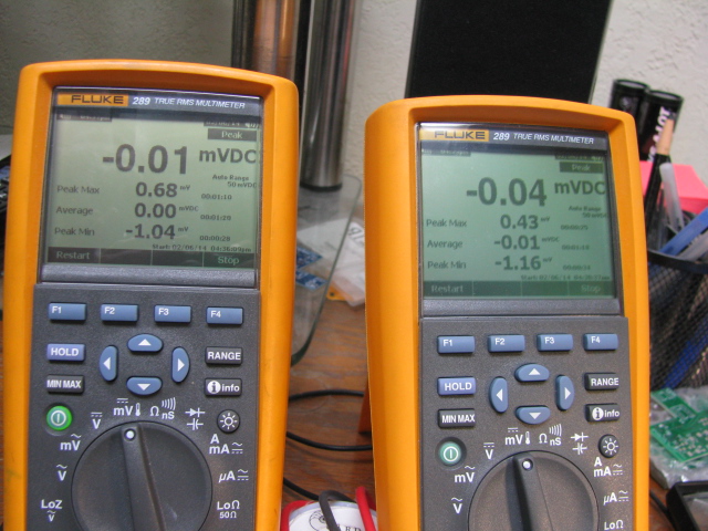

The new headphone relay works perfectly. From the DMM peak-reading pictures below (second post, ran out of picture posting space), upon O2 turn-on there is now exactly zero turn-on transient voltage or thump. Just the DC offset which is reading 25uV for one channel and 50uV for the other (I built this one with OPA140 chips). On turn-off, from the photos, the turn-off transient is now down to around 15mV, down from the 200mV the O2 produces in stock form. Still slightly audible but a 90% improvement over the basic O2 headamp. No worries at all about any headphone or IEM damage from thumps at this low level.
On the ODA amplifer I was able to use a second set of contacts in the on/off switch to loop the relay coil through, resulting in zero turn-off thump on that one in addition to the zero turn-on thump. Couldn't do that here since RocketScientist is using all his switch contacts, but a 90% reduction is more than adequate.
I have updated materials for the V3.0 boards posted at the Google Drive link now, under the 1_18_2014 V3.0 folder. BOM, updated build instructions, circuit, layout, photos, and part ID diagram. I should have the Gerber files (to make your own boards) posted later today.

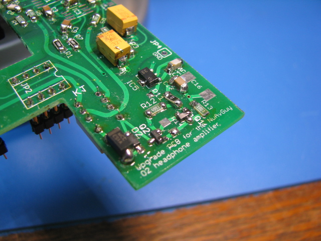

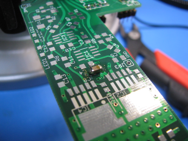

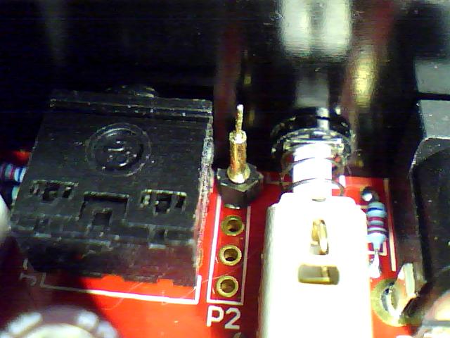

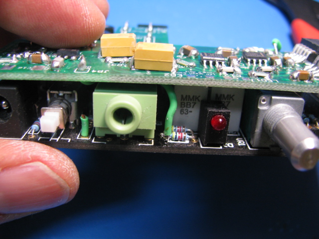

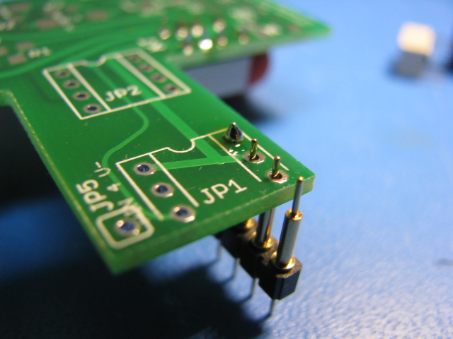

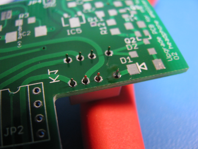

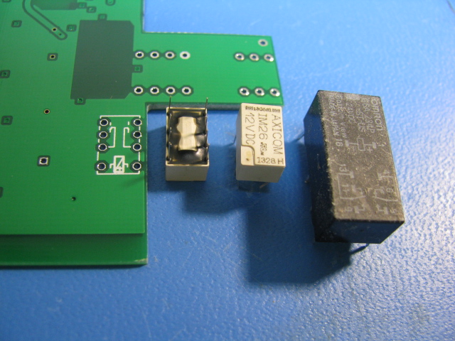

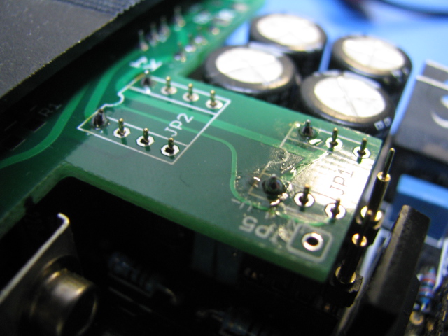

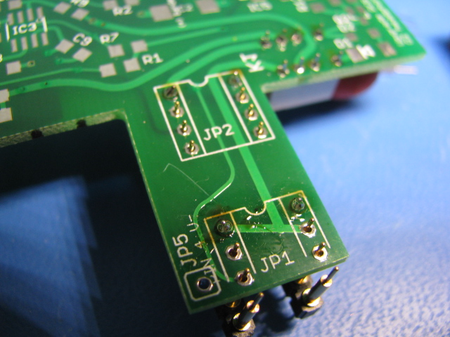

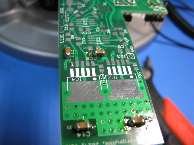

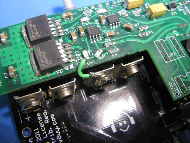

Photos:
* first two are the front and back of V3.0.
* next two show the size comparison between the TE connectivity relay I used, vs. the Omron G6A I posted about above. Much smaller! The second photo shows a good way to solder. Solder one pin first, then put your thumb on it and resolder while pressing up to get the relay flush. Then solder the rest of the pins.
* the next four show a better way of soldering the board connection pins. Just solder one pin on each 4-pin strip, so the strip can be bent left and right as needed to line up with U3 and U4 on the O2 board. Note that the plastic strip on the connection pins goes down, toward the O2 PC board. Then slide the sandwhich into the O2 case, pulling the top up slightly if needed, to get the boards aligned. THEN solder the rest of the connection pins. The final photo shows how closely the connection pin plastic should sit to the U3 and U4 sockets. If it doesn't then one of your pins strips isn't in the U3 / U4 socket holes properly.
* then remove the booster board from the O2 again. The next photo shows the way the relay and the 4 sets of connection pins should look, under the board, when finished.
* the final photo shows how C8 should be soldered on first due to the close proximity to the buffer chips. This is in the build instructions.

Photos:

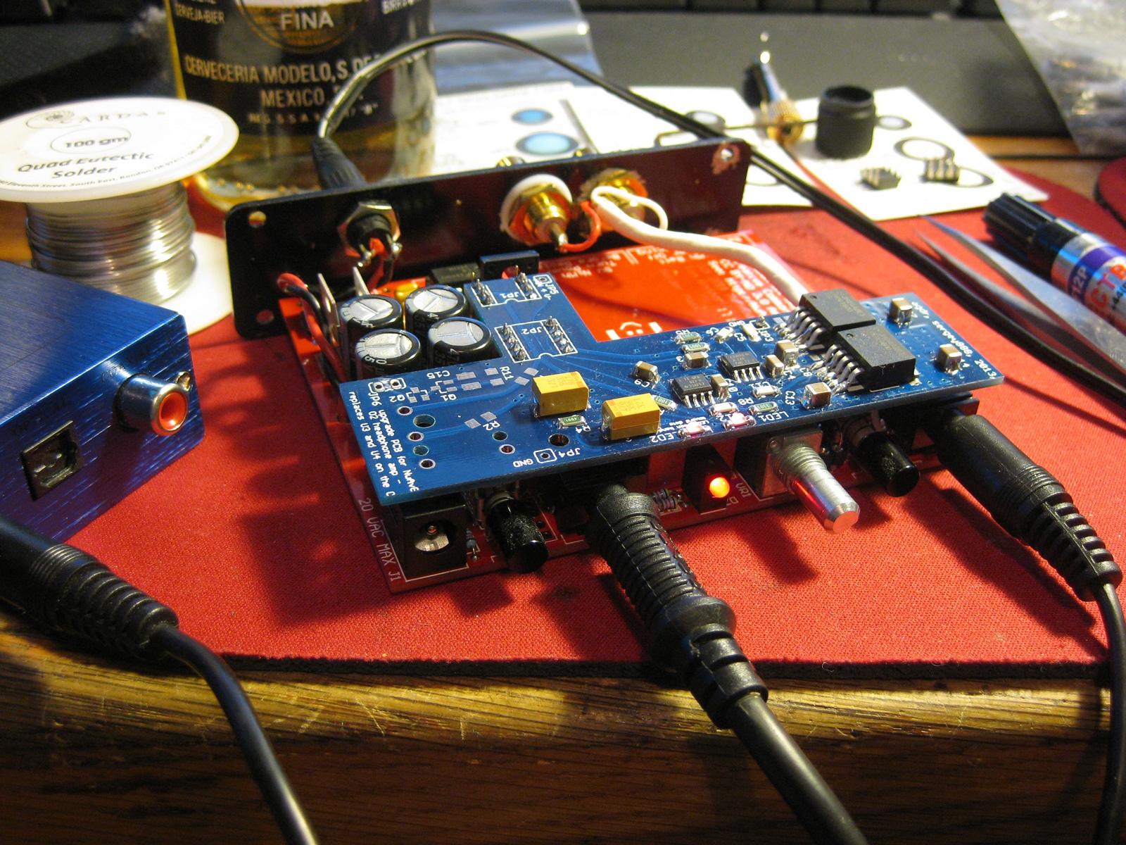

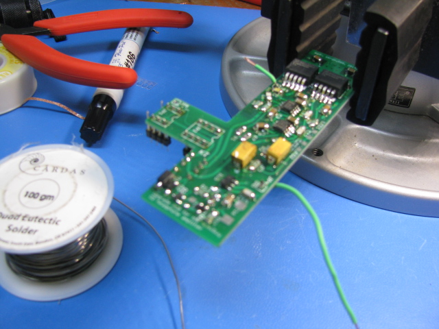

booster board V3.0 photos, continued...
* the first photo shows that while soldering in C8 first, you may want to just go ahead and solder all 4 of the 10uF 35V caps in, which you have that bag from Mouser out.
* the next photo shows everything soldered on but IC1 and IC3, the LEDs, and the relay circuitry. The build instructions say to solder in IC1 and IC3 last to help reduce the change of static damage. Note that I haven't used de-fluxing cleaner yet.
* the next photo shows all the relay circutry soldered on the other end of the board.
* the next three photos shows the two ground wires being soldered on and connected to the O2 PC board. O2 booster board V3.0 uses two ground wires, as explained in the build instructions. The short one goes to either middle battery terminal. The long one goes to the grounded side of the 40.2K resistors on the O2 PC board, as the second photo shows. The wire goes around the back of the O2's output jack.

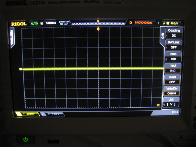

* the next photo shows the test setup for checking turn-on and turn-off transients. The DMMs are set to a fast-responding DC peak voltage hold mV scale. One DMM on the output of each channel with test headphones attached.
* the next two photos show the peak mV dc readings before (first photo) and after (second photo) the headphone relay closes. Essentially a non-event. 🙂 The final photo shows the captured peak readings on O2 amp switch-off. Around 15mV, down from 200mV for the original O2 amp. Note the measured DC output offset on the second DMM photo at the top of the display - 10uV and 40uV! Can't beat that. I'm using the OPA140 chips in this build.

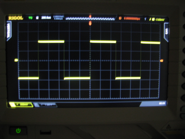

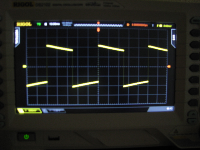

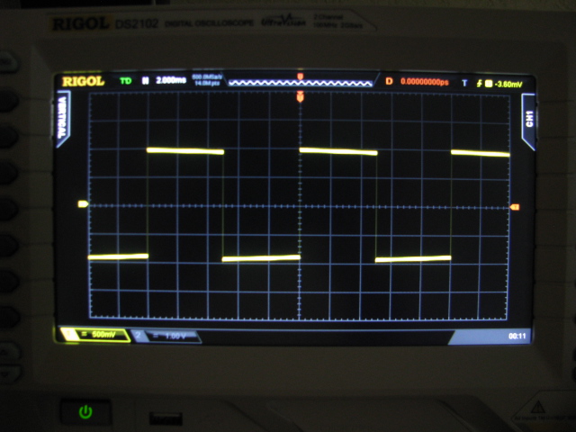

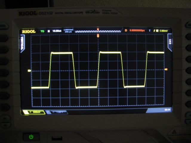

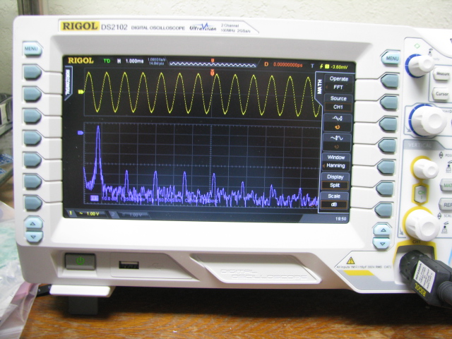

Here more pictures of V3.0 testing.
The first is scope shot to show no oscillation with capacitive loading. That is a 0.01uF axial cap in the clips and a 5nS time base on the scope. I've also tried 1000pF and 500pF with a few different headphone loads. I've upgraded the scope here to one that has a measured 175mHz 3dB point, so the bandwidth now covers that 80mHz peak in the LME49600 that Sergey888 found. I noticed that National does have mention of that buried in the datasheet graphs.
The second scope shot with a 5mS time base shows no 60Hz or the next few harmonics. I wanted to verify that given the position of the relay now vs. the AC input parts in the O2. Both scope shots were taken with the O2 on AC power with a 16Vac adapter. O2 input disconnected (grounded).
The square wave shots are at 20kHz, 1kHz, 100Hz, and 20Hz. Remember that the droop on the very low frequency wave is due to the O2's coupling capacitor in the middle.

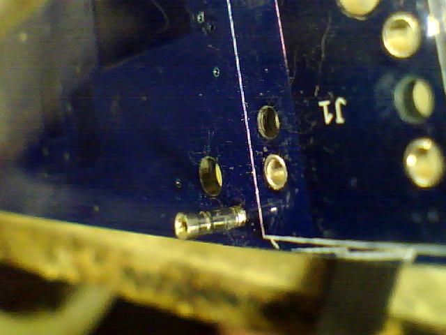

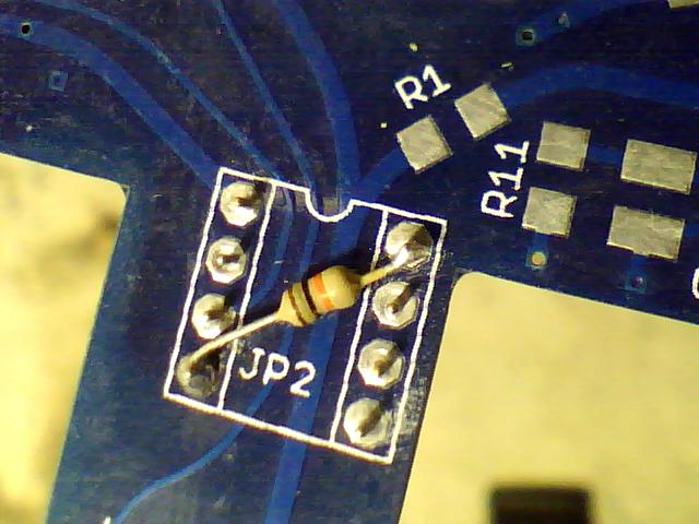

V2 installed and working 😀
Assembly was pretty straight forward, though i did run into an issue on a prebuilt O2 (i have two) in that the two power supply caps C8/C9, and the two output caps C13/C14 weren't sitting flush against the PCB so they needed pushed home to make room for the booster PCB. Once i confirmed everything was working without magic smoke coming out i installed it into my main amp. I should also note its important to get the two LME49600 buffers soldered as close to the PCB as possible as there is zero clearance with the case.
I chose the OPA827 opamps as it seemed a worthwhile upgrade for the cost vs performance. I also installed the two LED's, just because. As for DC offset, i measured .003v on the left/right channel as stock, and nothing after as my meter isn't sensitive enough.
So how does it sound? Surprising, very surprising. I confess i havent used the O2 in a long time as i've moved onto building valve amps with capacitors that cost more than the O2, but yet i'm still stunned by how good this sounds. As i have two O2's i was able to do some side by side comparisons and the stock one is pretty much as i remember, clean, precise, maybe a little bit too clinical, and lacking a bit of presence and low end energy. The booster modded version however is a different story, it somehow manages not to sound like an opamp, it has a soul and sucks you in to the music. I'm going to have to spend more time with it to rationalize the difference, but what i hear so far i like, a lot.

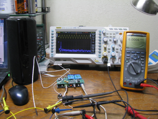

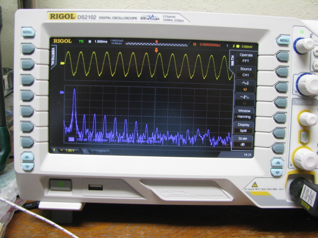

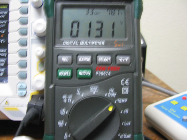

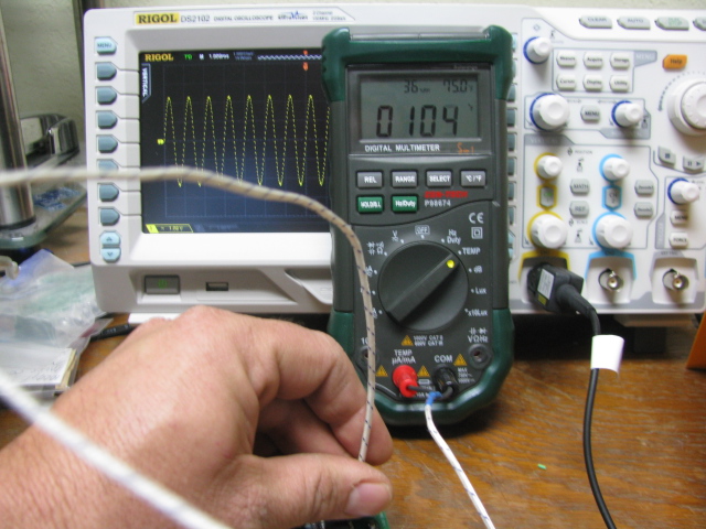

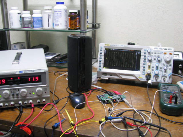

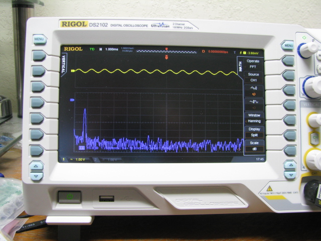

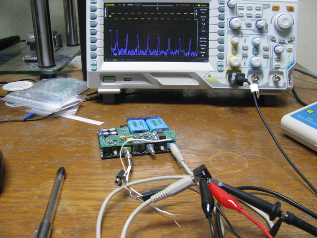

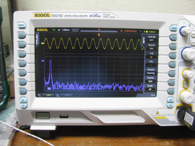

V3.0 maximum load testing
Here is a fun maximum load test on the V3.0 O2 booster board. I'm using an 8 ohm speaker here since I wouldn't be able to push this much power into most headphones.
The first photo shows the test setup. I have an 8 ohm speaker connected to the booster board. The first batch of testing is done on batteries since the O2's un-heatsinked voltage regulators would overheat with the load. That is a thermocouple hooked to the green meter. I did a test using the O2 amp on AC and stopped when NwAvGuy's regulator tabs hit 180 degrees F.
The setup is being fed from a function generator set to make sine waves. The scope is set for split screen, with FFT on the bottom and the actual waveform on the top.
The next two photos show the spectrum out of the generator, for reference, with it hooked to the (10K) input of the O2. The generator is set for just under 1 volt peak, while the O2 is set up for 2.5X gain. The first photo is the spectrum using square waves, while the second is the 1kHz sinusoid used in the tests. The vertical scale is in dB so the fuzz at the bottom is way down, just a few mV. Keep in mind that scope FFTs are much noiser than audio software + soundcard or AP/dScope readings. That noise isn't the generator as much as the scope and the pickup noise in the leads. I also have the scope set for input averaging to smooth out the FFT, and I'm using a Hanning window.
The next photo shows the FFT with the output of the booster board into the speaker just below clipping at 2.2Vpeak. The next photo is at 2.4Vpeak showing the onset of clipping, which clearly shows up in the FFT with all those harmonics popping up. You can see a bit of distortion showing up at the bottom peaks of the waveform at the top of the screen.
With the booster board output pushing the 2.2Vpeak into the 8ohm speaker (before clipping), the next photo shows the temperature rise on the LME49600 chips is just 104 degrees F. Easily sustainable long term for both the chip and the board foil.
I've measured the speaker's actual impedance at 1kHz to be closer to 10 ohms, so for accuracy I'm using 10R in the calculations. The power into the speaker is sqr[(2.2Vac)(0.707)] / 10 = 242mW. More than the vast majority of headphone require, so this already proves the booster board can tackle high current (low impedance + low sensitivity) headphones with ease. The rms current through the LME49600 chips is (2.2)(0.797)Vac / 10 = 155mA. Well within specifications for the 250mA - rated LME49600.
To ratchet things up a notch, in the next photo I have +/-11.9Vdc from an external tracking supply fed into the O2 to get around the problem of its voltage regulators overheating with the large loads. The next two photos shows the waveform and FFT into the speaker just before (3.2Vac peak now) and just after clipping. Again the onset of clipping is obvious from that array of harmonics that get generated. The test signal is still 1kHz. So the final photo (sorry about hte blur!) shows that the LME49600 temperature is now up to 131 degrees F, and stable at that level in open air. That would still be perfectly fine from the chip's standpoint, but the OC board foil may not be able to take that long term without de-bonding. Inside the closed case that temp would likely increase considerably. This level of loading is pretty much an absolute maximum for the booster board.
So just before clipping the power into the speaker is now sqr[(3.2Vac)(0.707)] / 10 = 512mW! The rms current through the LME49600 is now [(3.2Vac)(0.707)] / 10 = 226mA, just barely under the LME49600's 250mA rating. Peak current is 3.2Vac / 10 = 320mA.
All in all I'm quite happy with the O2 booster board's results! 😀
Hey thank you for the feedback! I'm actually just now reading your post. From the time stamp you must have posted just before I did last night and I never thought to scroll up when I was done.😛
Good point about those 4 O2 capacitors needing to be flush. I'll add that to the build instructions. The clearance to those caps is close enough I carved that square section of bottom foil out of the board where it sits over the top of C8 and C9, just to make sure nothing connected accidentally.
Very true about the LME49600s needing to be down flat. I've found it makes a huge difference in soldering those to use a wide chisel tip on the iron vs. the regular narrow tip. On this latest build just for fun I tried soldering in the LME49600s with the regular tip and just couldn't do it. Only a small area of solder area would melt. Then I switched over to a 3/16" wide chisel tip - same 80W soldering station - and no troubles at all. The whole surface area melted just fine. I guess it is an issue of getting enough heat to transfer from the tip to the part.
I've found that a two-step soldering process works well with the LME49600. After getting the part soldered up the first time and the 5 leads aligned, I go back and while pressing on the top of the part with a tool, I re-heat the tab & foil to get it down flat on the board. On this last build when I did that one of the chips dropped a noticable amount, like 1/32" or so.
I have the front panel hole measurements for those LEDs in the build instructions now.
Thanks for the listening report! 🙂 I'll be quite curious to hear what people's experiences are using various headphones.
No problem. Just to confirm on the caps, my prebuilt O2 had the regular Nichicon and Kemet caps, and the one i built has the Panasonic FM and Wima caps which are listed in the BOM as optional parts, booster fitted both amps without issue.
The 49600's were a challenge alright, i ended up creating a pool of solder with the tip inside to maximize the heat transfer into the board/chip while pressing them down with tweezers. I was worried i had cooked them they got so hot.
I've been listening so far with Ms-Pros (variation of Grado RS1), but i'll try the HD650's and see how it handles a high impedance load. The O2 and HD650 was always a bit weak sounding to me so will be interesting to see.
The power on/off noise is different alright, its more of a sharp sput sound rather than the soft thump of the stock config but its a non issue in my opinion.
Good point about cap substitutions. In fact one of the O2 mods I posted in that mod thread was increasing the 2.2uF's to 4.7uF WIMAs. I think that 4.7's were the same height but I should check to make sure.
I've just updated the V2.0 and V3.0 build instructions at the Google Drive link with this issue and the LME49600's flatness. Thanks again for the feedback. 🙂
I've also updated the first posting in this thread to reflect the V3.0 boards being fabricated.
Remember to cut the leg off the gain switch on the O2
It sounds like a few people are building up brand new O2 boards for the first time along with their O2 booster board. With your O2 build, remember that NwAvGuy has one layout error on there that needs a quick fix. He posted about this in the O2 thread but the post is burried in that huge thread now.
One corner leg of the gain switch sits right above a through-hole on the O2's PC board. If they touch the gain on the left channel will go super-high, essentially turning it into a comparator as the signal clips against both power rails, and it will turn your input signal into square waves. Those will go right through the coupling capacitor in the O2, being AC, and make it to the headphones.
The fix is to clip that particular leg of the O2's gain switch off with wire cutters before soldering it in. You can bend it up enough with the tip of a screwdriver to clear the through-hole if the switch is already installed.
I've just added mention of this issue to the V2 and V3 O2 booster board build instructions.
The first pic is a 10k resister across +15v and -15v like the version 3 board.
The second and third is a clean way to ground the booster board.
Just some ideas. First time posting pics on this forum. 🙂
