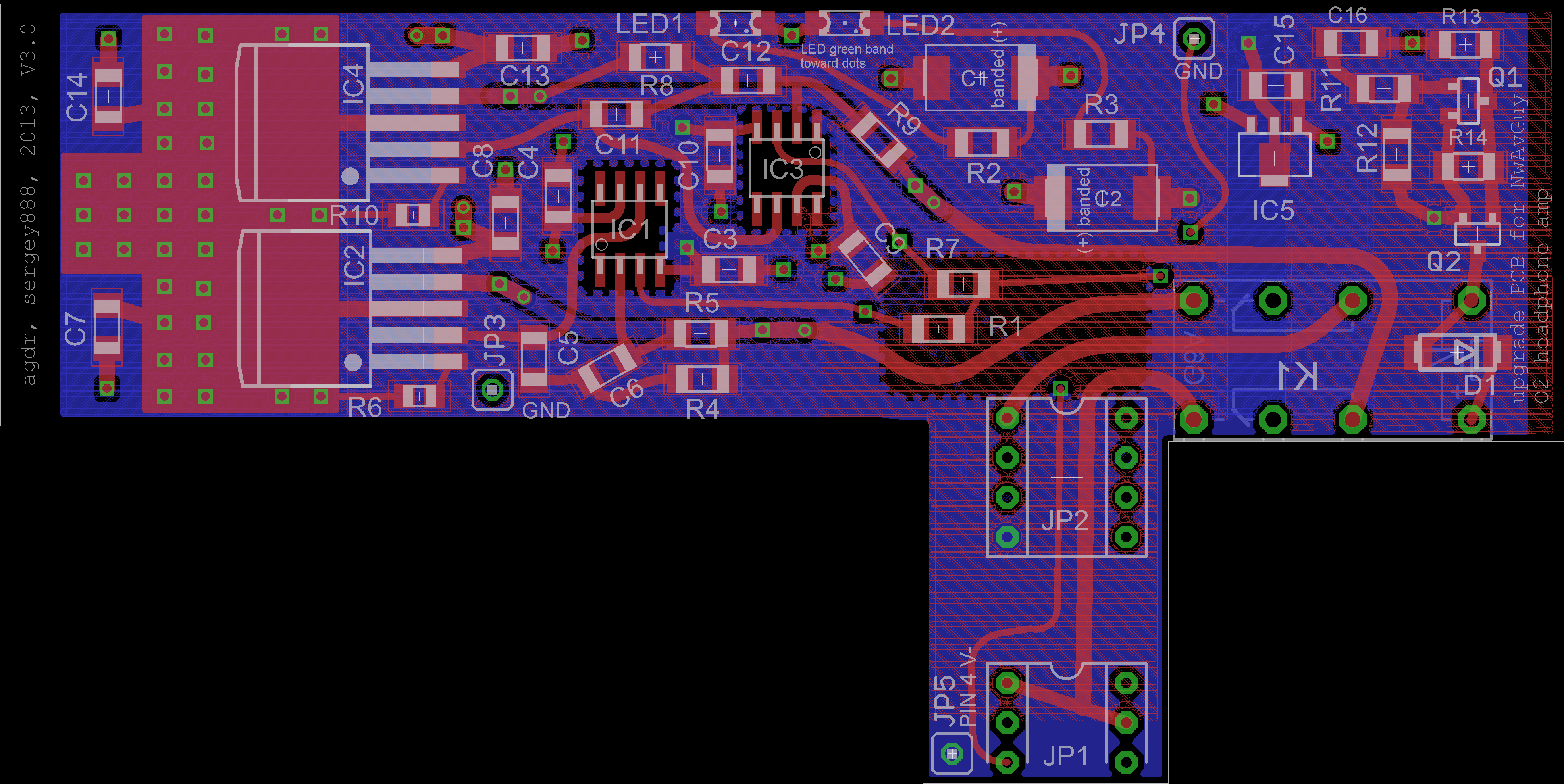

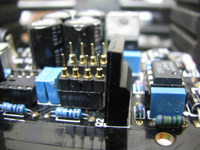

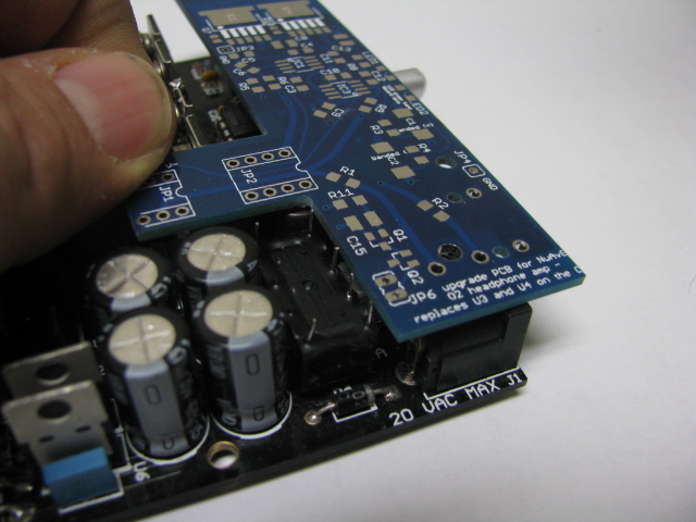

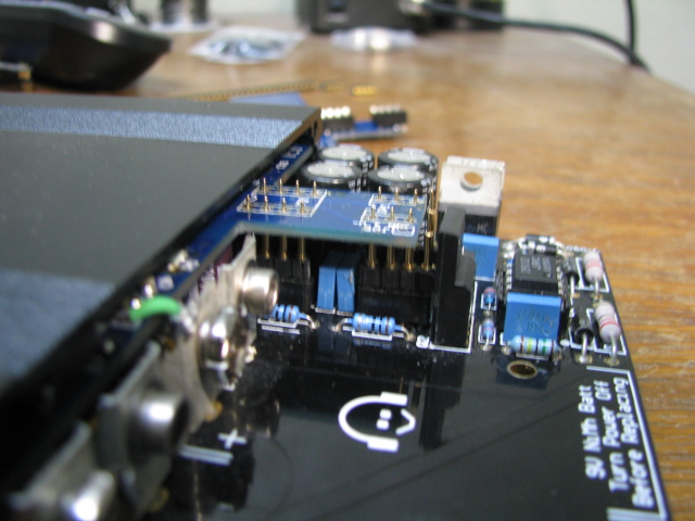

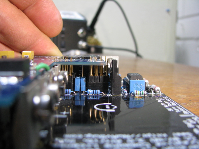

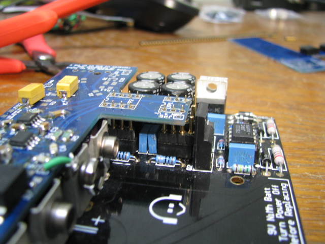

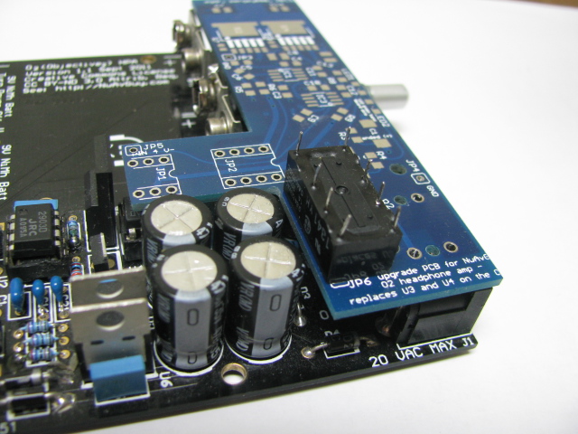

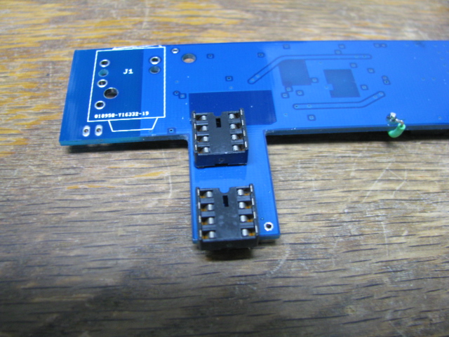

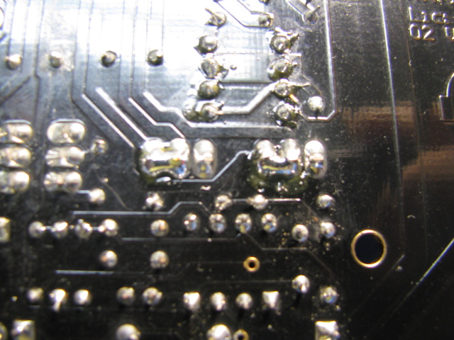

Here is an update on this O2 booster board project. I received the pluggable DIP headers from Digikey today. They work, but I think it may be possible to do even a little bit better.
The net result is a bit on the tall side, pushing the booster board up to the top of the top slot. That works, but after some more measuring it appears the next header in the Mill-Max series, the 592 (Digikey #ED17064ND) with the 0.335 inch board stacking posts would be just about perfect and would drop the need for the upside down DIP sockets on the booster board tab. I've ordered some and should know in a few days. The other thing that would work would be a similiar dual-end "pluggable" header without the extension posts, but so far no luck on finding any listed at Mouser or Digikey.
The first photo shows the DIP sockets soldered upside down on a O2 booster board. Next is the pluggable SIP header next to the O2's upright U3 and U4 sockets and the booster board's upside down matching DIP sockets. The next two photos show the O2's DIP sockets loaded with the headers that have been cut into groups of 4. The last two photos show the assembled "sandwich".

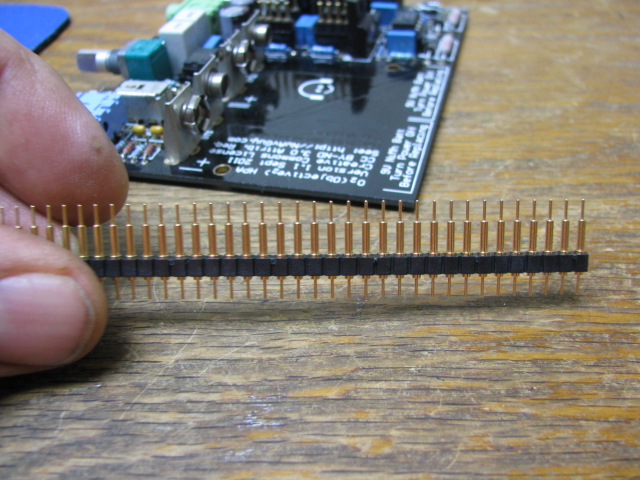

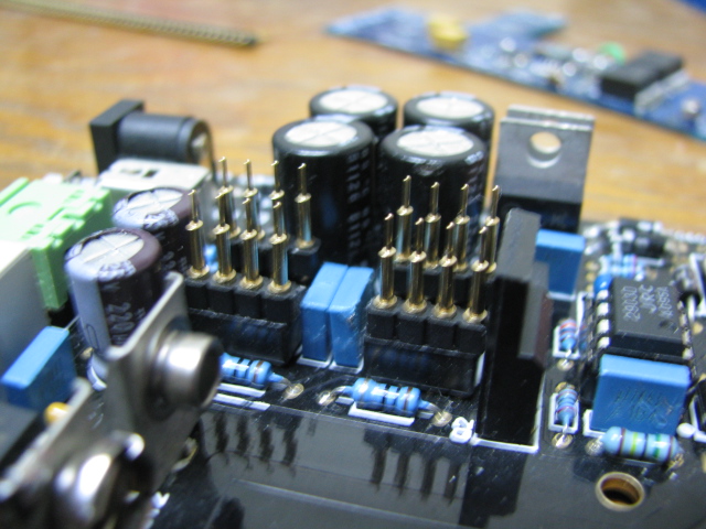

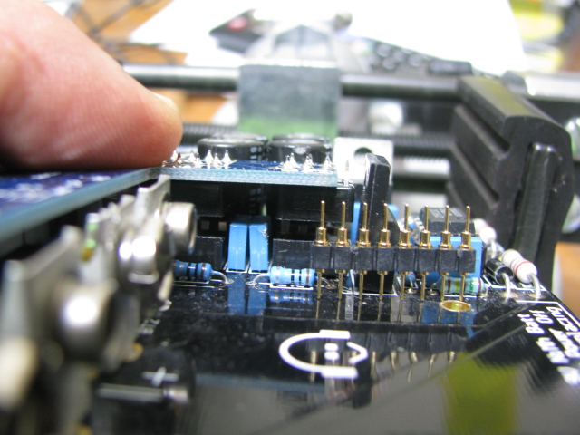

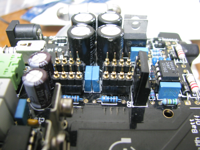

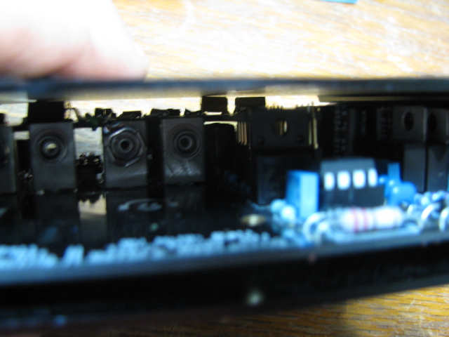

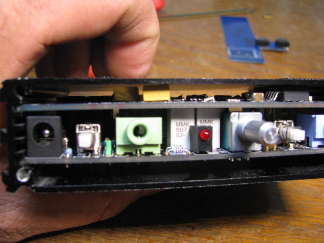

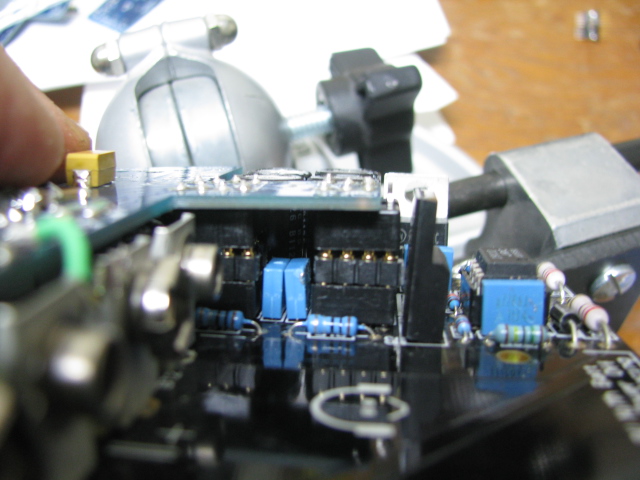

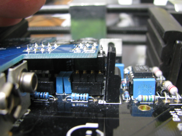

The taller interconnection SIP headers for this project arrived from Digikey today and they mesh the two boards together just absolutely perfectly. 😀 Thanks again to MisterX for the heads-up on these.
These headers are going to make it ridiculously simple to hook the two boards together. Photos below. I'll include a set of these headers with the boards to prevent a separate order having to be made to Digikey.
I'm going to be gone the next couple of weeks for the holidays. I'll be able to send the at-cost DIY boards out to those interested after the first of the year. Keep an eye on the vendor forum thread for my O2 stuff. 🙂 I also see that I accidentally nuked the spreadsheet of those interested. I'll put that back, but here is a better link to the Google Drive location of all the O2 booster board stuff. Just look in the folder with the most recent date, under "orders".
https://drive.google.com/folderview?id=0B67cJELZW-i8Vmp5MDVLNzJxTGc&usp=sharing
Happy holidays!
Photos:
* The new "dual pluggable" SIP headers with the taller 0.335 inch board stacking posts.
* The headers snipped in groups of 4 and inserted into the O2 amp's U3 and U4 sockets.
* (next two photos) the free ends of the SIP headers run through the booster board DIP holes. Remember that the bottom two posts of the U4 header stick out from the end of the O2 booster board on purpose. The fab only allowed 50mm of board width, which only took it to the 3rd row of pins.

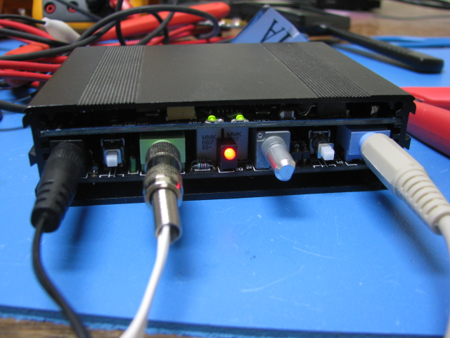

* The O2 PCB and O2 booster board partially insterted into the B2-080 case to align the board relative to one another with the case slots... then solder it up!
* (next two photos) showing plenty of clearance between things sticking up out of the O2 booster board and the top of the case.
* (next two) shots showing the completed board with batteries installed and the ground wire re-attached to the center battery terminal.
* thing whole thing hooked up and playing music. Only 20uV of DC offset. I forgot to set the other channel meter to show DC in the photo, but it was similar.

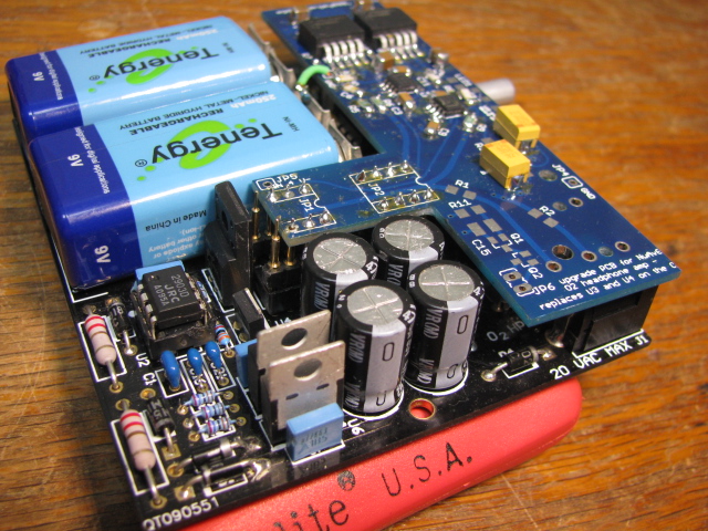

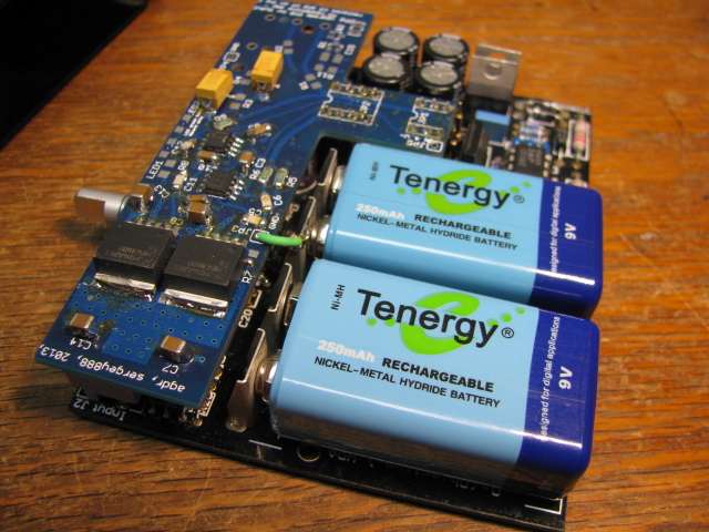

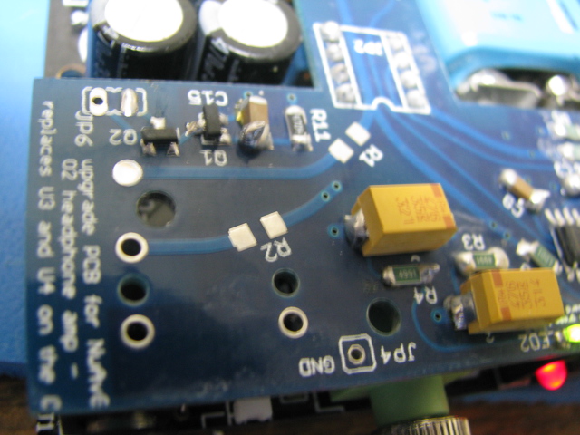

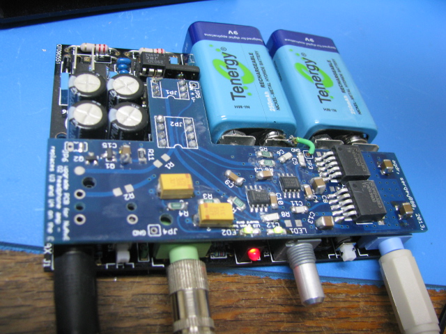

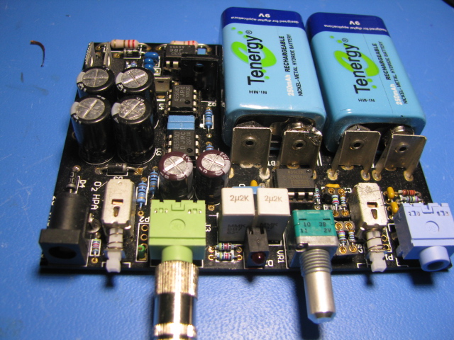

I'm back in town. Here are some photos of the rest of the parts added. The LEDs, associated anti-thump resistors (O2 modification) and the latch circuit for the O2's power management circuit. I'll take some photos today of how that latch circuit wires into the O2. These modification parts are separate from the amp circuit and are optional. I cover that in the build instructions.
* The first photo shows how nicely the new stacking posts fit. Just solder them up at this point.
* The next photo shows the two LEDs. One per power rail so you always know if both rails are working now. These are "right angle" side-firing chip LEDs in the BOM. They are in series with the anti-thump resistors next to the big caps. Those provide a resistive load to ground after the O2's mosfets (a load other than just chips) which allows the rails to bleed down linearly after mosfet shut-off, preventing thumps. The LED current comes for "free" in series with those resistors. Two small holes have to be drilled in the O2 front panel above the red LED if you want to see those two new LEDs. I'll provide dimensions.
* The next photo shows the latch circuit components. Keeps the O2's power management circuit from oscillating when the batteries get low and it cuts off.
* Two assembled shots, and a couple of photos with it all working. 🙂 The first closeup photo of the DMMs on the two channels is an instantaneous reading, with music playing, so the readings are bouncing around of course. The second shot of the meters is with the input unplugged (and hence grounded). That tiny amount of AC (237uV & 151uV) is just 60 cycle pick-up in the external wiring since I have the boards out of the case and a fluouresent light nearby for the photo. I should have taken a shot with the meter set to freqency, but that is 60hz and not oscillation. I've also checked it with a scope under all sorts of load capacitance conditions now.

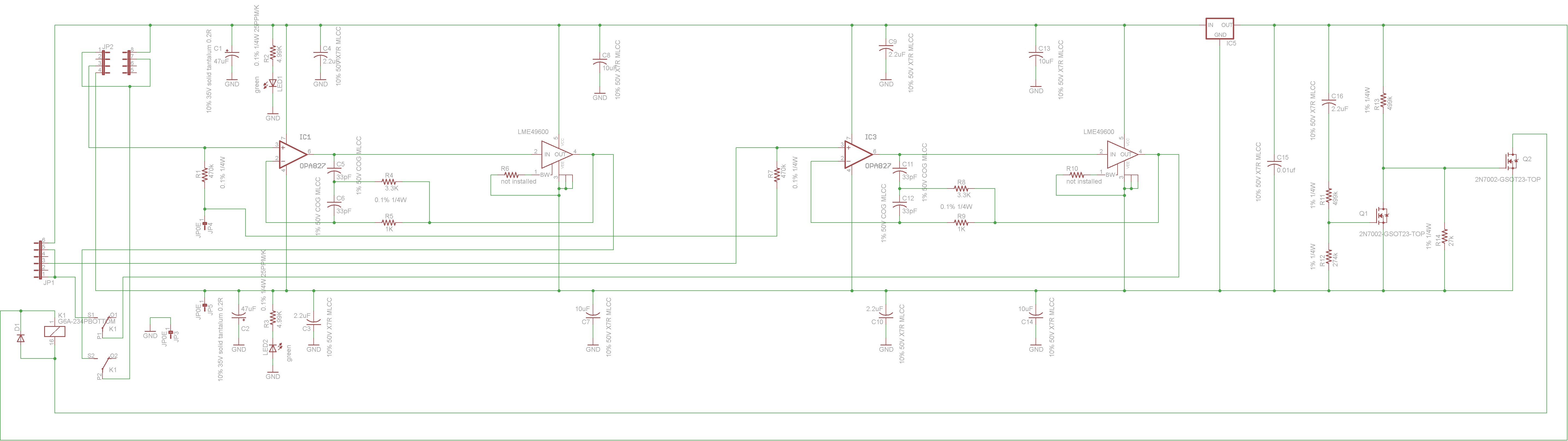

Not going to release this PCB, unfortunately...
Well after a bunch of testing the last few days I've uncovered a glitch in this project that is bad enough that I'm not going to release the PC boards or Gerber files, unfortunately. My appologies to those who have been interested in the boards! But that is why we test these things. 🙂 I've deleted the "orders" spreadsheet from the Google Drive link.
I may whip up a revised board as time permits later this year. The sound of the OPA140 + LME49600 combination is fantastic. I would encourage anyone else interested in the design to simply whip one up themselves, even if just on a proto-board! I'll leave the Google Drive link up with all the schematic and layout information. Those plus the info in this thread should be enough for anybody to whip up their own version.

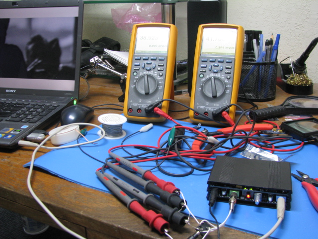

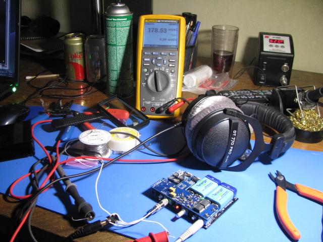

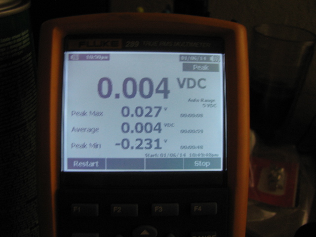

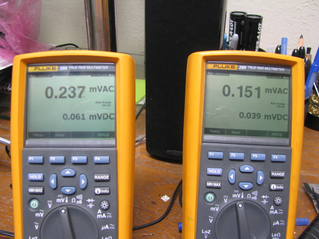

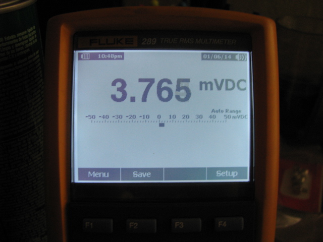

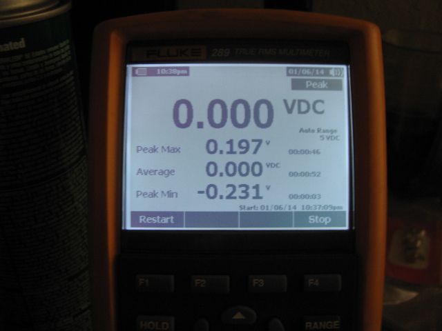

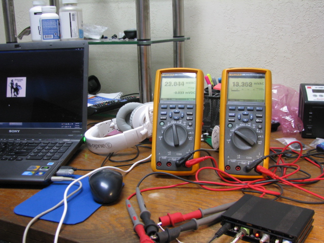

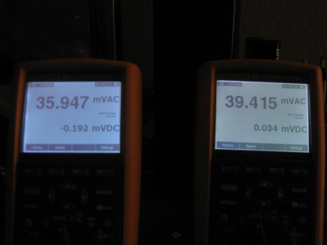

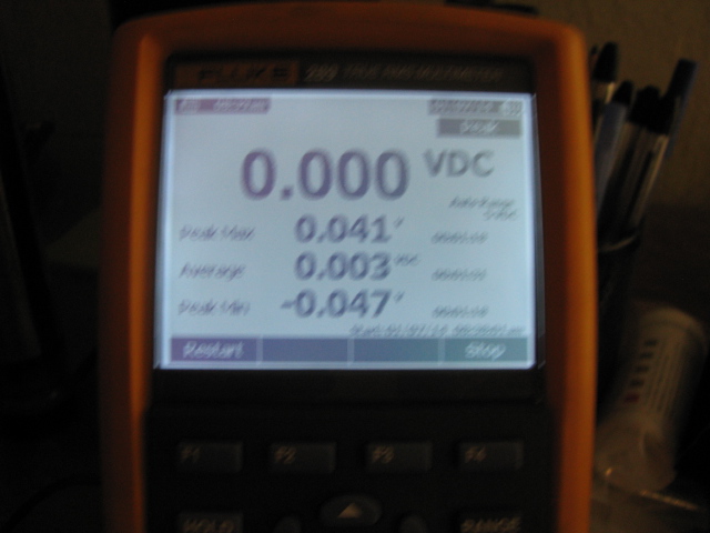

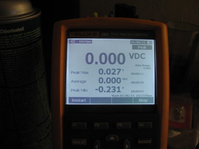

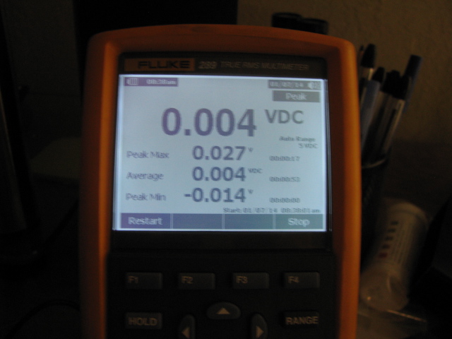

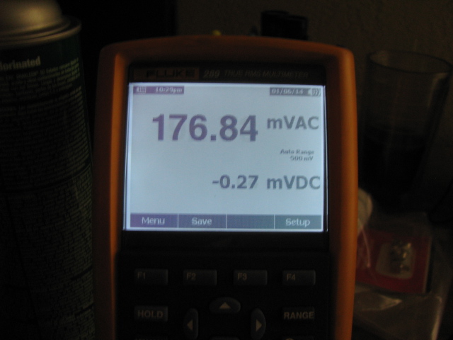

I built up the the OPA827 version tonight with some interesting results. The turn-off thump is still there, but it does look like the O2 design itself may the culprit. The booster board here may have just brought an O2 problem to the surface.
I had forgotten the DMM has a fast-repsonding peak-hold function. Just what I needed to capture the thump on the output. I had never tried capturing peaks on an un-modified O2 output before. Here are the rather distressing results...
The first two photos are the test setup and average AC and DC output results on one channel. I have the new Beyer DT-770s hooked up to allow me to crank the output up a little bit. These guys seem to have normal volume levels at around 175mV vs. the 50mV of the more sensitive, lower impedance cans.
The OPA827 has a definite thermal warm up period to DC-stabilize, it appears, much more so than the OPA140. As shown on the meter here the initial DC output offset is around 250uV - 300uV (270uV int he photo), about 10 times that of the OPA140, but still 1/10 of the O2 with the NJM4556A chips. But after about 5 minutes of "on" time warm-up that drops down to around 30uV for the OPA827. Both channels did the same. I noticed this a month or two ago when I did tests on the earlier board I posted with the OAP140 on one channel and the OPA827 on the other.
BUT... the fun stuff is with the peak readings. The next photo is a peak hold reading with the OOPA827 booster board in place, switching the O2 from off to on. Notice that the meter is now on the volts scale, not mV anymore, so that is a whopping -231mV - not uV - fast-moving turn-on transient. I'm not really hearing a turn-on transient, so this must be an extremely fast spike. Still, it is there. Not the best.
The next photo shows what happens then when the O2 is switched from on to off. A positive 197mV spike, which is what I'm hearing, so this one must be longer in duration. Keep in mind that the average DC output offset is still just 30uV or so while the unit is on.
So then I start wondering what the O2 amp's output peaks are with the normal NJM4556As installed. The next photo shows the O2 with the booster board removed and NJM4556A's re-installed. No tricks up my sleeve. 🙂 The next photo shows the resulting DC output offset, the O2's typical 3.7mV-or-so.
The next photo is the off-to-on peak hold reading of the O2 with the NJM4556A chips back in. At first it showed just 14mV or so, but after about 20 seconds that suddenly jumped to around 24mV, than at roughly the 45 second mark, boom - that -231mV negative going fast transient. It was stable from there. I retried this 4 or 5 times just to make sure it wasn't an error, but the O2 behaved the same way each time. Coming up on a minute it is somehow generating a mystery fast moving -231mV transient. That is the same number that popped up with the booster board, so I'm taking this as confirmation that the booster board is just bringing an O2 issue to the surface here a bit more rapidly.
The final photo shows the peak hold reading with the O2 then switched off. This generated the 122mV positive peak on the meter, which is the O2's typical, audible, turn off thump. Longer duration.
I should do the same test on a couple of other O2s here. Maybe there is some issue with just one. But I would be curious what other folks get if anyone else out there wants to test their O2s with a peak hold meter or scope. All of these peak tests were done with the source input unplugged and hence grounded.
In summary, in my view anyway, a 122mV transient is a distressing thing to see being feed to the headphones on turn-off with the normal O2 with the NJM4556A chips. The O2 really needs a on output relay, IMHO. 🙁

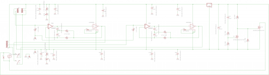

O2's power management circuit generates transients
I found the problem. RocketScientists' design of the O2's power management circuit is generating the turn-on and turn-off transient peaks. The circuit is leaving one power rail mosfet on longer than the other, resulting in one power rail being connected and the other disconnected to the amplifier chips for an instant. The rail imbalance generates the transients.
He has the gates of the two power rail mosfets going through cascaded comparators, adding a bit of propagation delay. But the bigger issue seems to be that the comparators have open collector pull-down transistors, then he has an RC pull-up network on each. So the "on" direction for the compators is fast, but the "off" direction is a slow RC charge or discharge. For each power cycle you wind up with one mosfet with a "fast" turn on while the other is experienceing a "slow" turn on.
For example, when the PM circuit turns on, the gate of Q1 is quickly turned on by the first section of U2 pulling down. That turns on the positive rail to the amp chips. But the negative rail isn't on yet. The gate of Q2 has to wait for an RC time delay to eventually turn on.
In the photos below I've just intentionally solder bridged the O2's two mosfets to bypass the PM circuit. The next photos shows the turn-on peaks now. The final photo the turn-off peaks. No 200mV transients anymore. The negative rail transient that showed up at 40 seconds or so is gone too. RocketScientist must have some low frequency oscillation going on with that PM circuit, or an RC section not working the way he is expecting.
I'll see if I can fit an output relay onto the booster board design. That would fix this O2 problem. It looks like the relay circuit will have to delay turn-on a full minute to avoid that negative peak the O2's PM circuit is generating.

Turbon - yes indeed, that version of an ODA is all mine. 😀 The consensus definitely came down on the side of all aspects of the ODA being different enough from the O2 as to not be a "derivitative". A couple of law students in different countries even wrote. The ODA most definitely has a relay and it works well.
Speaking of relays... guess what fits? 😀 Drops right in between the O2's on/off switch and the filter caps. I can mount it upside-down in Sergey888's famous dead bug style! 🙂 The holes for the upside-down 1/4" jack will have to go, along with the PM latch mod circuitry. The rest of that space will be used for the relay circuitry.
The relay winds up kind of close to AC parts, but at least this is the output (low impedance) side which will reduce any AC pickup. The proximity to the two O2 rectifier diodes actually isn't as close as I would have thought. They wind up more on the outer edge of the relay.
I'm going to prototype the circuit and if it all works, including completely eliminating any turn-on and turn-off thumps, I will probably fab a version 3 of the booster board.
Hi agdr
I just looked through the schematic again and came to a conclusion that reconnecting R3 and R6 to LME output instead of the ground may bring some PSRR improvement.
The ground on the booster PCB is more like power, and it is good of you have no reference to it in any point.
It will preserve the second order feedback roll-off around the buffer.
Sergey888 - OK, I'll make that change on V3. Makes sense.

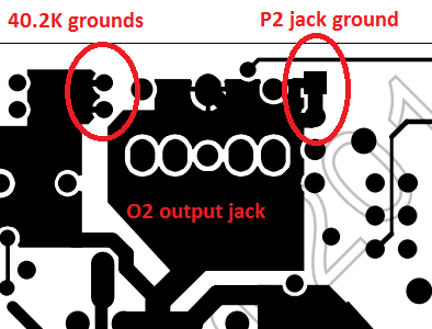

I've been thinking of adding a high value resistor (1 meg or more) to ground on each OPA140 non-inv input though. When the booster board is plugged into the O2 there is a 40.2K resistor to ground on that line on the O2 board. But... before the booster board is plugged in I've been a bit concerned about static damage from having those JFET inputs attached to pins with no return path to ground. Ideally people assembling the booster board will use anti-static grounded wrist straps, but a lot of folks probably won't. In the build instructions I'm going to have soldering in the OPA140s as the last step, making sure the 1 megs are in place first.
Then there is the safety issue if the O2's U3 and U4 socket contacts become intermittant a bunch of years down the road. If those JFET inputs float with no return path for the input bias current the output would probably shoot up to some DC voltage, which would appear at the headphones. The 1 meg resistors would prevent that eventual failure mode.
Once the booster is plugged into the O2 the 1 meg resistors would be in parallel with the 40.2K's on the O2 board, so the overall Johnson noise shouldn't suffer.
Good point about the ground and power. You are quite right, with the change you suggest all of what goes to ground on the booster board will be the IC power rail bypass caps, except these new 1 meg input resistors. I have 3 different ground points (PC holes) on that board right now with build instructions to pick any one of the 3. So far in the builds I've been using the one next to the center ground connection of the two batteries.
But here is an idea. I could separate the ground for the 1 meg resistors and return it to the output ground, in the P2 connector on the O2 by the output jack, since that is where RocketScientist / NwAvGuy has the 40.2k resistors on the O2 board grounded. A snip of that section of the O2 ground foil is attached below.
So the majority of the groundplane on the booster board, with the bypass caps being returned to ground, would ground at the battery center connection. But specifically the 1 meg resistors on the JFET inputs would ground at the O2 output, an inch of trace or so away from the ground on the 40.2K resistors they would wind up in parallel with. That would just mean soldering two ground wires from the booster board to the O2 board rather than one. Comments are welcome!
It is definitely a good idea to have a clean signal ground on the PCB. Perhaps it will be better to use as a signal ground pin the one which is closer to grounding points of the signal resistors of the previous stage.
Sergey888 - here is the revised feedback grounding. I still more cleanup to do on the layout. The PDF's can be zoomed up 300% or more for a closeup.
