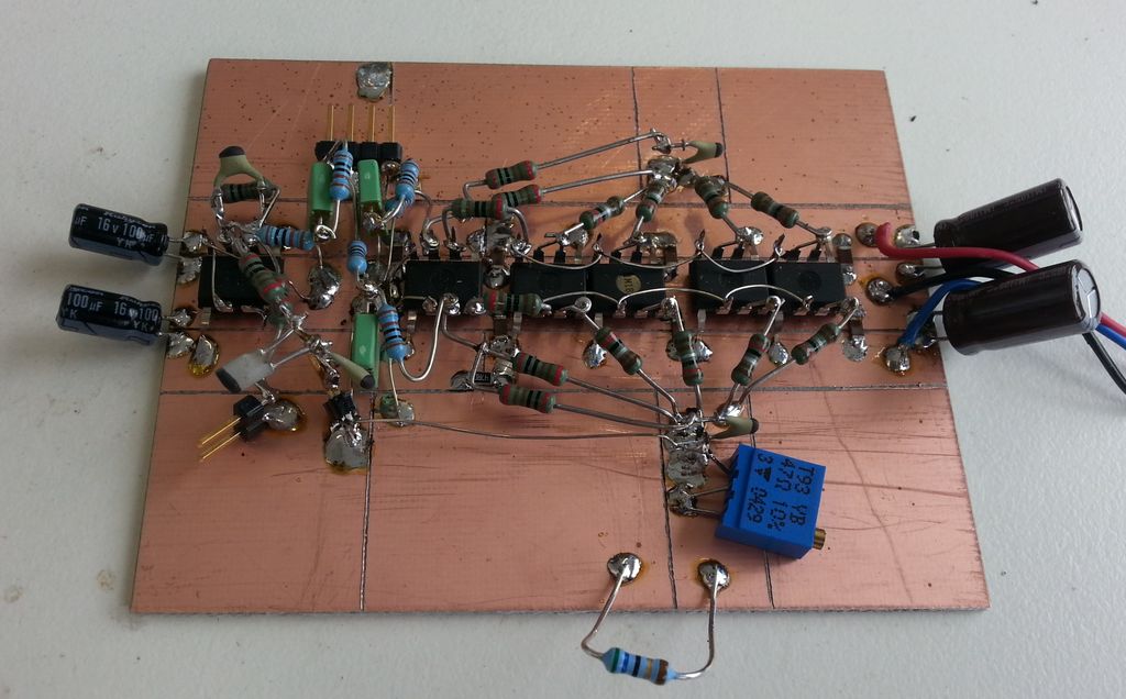

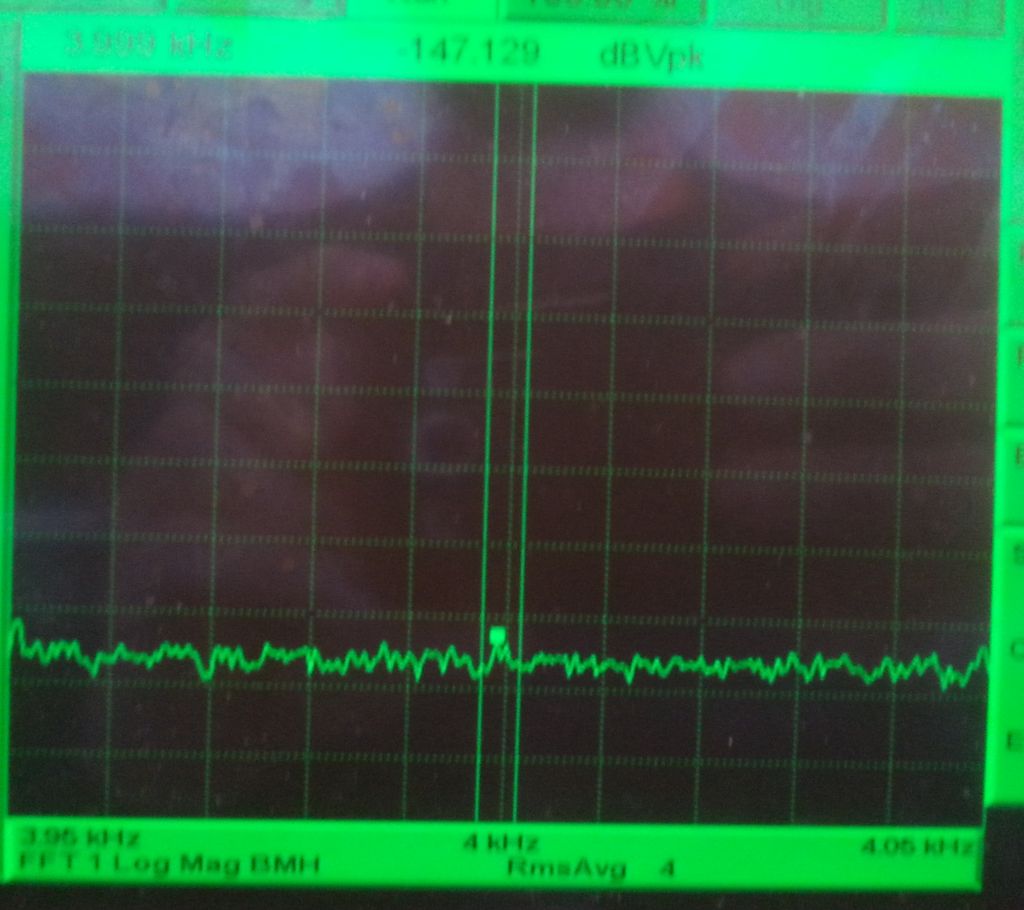

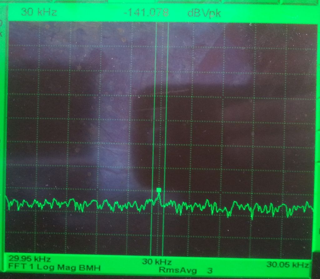

Knowing you are O2 lover, decided to show you what could have been done in O2 design.
Basically this amplifier contains 5 NE5532 opamps per channel. It is made in wonderful dead beetle style.

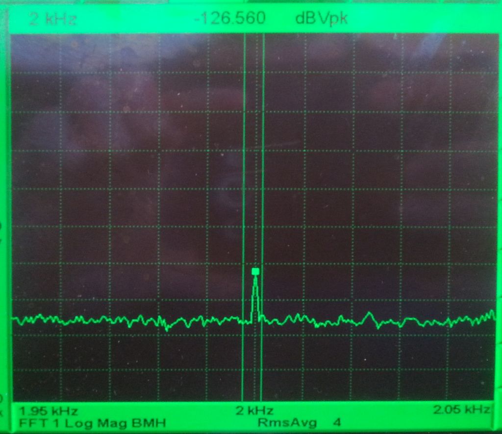

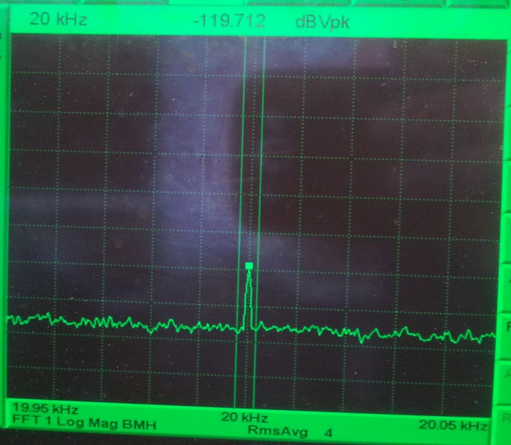

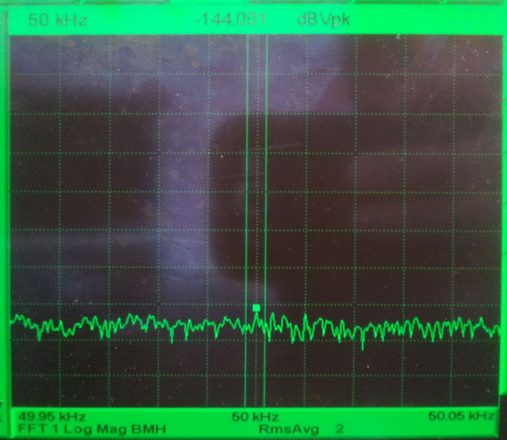

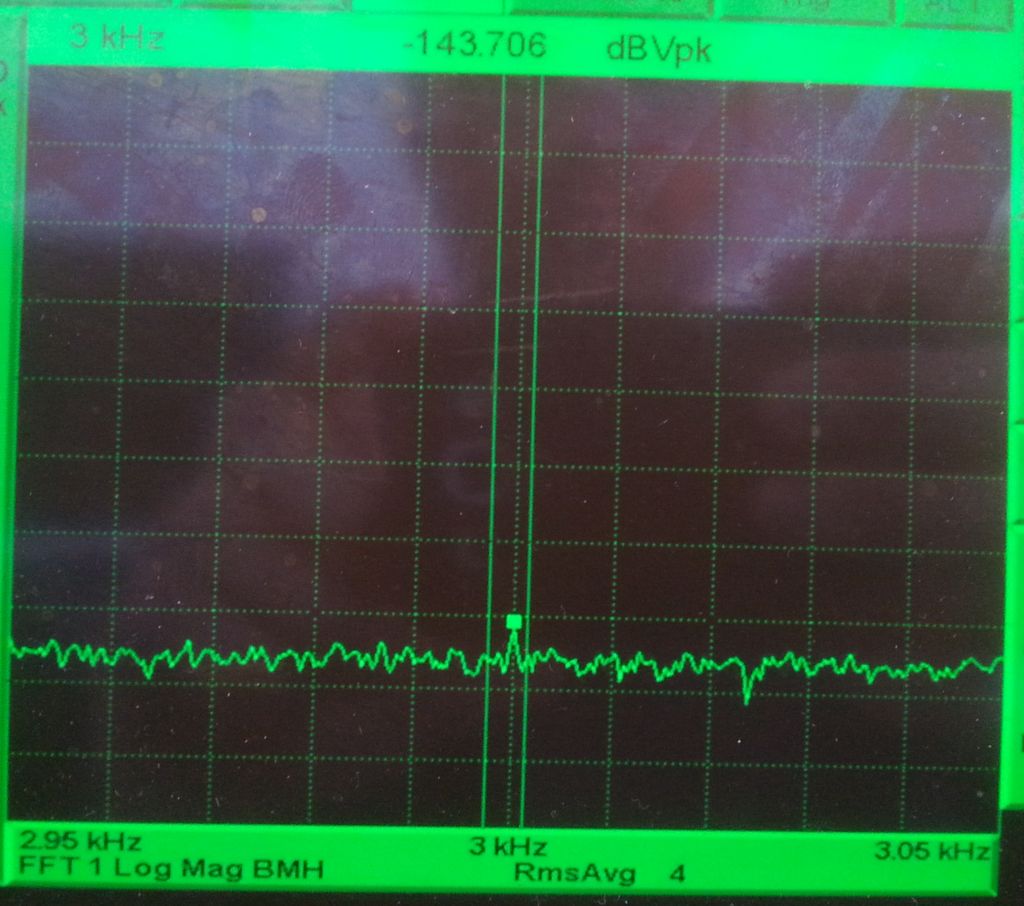

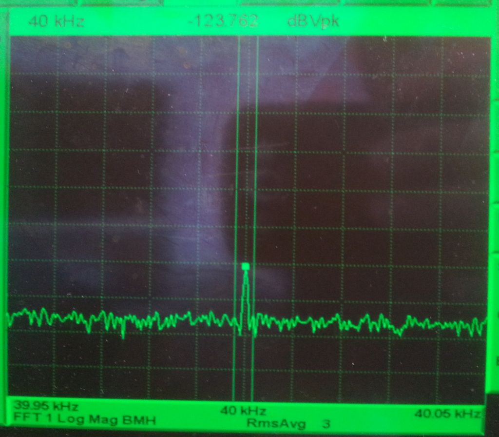

Driving 3Vpk(+9.5dBVpk) into 56Ohm load it has THD around 0.000025% for 1kHz and something like 0.00006-0.00007% for 10kHz, see screenshots attached.

Sergey888: That is a seriously good bit of point-to-point wiring work! Very neatly done. I've done a lot of point-to-point wiring on perfboards with IC sockets but never have tried right to the chips like that. Did you score the copper clad board yourself to break it up into those sections or did it come that way?
Yeah. It is very easy to do using just a scalpel blade and a ruler. If you want to go brutal use a bayonet 🙂
Well those THD results are very encouraging for the ODA amp with the 6 NJM4556A sections in parallel.🙂 At 56R load you would have around 10mA peak per chip section, well withing specs for your NE5532's.
Actually I was truing to made somewhat different point. I was trying to show that using literally the same components, but reorganizing feedback, it is possible to achieve significantly better results. Just using parallel opams, like it is done in O2, is very hard or impossible to get THD that low.

If there is an aim to get lower distortion, LME49990 is not the only option. It is possible to significantly improve an opamp linearity just adding some gain afterwards. Working with small(er) signal makes opamp more linear. The logic is simple - the lower output voltage swing - the lower current input stage should provide to recharge a miller capacitor. Lower current from differential stage means it works on the shorter section of the transimpedance curve, thus it is more linear like.
It will be easier to implement this if you ditch the idea of multiple parallel opamps on output.
I do not share your obsession with dual mono thing 😀 You can get very good channel separation using proper layout technics.
If you remember, a while ago i was showing one of my designs where I was getting less than 0.1ppm distortion driving 3VPk into 15Ohms at 1kHz, which is <0.00001%. And it was much better with higher impedance loads.
