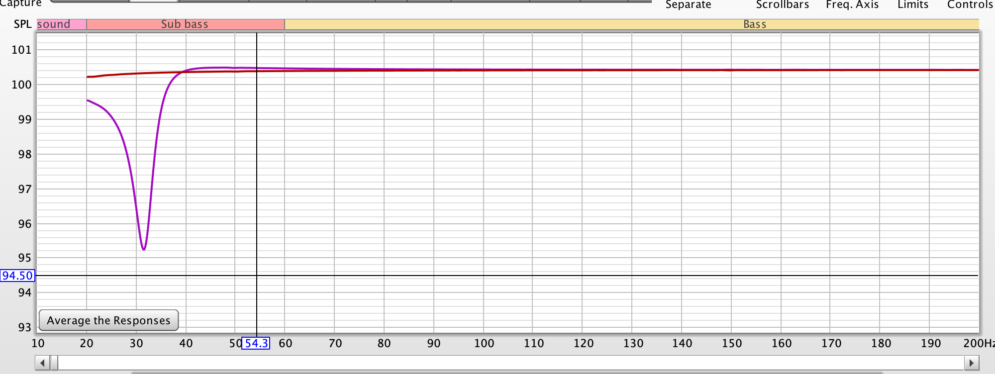

well so I have got a behrigner audio interface and am testing the filter as an input output loop, I have to get more experience with REW, to know what I am really gong tbh, BUT I got this out last night. Strange no second frequency notch as per the circuit.
I will calibrate the card and make more sense of everything - the 2 plots compare the PP3 batteries connected and not connected.

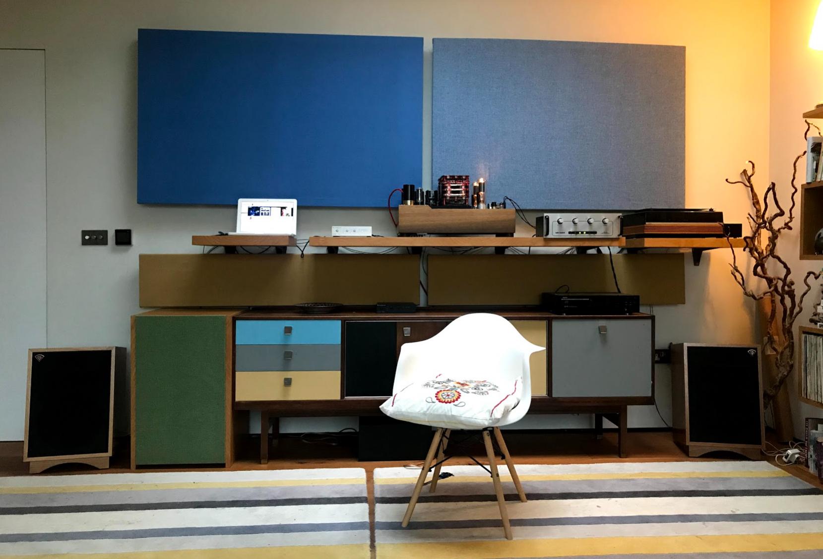

Also moving the sub is not really a viable option if the room is used for other purposes (it is) see image it's 137L and made of 25mm plywood so heavy and big. It has a green grilled to the left of the cabinet in the picture.
