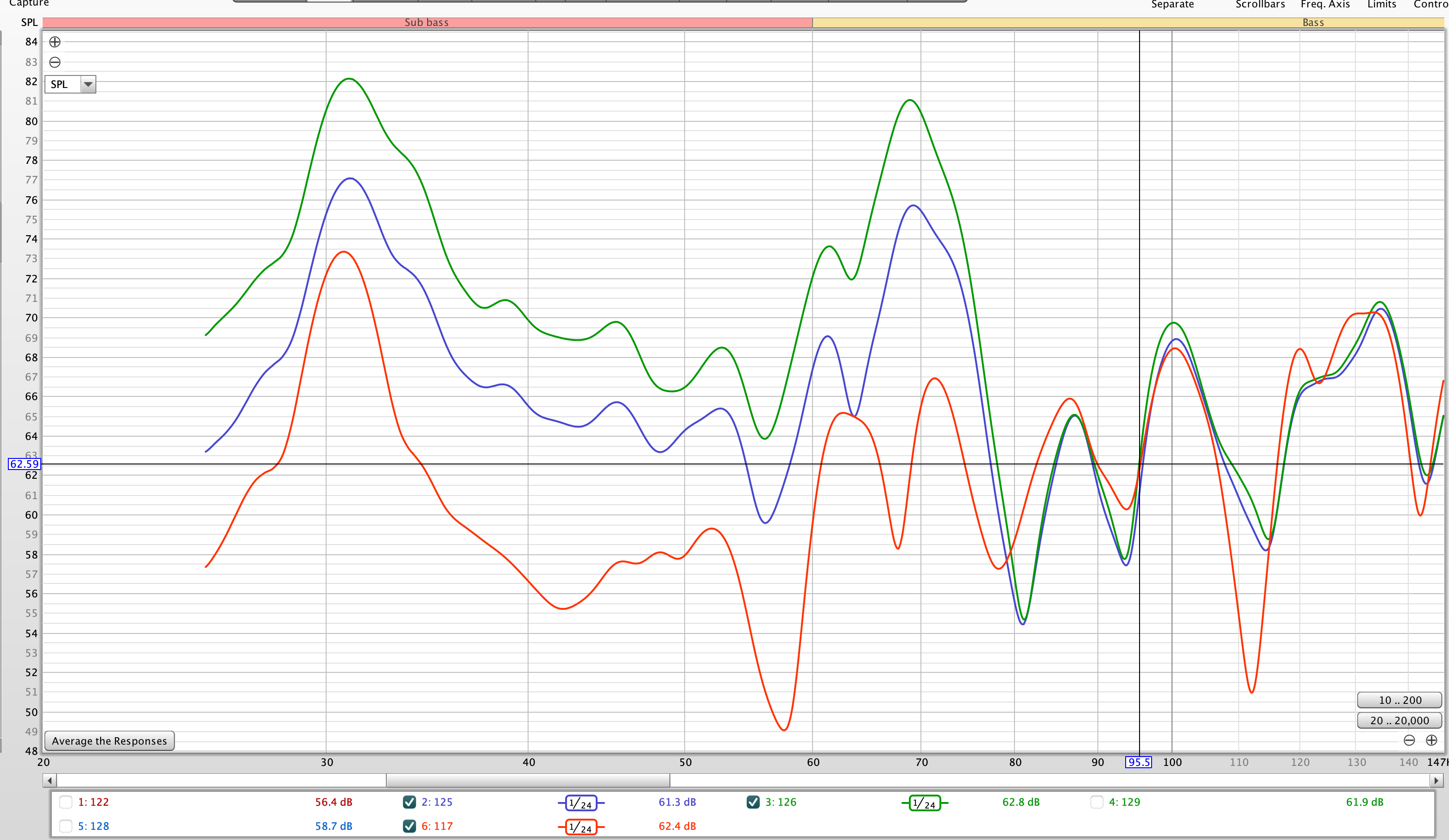

the alternative is yeah sort the room, but moving or adding subs makes small differences but practically will not resolve things properly at 31 Hz according to REW room simulator.
also the assumption is a dsp is not as nice SQ as active filters
The green and significant peak is the subwoofer with the mains. all the others are just the mains.
Great to see that kind of more in-depth analysis. Now we can get started.
There are very great variations when you try moving the sub around. Once when we were redecorating the music room and it was fairly bare, I did 14 locations around the working end of the room.
So, I'd see what the "green" trace looks like in some different locations for the sub - including for test purposes weird off the wall spots.

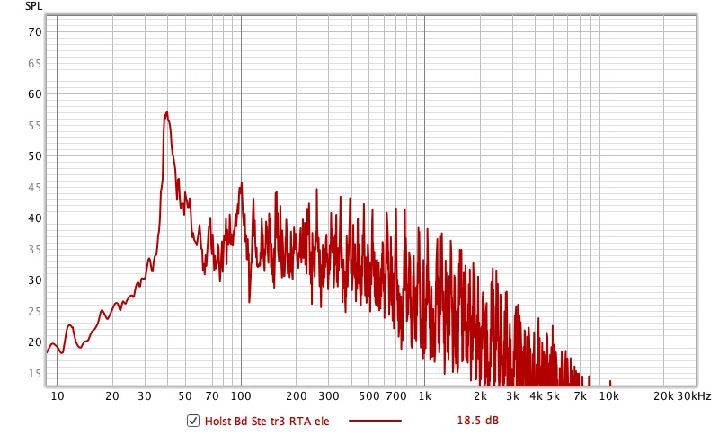

In truth, movies and organ enthusiasts aside, there's not much on recordings below 40 Hz. Even the big orchestral side-drum doesn't need lower capability. And if you can live with occasional booms, life can go on. I'd focus on the dip 40-60.

Here's the stupendous loud side-drum in the Holst band suites, track 3 (Hanson, Rochester). Some would swear it the greatest bass on records.

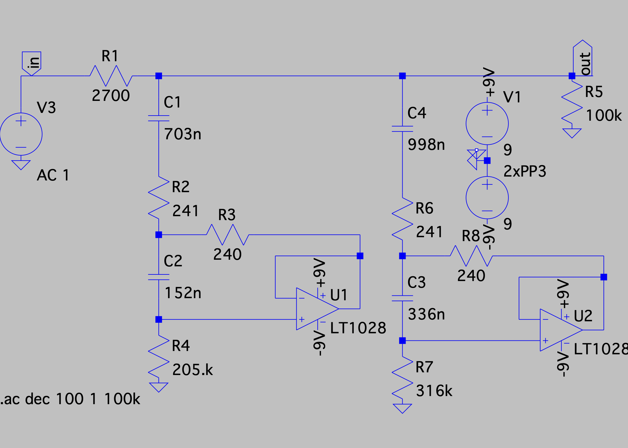

ok - so I have made the notch filters as per the circuit here attached and the results are sort of inidfferent to frequency, just like turning the sub down...I am sure something must be amiss - any ideas.
Oh and the bass sound quality is like someone moved the bass to a house down the street made of cotton wool and left the window open......
The REW plots show
green my normal sub position with no filters connected.
blue with filters on with active circuit
red no sub at all.
seems like the R! 2K7 slugs the output and the circuit I have made somehow does nothing.......
any ideas?

Not sure the circuit makes sense to my eyes.
Wouldn't it be a simple matter to plot the amp output with REW?
What does "no sub" red curve mean? Shouldn't there be no output down there?
And finally, for $150 you could simply buy a Behringer DCX2496 on eBay and fiddle for hours, dialling-in any notch you want.

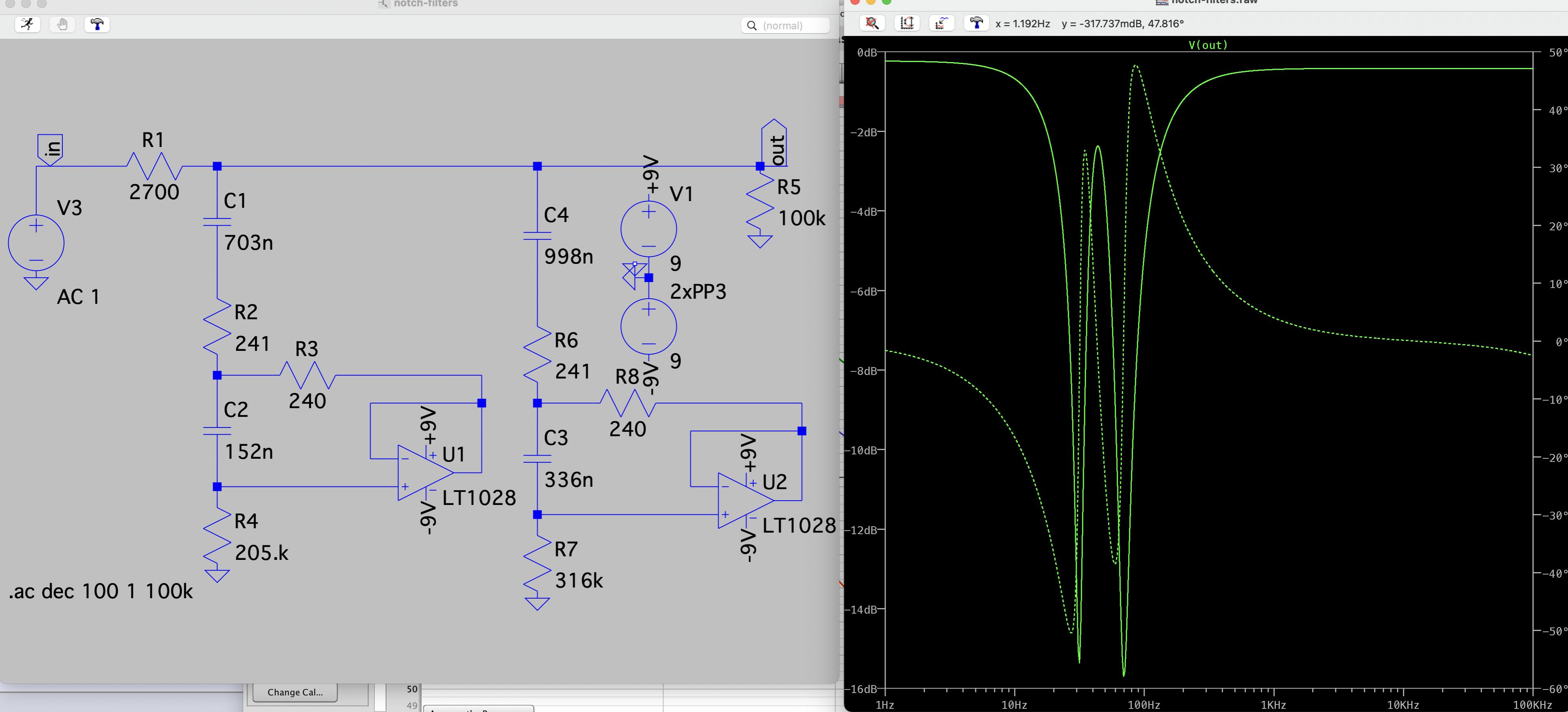

Sorry for any confusion
The circuit output plot is as attached and represents the filter performance as a notch.
The green red blue plots are REW with a microphone seeing what effect the notch filters have on the subwoofer, which is where they sit (in between the sub preamp and power amp)
The red is the sub turned off, the green is turned on and my normal chosen position based on listening; the blue is the amp turned on with the active filter in place.
