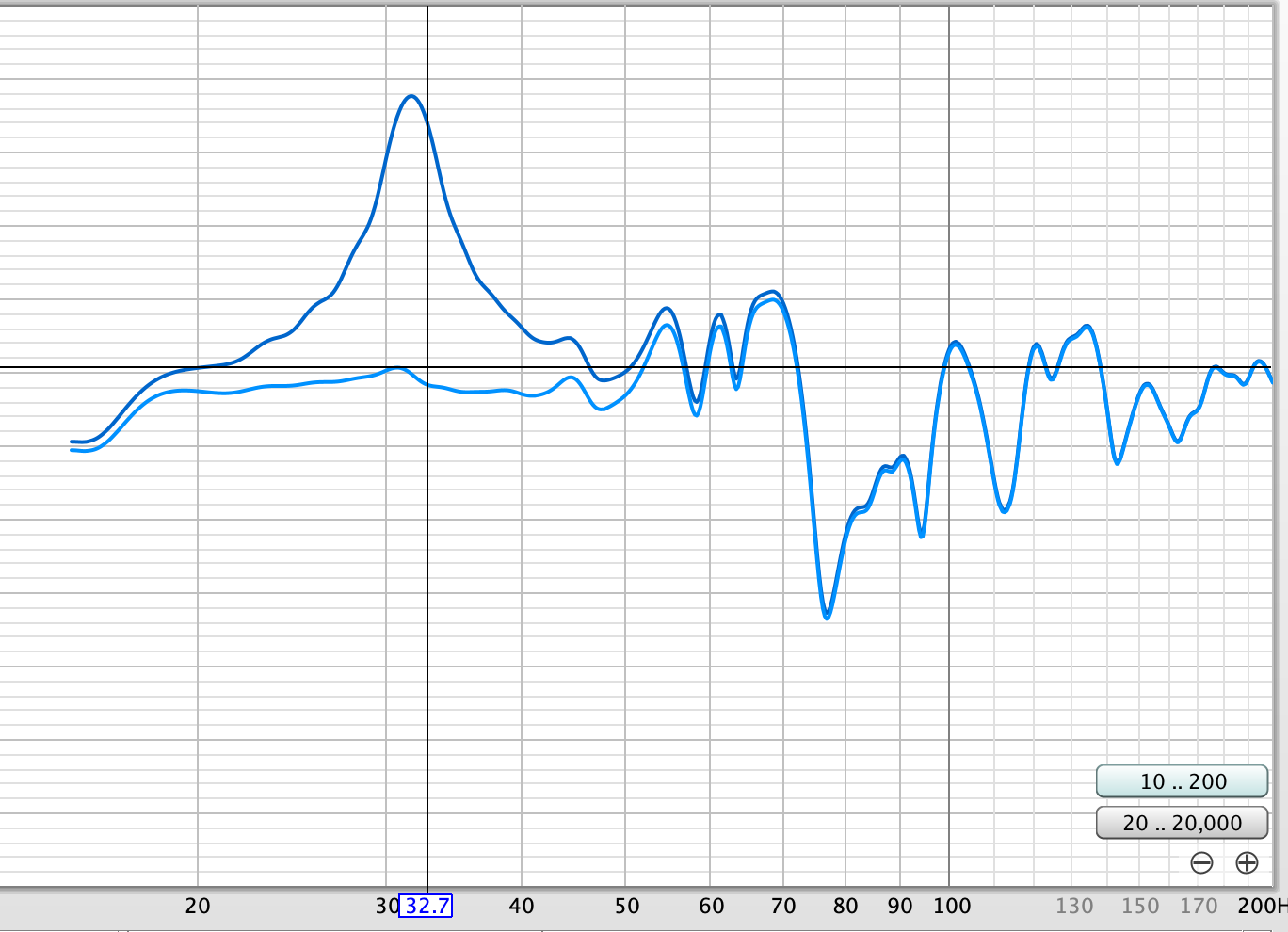

I have a subwoofer 15" I made myself and use a BK sub amp, and want to reduce the quite dramatic room mode that is created.
I prefer the high level (signal from power amp) sound and am not that keen on using a DSP. I have an in room measured with REW software and can see a good solution for a high Q [5] notch filter at 32 Hz BUT how do I best make one?
The plots on REW are from a measured in room response and then with a filter added at 31.8 Hz at - 20 dB with a Q of 5.

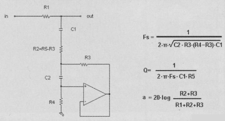

You could build this filter.
I have used it very succesfully in my system to suppress a few room modes.

Great -
Which one did you build? A, B or C

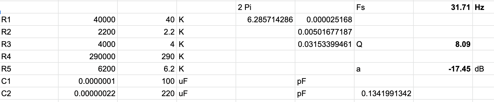

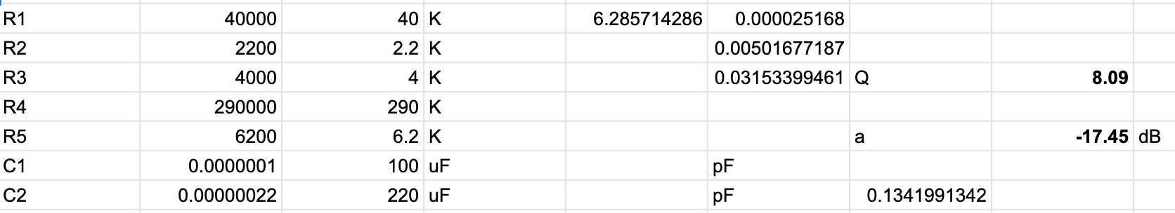

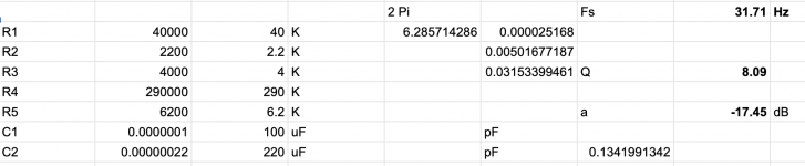

This one.
Fab, this is the model I have calculated the notes attached. That would work to get rid of the room mode mostly. I will keep noodling

Yeah, I can do that I just don't know how to iterate to the right values without pure trial and error - guess I need to rewrite my equations from the frequency as a known etc.
As ever, everybody is fixing with meticulous deep thought a problem that isn't defined.
The FR plot makes no sense to me. Something is wacky and it isn't just a room mode causing the bump.
B.
The room is 5.39m wide, 5.58m deep, and 2.95m tall and if you estimate the room mode in REW simulation it's pretty much at just over 31Hz ?
Near square rooms are of course worse for room modes.
Could this be something else, the 31 Hz is still a peak without the sub?
