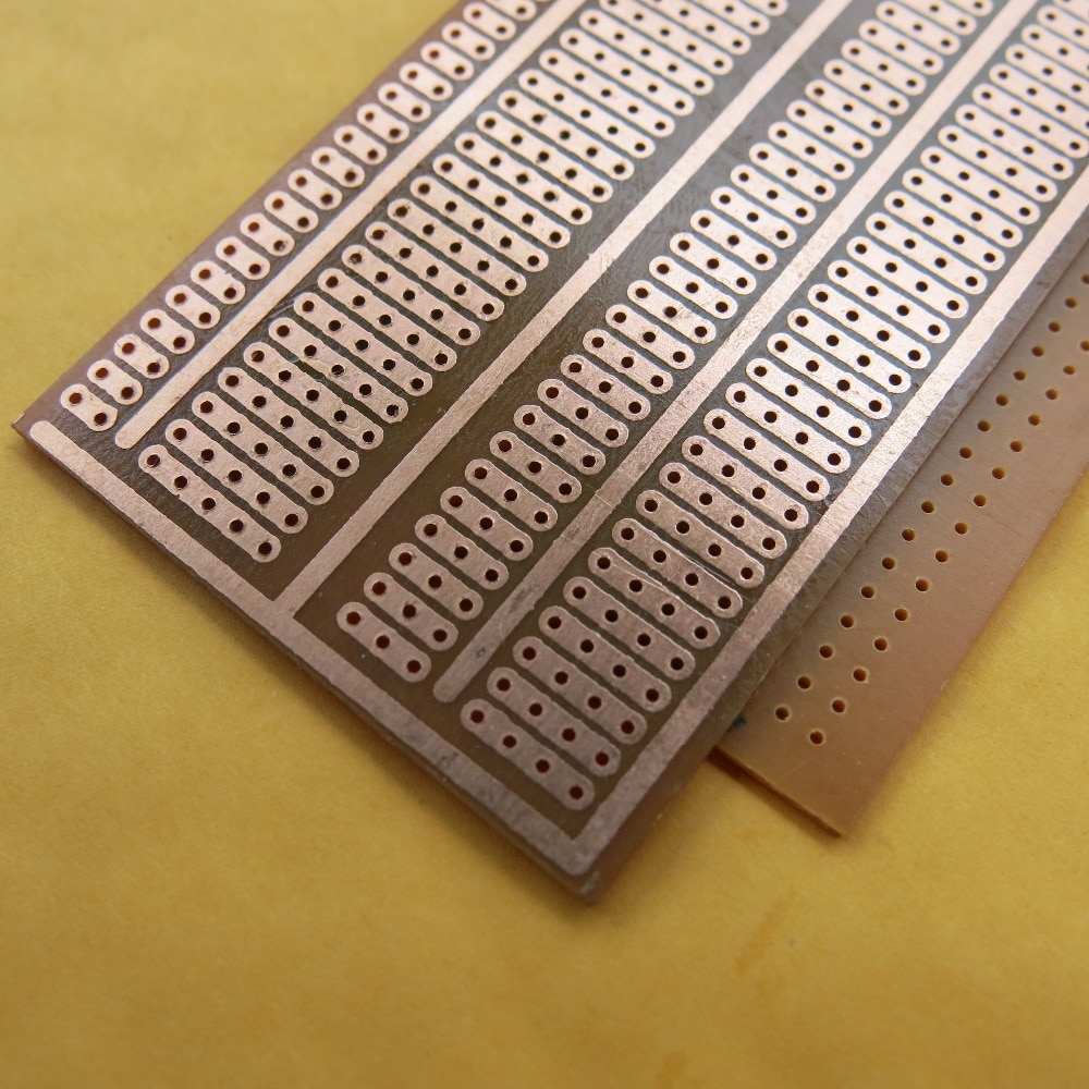

Like veroboard/stripboard..

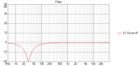

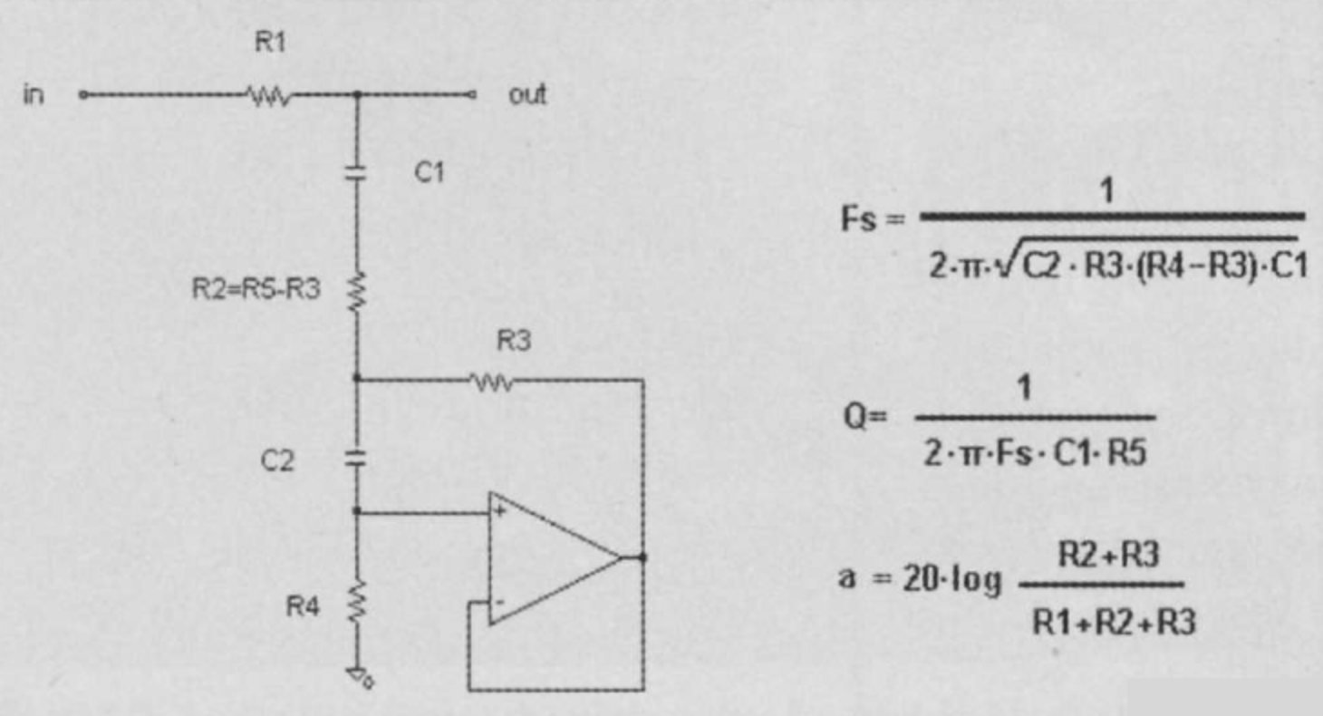

A quick and dirty gyrator with component values done with VituixCad.
The values have been Fo= 31.8 Q= 5.0 Peak=+20dB
If you post the REW unequalized measurement file, some further optimization may be done.

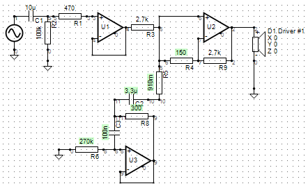

I want to have a filter with a gain of about 7 and Q of about 1 at 18Hz.
The active notch filter model was great as I could play with values to achieve what I needed for cutting resonant modes, just be great to add a lift with the same adjustability/flexibility?
Anything goes circuitwise, but I am afraid I have lost you (or vice versa..).
For starters: could you post the uncorrected REW measurement file? If that file can be used as a basis for the sims, basically any analogue filter with a Q until 20 and no more than a 20 dB dip can be generated.
What exactly is your target?
As an alternative: work out in full the corrections you need in REW. Post that correction file, so I can use that is an optimization target. Converting that file in to a RC value-optimized working analogue circuit is not much work from there.

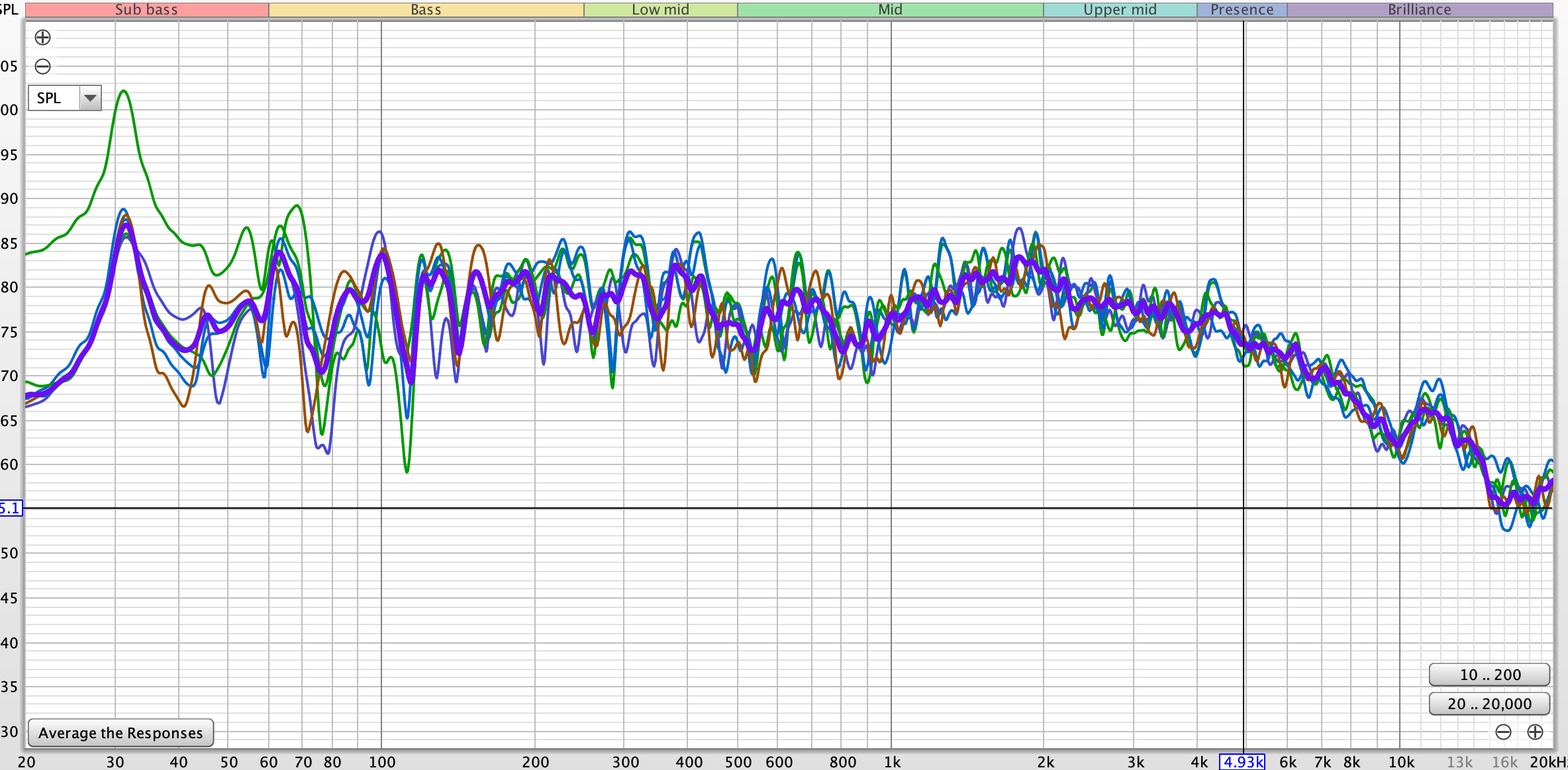

Hi, stepping in as I took the measurements and my brother (Tonescout) will be getting a suitable mic shortly to take his own recordings
As the sub is working in parallel with the speakers it will be understanding how the cut on the sub works with the mains to combine successfully, I wasn't able to measure the subs only as he was driving from the high gain outputs (power amp). It will require work with a digital solution initially to see what is needed then build the analogue version I suspect
In essence the cut will depend on the sub adding very little to the room node as nothing to control the mains (EQ)
Here are the measurements of the mains only across the seating area and averaged I have added the measurements with the sub working in the MLP sub turned on (green)
I have yet to look at phase, doesn't look too bad but I note that around 115 Hz the mains and sub are working against each other, so he will be needing to cut off the sub sooner beyond 80/90 Hz
The overly aggressive roll off at higher frequencies is being investigated

Is it my imagination or does your plot show just one location with astonishing 30 Hz peak and all the other curves nothing nearly so bad?
Not bad to have some bit of rumbling if it is down low - say below 40 Hz. But this room seems to show a rather bad hole just north of 30 Hz.... which can't sound good. Nor can just sucking power out narrowly at 30 Hz result in anything like satisfactory bass - even if it has superficial initial appeal.
For the moment, really a need for closer examination of speakers, locations, etc. Always great to have or borrow a Behringer DSP (its cheap) and try dialling-in various options, if only for testing (not sure why you'd ever take it out of your system). I am not optimistic about that room (esp if there are concrete floor or walls).
B.
B, hi
The green and significant peak is the subwoofer with the mains. all the others are just the mains. Yes the 31 Hz peak is the room node due to the relatively equal width and length and energised by both mains and subs. Looking at the REW sim, not a great deal placement can do to improve significantly

Looking at the calculator I have made - the 20% tolerance on the capacitors means I will have to select from samples to get the Fs correct.
