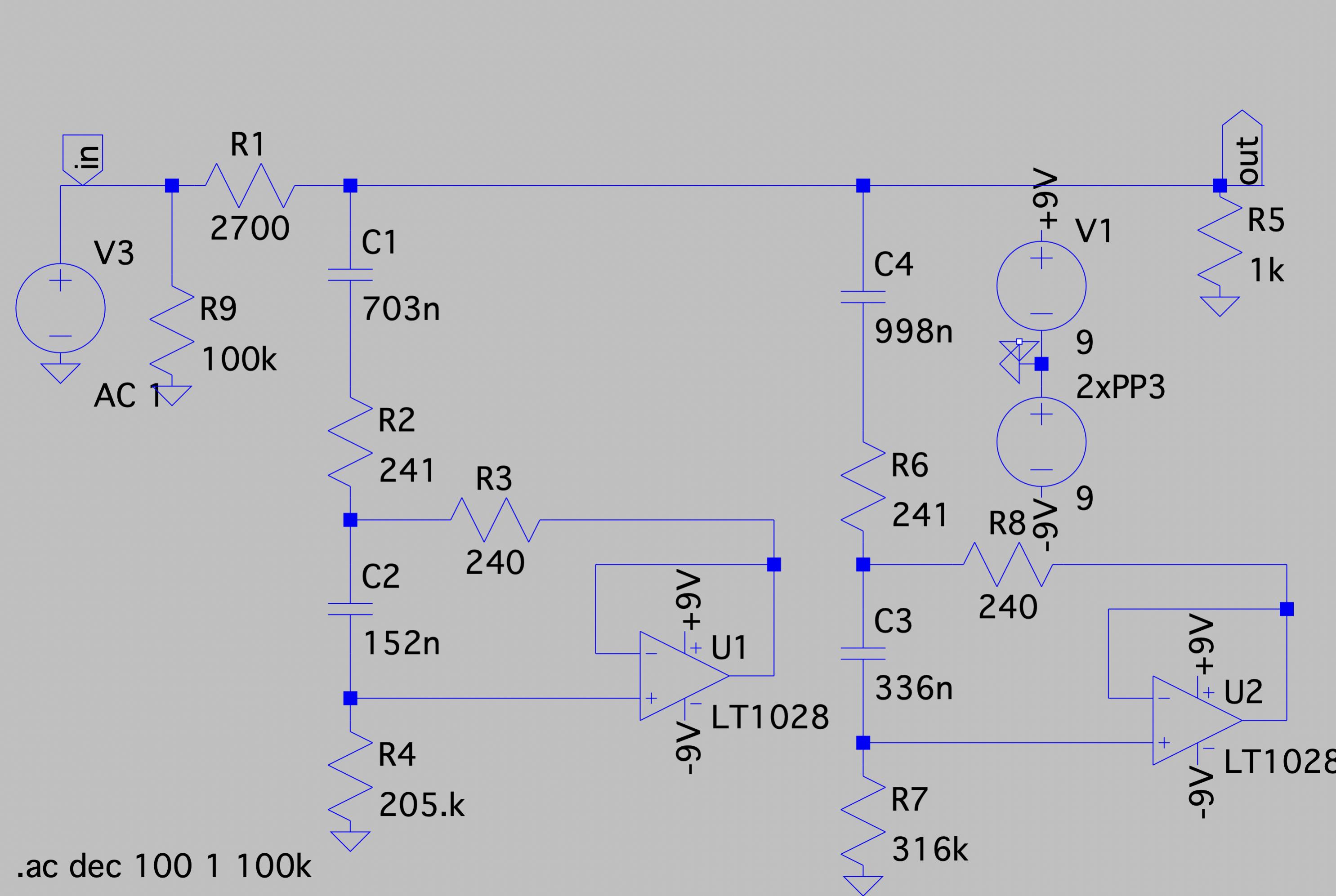

You could build this filter.
I have used it very succesfully in my system to suppress a few room modes.
Active Filters
Any ideas why there seems to be little effect at specific frequencies?
I am thinking i must have built it wrong somehow>?

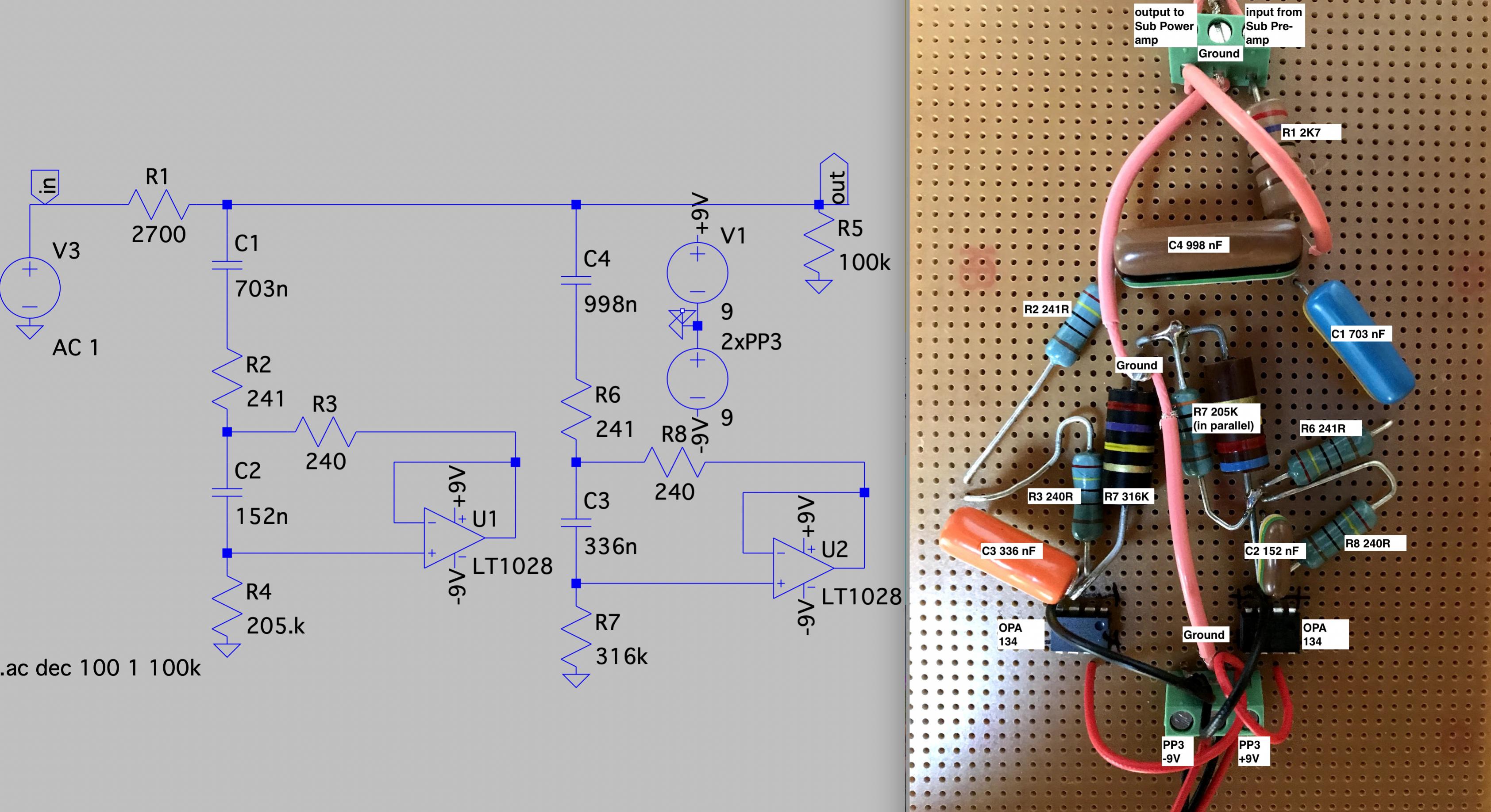

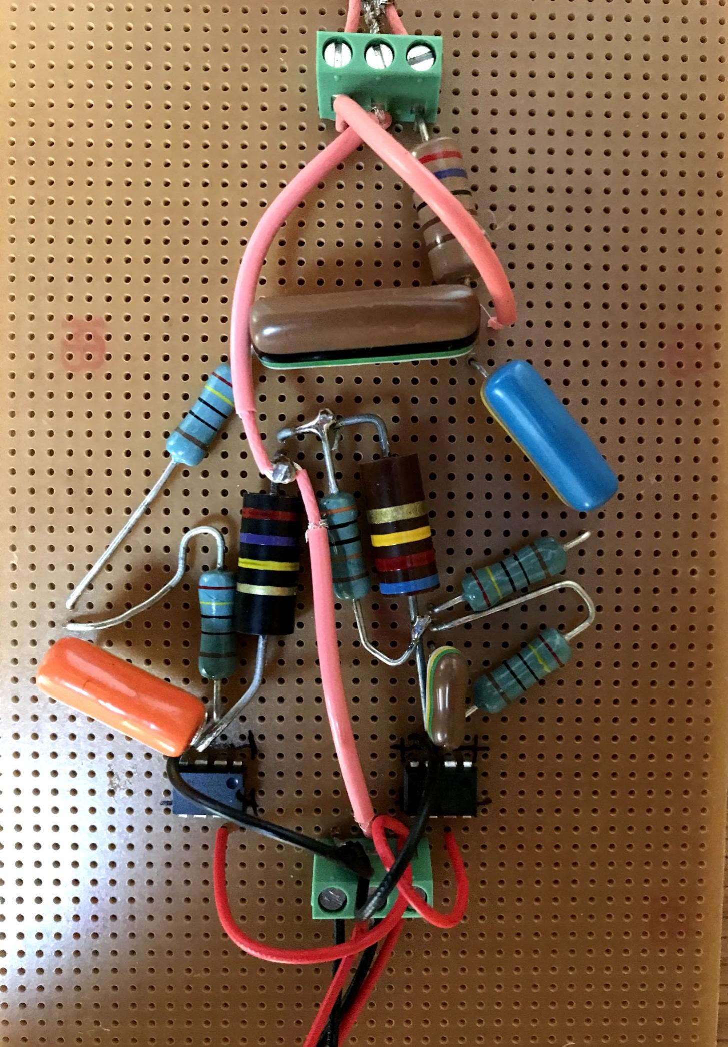

The sub power amp internally has a lead that connects the preamplifier board to the power amplifier board and I have put the filter in series in between.
I atm only have facility to 'listen' to the speakers through REW and a microphone, but the trace shows that there is not any attenuation of the notch frequencies / my thinking is I have made some error of the notch filter itself?

You really should have a buffer before and after the filter
It is possible that the pre-amp has a high output impedance which would add to your 2k7 input resistor and mess up your calculations. It is also possible that your sub power amp has a (relatively) low input impedance causing a general loss of signal, swamping the effect of the notch filter
In your sim, you have the pre-amp output impedance of zero, and your power amp input impedance to 100k. I doubt that either of these is correct

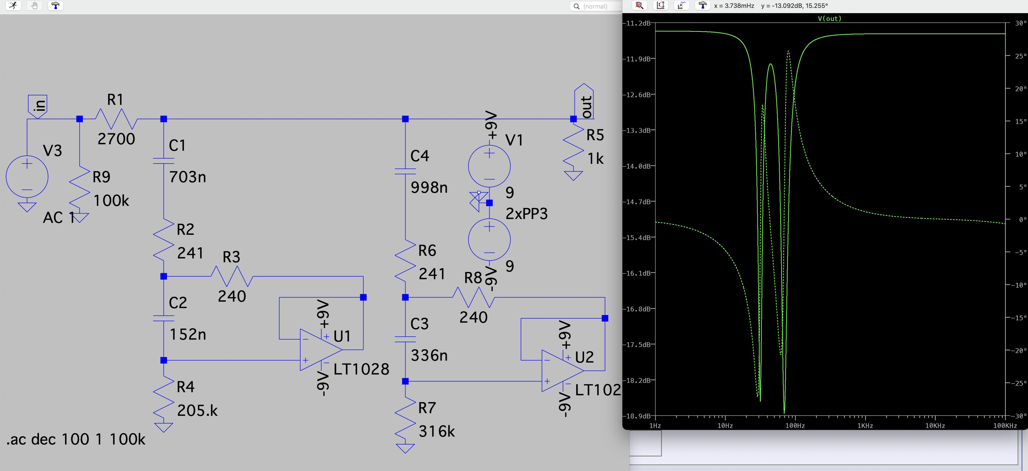

If you run the simulation with an additional input impedance and play with the values of these at input and output, gain changes but not the notch frequency.
Yes, but still it is possible to measure the frequency response at the input of the mains speakers.
How do you do that - something like this?
A DIY approach to distortion measurements for audio amplifiers – (mis) Adventures in Hi-Fi
Yes, I see the following:
1. You should use buffers at the input, between the two notches and at the output.
2. You should use also a resistor similar to R1 at the second notch.
3. A good buffer can be build with OPA2134.
The simulation always matches well with these kind of filtres.
