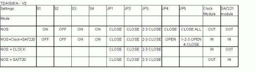

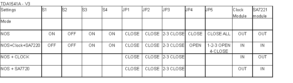

Hi folks,
I also had trouble getting the clock board working. I found that JP4 needs to be changed too.
In summary for NOS with clock:
JP1 short , JP2 short, JP3 2-3 short
JP4: open, JP5: short
S2 : 1 off, 2 off, 3 on, 4 on

hi feede, kip & ashok, all the qestion check already.
I will fnis the chart & told U how to work to night. I will test all now.

The clock was 11.2896 with 4X for SAA7220P/B.
If U connect the JP4 U must remove all the two small block. If not connect the JP4. U remove the 7220 will be OK, connect all the JP5.
than t will work, if U remove the clock with the 7220P/B U must connect the JP4.
pls remember the Mo of the 8414 need adj when U change mode!!

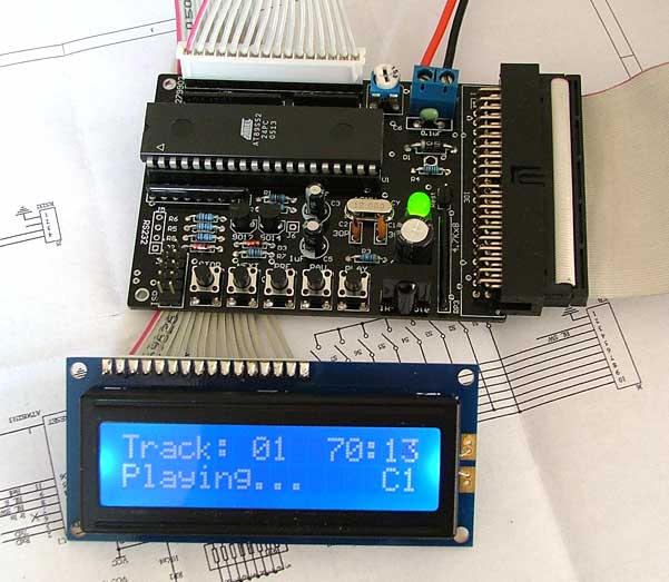

Hi Thomas,
On the latest picture (just above), all playing button are on the main board from the CD controller. It was not the case in previuos pages from this topic (cf picture under)
I take your kit for these reason. I have a Pradit Kit to that has all button and controller on one large board, and it's less comfortable for sweet chassi building as extra button pcb as shown on your picture above. I really appriciate this solution if you can. My chassis has a max internal height of 55mm.
Marc
