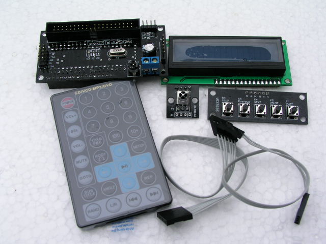

Hi Thomas,
That is everything I received in my cd rom controller kit.
I purchased an Asus model CD-S520/A5 with a digital out. Hopefully the new cd rom drive will fix the communication problem and the digital out from the new rom will work great with the dac ver.3. I don't think the cd rom controller has a digital music connection to the dac. I will keep my everyone posted.

my encounterment with the CDROM kit. The Cdrom i use was an LG 52X CDROM.
1) Only Play button doesn't work. I think it's not supported on my CDROM or it could be wrong somewhere. I did try shorting it to see if it's the problem with the button, but no success. But remote works can i can hit play from remote.
2) if u press on the button too often, too much times, it will hang and stop responding. Will need to turn off and on again.
other than that it's good 🙂

ops, i was suppose to do the documentation for this DAC n CDROM kit, was just too bz this couple of weeks...

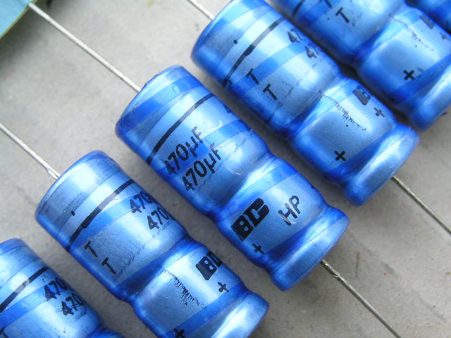

This is almost the best caps & previous will only use in Marklevision or krell products.
Every cap was 40v 470uf. Every DAC need 470X32pcs. bu it really good.

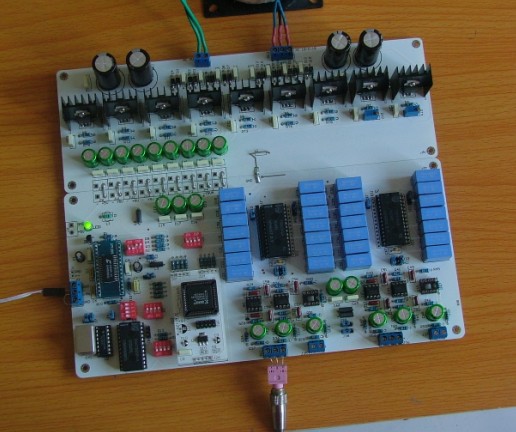

hi,
within two weeks, ultimate ver.3 will arrive my hand.
total will contain (7) pcb's,all were fully funished & test, can directly plug & play. Will follow with output transformers for real balance output stage.
This is seven PCB.
1. improve low noise power supply with all LM317 & 317, solve the old ( non-profit version U4 too hot problem).
2. DAC board, all the tda1541a, CS8412-IS ( NOT 8414), SAA7220P/B, RE-clock & Op sockets was fit in one PCB, will not use adapter, gurantee better contact more stable, lower noise.
No.3~5 PCB---Signal selection Board. totally contain three PCBs.
First PCB was the source input jackets PCB.
Sec PCB was the source input PCB with individual input, special was the seperate balance input with individul nano-amorphous pulse transformers input. totally had ---RCA, BNC,TTL,Balance input. All input was control by MCU & selection by relay to prevent cross signal. All the relay use NEC parallel relay , made in japan.
Third PCb was the source input indicator PCB ( use LED) can upgarde to LCD display. Use MCU to prevent the click sound of the power supply & selection of the source input.
6- Diyers can choose The CM106L or PCM2906 USB receiver Module for the signal selection board.
7. Parallel (another TDA1541a ) PCB which diyers can choose running in single or parallel mode.
8. Same as the non-profit version whcih can running in three mode which was setting by jumper.
9. Use small (1X1.5X1 inch) pre amp output transformers for the balance output which can setting from 150ohm to 600ohm.
10. The tube buffer PCB also coming..
This is all the contain of the ver.3 ultimate ver. 1541a

Hi Thomas,
Sorry for taking so much time, but I am very busy at present.
Thank you for the S2 chips, they arrived safely ready for the balanced 1541 dac.
I worked on the non profit version, and I ended up with a 22 ohm 5 watt resistor ahead of U4. That helps and U4 is running cooler now. Of course the 5 watt resistor comes very hot, but that is its job. I put it away from the pcb or other components.
This alows me to work the dac with the interpolation filter, what I could not do before due to the intense heat that I could not dissipate even with a larger heat sink.
I also changed the power transformer and used the one you supplied. It is very good and I like it a lot. However there is no way I can parralel the two primary windings. So I use only one in the primary and it does not heat or drop voltage, even with the full load.
