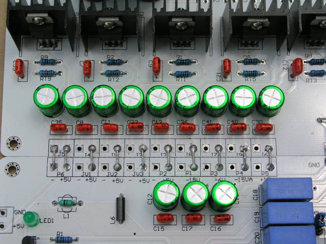

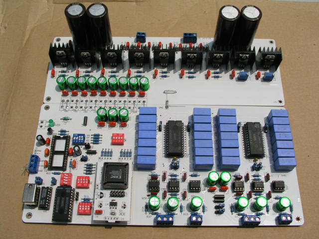

hi all ,
full balance of 1541a arrived.
take a look.
photos show was the sample ---A, B & C was coming!!!
I was testing my new sample 1541a ( Full balance DAC).
This DAC was collect many diyers feedback in this forum & change, layout, ground, parts choice. Now was try to search a low jitter XO or VCXO to further lower the jitter of this dac. Any comments to improve more????
This toy, I thought full balance may be the ending of the 1541a chips.
any comments were welcome because I hope this will be one of the best 1541a in diyaudio.
thx
thomas

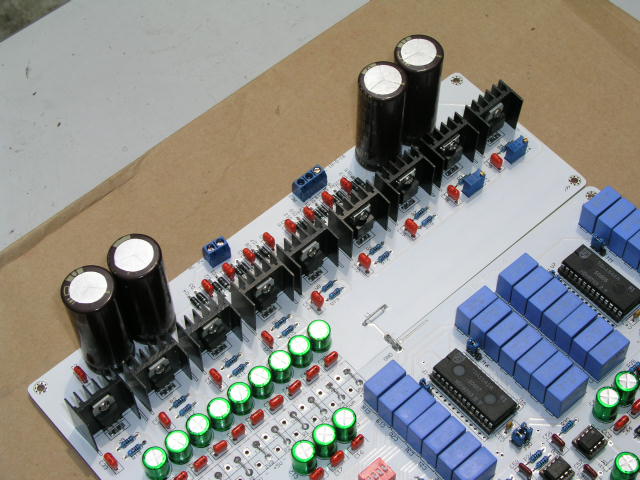

take a look.
thx
thomas

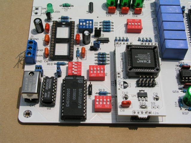

more photos.
digital signal pass the 7220P/B & use XC9572Xl ( CPLD) to seperate
left channel (+ & - date to left channel 1541a) Right channel (+ & - date to right channel 1541a chip).
so this will be veru good for previous diyers which buy two chips.
thx
thomas

Hi Thomas!
The dac looks nice. Confirm that each channel has the balance output n single ended output as well?
Cheers!
Eddy.

hi eddy,
this is the first sample.
another two was coming. I need to test more & this is a full ( real balace ) dac, It had 4I/V so why every channel use two 5532 & one 5534 output.
SE every channel will very easy to change.
Next I wil try to prepare 4 SE output trans for the balance.
This will be same use two SE OPT & working as a PP OPT, but SE trans had airgap. sec harmonic will rich. I hope to try this too.
Btw, every dac ( balance) version can totally working with 4 chips. U can choose paralell two chips (every channel one chip more) & running in Full balance & full parallel DAC. I thought this may be the final version of 1541a DAC.
Power trans ( isolate one) will directly solder into the power supply PCB, will not same as this. Every dac will contain two power trans. Less cable will looks clear.
This dac will same be fully test fully funish & willse CS8412-IS.

One point of feedback on the new PCB. Why are the connections between the main PCB and supply PCB so close together? I think it would be better to use the whole width of the board, like with the first design. This way, the path from the regulators to the DAC chips is not longer than necessary!
Fedde
ps. But I will stay with the current version anyway, satisfied for now!
Fedde

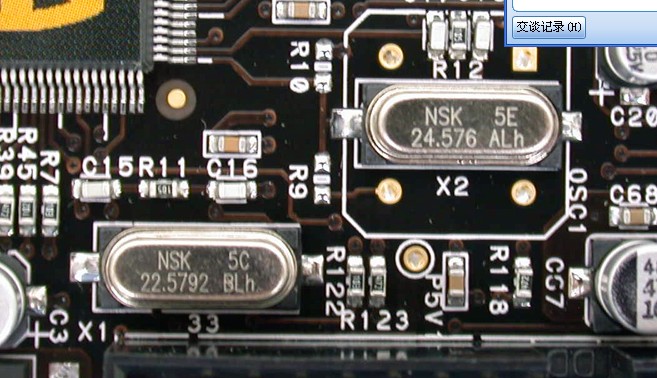

hi,
NSK email arrived already.
Hope stefanobilliani will love this Osicillator.
Detail technical information will inform later.
new ultimate ver.3 1541a DAC will supply to market on 2006-09-20.
All were fully funish & test.
contain.
1. Power supply PCB with 9 section of power supply with two PCB mould isolated power transformers, one for Dac, one for USB receiver!!
2. Additional power supply board, during parallel two TDA1541a chips, I was afraid the power supply may be will little unstable, so additional one power supply board for the extra 1541a chip PCB Board.
3. Extra 1541a ( one chips ) which an parallel to the first chip on the main PCB.
***( 28 pcs of the couplingcaps of two 1541a will close match as the non-profit version)***
Caps will match in 0.095~0.099,0.1~0.115 two groups.
4. Source input selection board, Use MCU to control the the switch click sound, relay switch for the source input.
source input had 1. RCA. 2, BNC. 3, TL ( for CD-Rom) 4, Real balance whic seperate to the SE selection , there will total two nano-amorphous pulse trans fit into the source input board.
5. MCU control with selector & indicator on the facelet( stadard was theLED, later can upgrade to LCD, I did ot suggest the VFD one , worry about the noise.
6. USB receiver use PCM2906.
7. two output transformers which can select the output stage 0~150~600Ohm or real balance output. Also had op-amp output two. later will optional 5687 tube output stage for diyers connect the op-amp to tubes buffer. Also can connect to the pre-amp output too.
5687 will use HV working volatge, since I did not like the low voltage such as the LV 6DJ8. dynamic not good. 5687 tube cathode follower buffer, every channel use one tube. I had many 1959 CSF (made in france ) military
8. Oscillator will low jitter which was 5ppm & OEM by NSK (japan) no photos now, will post later.

photo show the NSK oscillator on the japan hi-end cd-machine, ver.3 ultimate will use VCXO.( USD 26 per one). not this cheap one. VCXO will low jitter & 5PPM.
since all the parts was almost the the best in the dac, fully funish & test, with USB receiver. Re-clock was low jitter,so the price will
