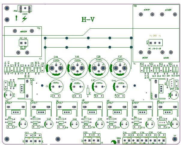

this is the new power supply jmep image of the PCB.
improve stefanobilliani advise,
the ground loop was improve more, relayout all the ground area in the [power supply area. I use 96db speaker full range & 94 db ( TAD speaker) & test low noise. The original also no problem in normal speaker. Only high efficiency will little noise.
1. New layout of the power supply.
2. increase the capacitance of the caps before the diode from 3300uf >>>>4300uf+0.1ufMKP ( 3300+1000+0.1MKP). or if diyers still like to increase more. (3300+2200+0.1ufMKP)
I was so sorry that if I use too large capacitors te sound will little lower. or I will advise paralell two 470uf on the 3300uf & 1000uf caps. ( use BC philips & test good)
I use ,my friend with 2X15inch woofer & horn(2'throats to test)& alnico tweeter for more dynamic sound & noise, over 97db.
If the capacitor was too large, the sound will little slow. So if U heard classis & more dynamic music will not so good.
3. All the isolated power transformers was mould into the pcb. approx no cable seen into the dac.
New power supply test in high efficiency speaker with quite quiet.
will supply to market on 2006-09-20.
thx

Hi stefanbollini,
I have tried your suggestions to get rid of the noise in the dac, but there does not appear to be a difference in the noise I can hear. I'm testing this with my headphones on, to be a bit more accurate. Anyway, if I understand you correctly, there are three grounds that needs to be disconnected. On the main board it is at J80, J24 and J75, correct? I have simply bent the long pins a bit so that they do not plug back when the board is re-inserted. Has anybody else tried some other methods? I have tried asking Thomas for the schematics, but he does not appear to want to give it to us, so I'm flying kinda blind here...
Any help would be appreciated.
Gert
Gert
