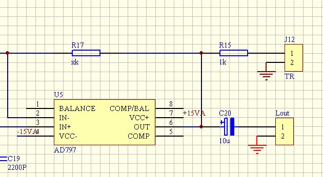

BTW, the funish ultimate VER.3 1541a DAC will supply to arket on October.
Since I source a supply had NI-PC EI 80% Permalloy lamination.
I will optional for USER choose this or not.
Ultimate Ver.3 can use 80% Nickel permalloy for it will very good.
pls see the connection between OP-amp & Trans.
thx
thomas
hi,
there will had two choice for me, any advise.
NI-PC EI 46 80% Permalloy 0.18mm lamination.
NI-PB EI 46 50% Permalloy 0.2mm Lamination.
size of the OPT EI 46X36mm.
since the small OPT had air-gap & can running DC.
1:1 OPT running for AC signal only. Look's the 80% will better.
But I hope to collect some advise for dyers.
Standard OPT follow with the kit will use Z11 EI 0.3mm laminations.
Taiwan OCC wire.
Price for the 80% Nickel. + USD145 per pair with the dac.
Price of the 50% Nickel + USD115 per pair with the dac.
This is minus the standard OPT which was use Z11 laminations already.
All were furukawa Riken wire.
Looks AC signal 80% Nickel permalloy for it will beter. More sweet sound.
pls advise,
thx
thomas

hi ggta, Areman, raikkonen:
I must test in very safe.
Three version which one will be better.
sinceI use program to seperate the data steam to left channel +,- & right channel +,-.
since the Dac was a real full balance DAC.
Special is the synchronous operate maintain perfect synchronization by program.
I need test longer time, in more test audio set up, now I was testing with electronic horn Altec 9862, 4344, 4343.
This DAC I prepared three samples which I need to test their performace different .
a. single regulator.
B. slunt regulator.
c. Parallel caps for power supply.
since all the DAC can running in NOS, NOS + reclock & NOS+reclock+DF.
Every chips can parallel or single running too.
I will prepare in full funish & test but will not contain with chassis.
USB receiver, signal selection board & nano pulse xformers will follow with every kit. OPT standard output stage will use 2X5532 & 1 5534. But diyers can upgrade to BC109/2N930 cascode output stage. SE( RCA ) output stage stage will use pre-amp Output transformers to cnnect.
Do U know the power supply also need to test in safe since if total parallel two chips every channel ( total 4 chips) I must test the power supply is stable or not!!!)
Programming chips for synchronization I was testing version two now. Finally this will sepertae because diyers can dupdate.
I need around 4~6 weeks more.
Since the PCb of the 2SK389/BC109/2N930 was prepare the test print only. I need to test.
Finally the op-amp can connect four pcs of 1:1 output trans & rnning in full balance with transformers output.
AD1865 fullbalance will be same too.
thx
thomas
