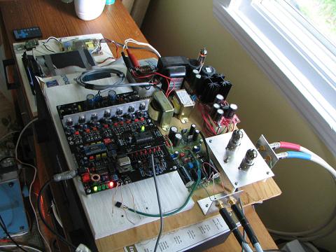

I made a tube output stage for this DAC.
It works very well. No need to envy the Nelson Pass i/v any more.
This amplifier delivers very good sound with solid bass and a lot of sound stage.
As with the Pass i/v, I got rid of almost all the anoying noise I was complaining about.
This is probably due to the fact that both, Pass and mine, have their own power supply and do not share a common supply as the NE5534 op amps on the DAC.
There is a small residual noise left however, but at maximum level only and I have to put my ears on the speakers to hear it.
As a perfectionnist, sure I would like to see it gone, but it would not change anything at listening level. I suppose that the filtering proposed by stefanobelianni would clean it completely.
I wanted to post a photo of my set up, but it is too large and I could not join it here. I have to learn a way to reduce it a little to fit the standards of this forum.
If you have any suggestions, please explain me how to do this.
The Pass i/v and the tube amplifier are instaled side by side, with the DAC on a piece of plywood. I have two different sets of rca jacks with two pairs of cables that are connected to individual inputs on the preamplifier.
This makes easy to compare the two equipments. I just need to switch the input on the preamp and change the small input cable to JP6 on the DAC.

The photo is reduced. Lets try it.
AS explained in post 1102, the dac is monted next to the Pass's i/v and on the outside is the tube amplifier, each with their assosiate supplies.
Jean-Charles

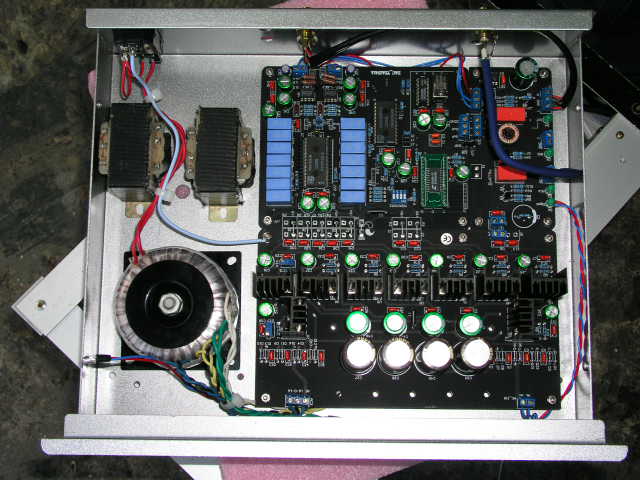

small update of the ultimate ver.3 DAC.
1. AC inlet added filter Tokin ac filter.
2. 5687 cathode follower tube buffer, every dac use one tube only. Tube follow to the dac will Date 1959 NOS CSF OEM to IBM 5687 tube. I test for many tubes, two triode was very close.
5687 was made in France.
3. Op-amp will choose op-627 & 5534 will follow to dac too. since I test it in at least 5 place for different set up for horn & voice coil speaker. In horn set up 5534 will better. If in volice coil set up such as Jmlab, Op-627 will better. so I follow all for them so diyers can flexible to changwe trhe sound stage.
4. relayout to lower the noise & test will headphone to pass the noise level.

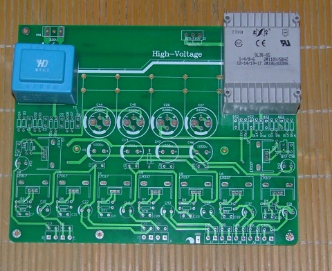

5. Total will 6 pcs of the PCB??
1.1541a DAC with re-clock & IV ( OP).
2. Complex power supply for totally 9 section of power supply to dac. increase the current supply of the Power supply Board which will stable to use parallel two 1541a chips.
3. standard USB receiver was PCM2906.
4. Signal selection Board contain 3 pcs. 1. MCU control source input with relay control 2, MCU control with LED display. Sockets in the back panel.
5. Extra 1541a PCB with regular power supply & coupling caps.
6.All funish & test already.
7. use triode power transformers
thx
thomas

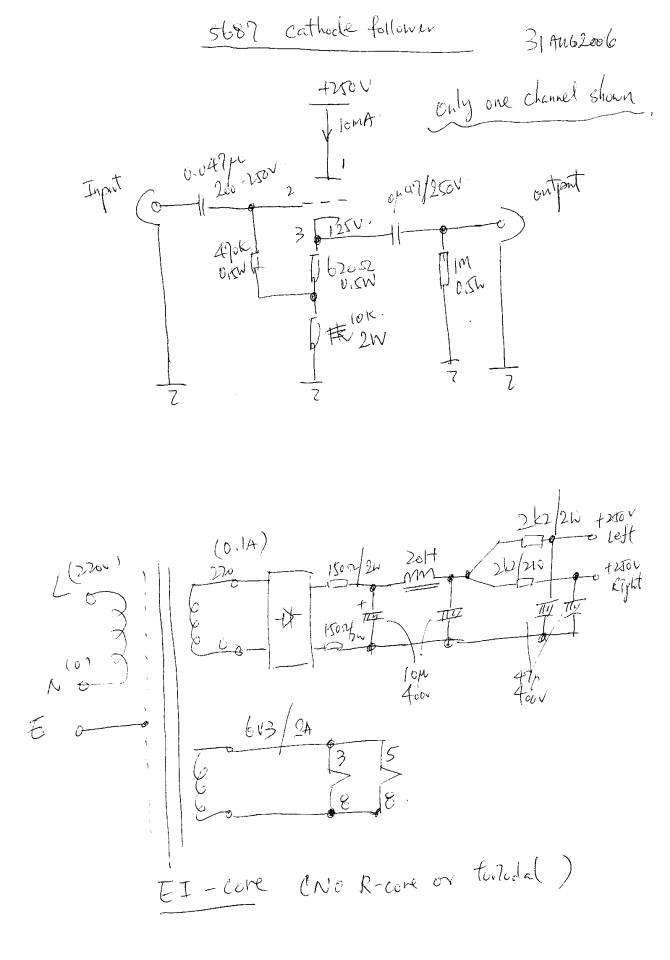

hi Jean-Charles,
very thanks U share your precious experiences to all diyers. me too!!!! But your design was not same as me. I agreed that use tube rectifier will slow warm up for both tubes. But I little worry for the noise. Sec was I still suggest use cathode follower in HV (B+250 10ma) in 5687 beause this tube was strong. In my small little test test this tubes was quite powerful. Although cathode follower magnification factor was <1~approx 0.9. But the dynamic power was quite good. Is your circuit directly connect from the IV resistors of the 1541a or from the Op-amp!
I was prepare the 5687 circuit, since the original one was I hand write only. over 300K file, I cannot post into the forum.
thx
thomas

Hi, Charles, pls take a look of my 5687 tube buffer.
thx
thomas
Hi Jean-Charles,
Do you have a power supply schematic for the tube output? I am searching on EBay and don't know what transformer to purchase. I need more direction to built the tube I/V stage. I can read schematics, but not design. Where to a attach the input of the tube I/V stage to? Directly to the output of the dac?
