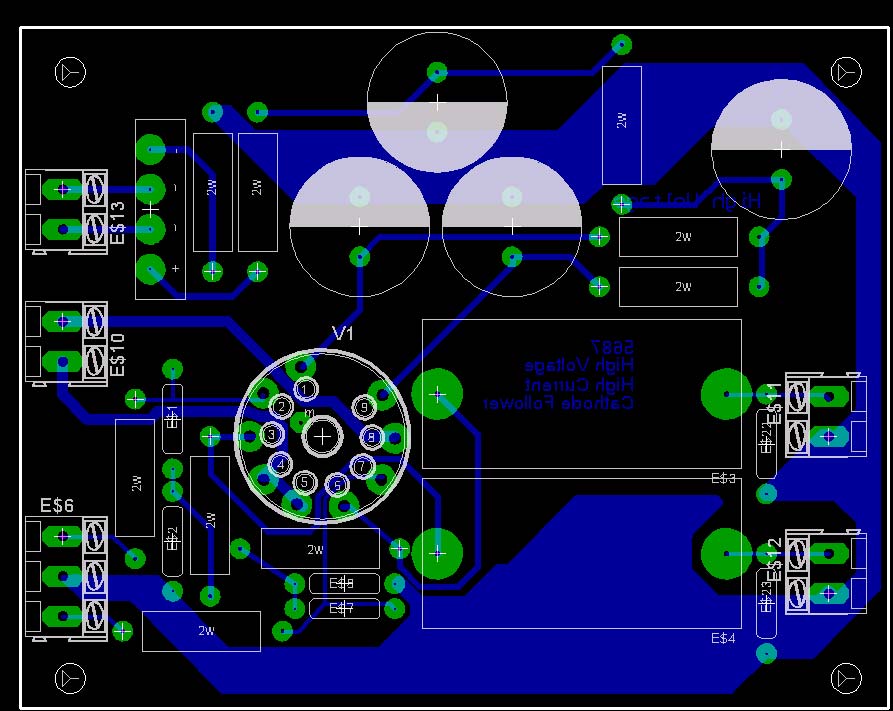

hi,
this is the high voltage & high current 5687 cathode follower for ver.3 & coming full balance 1541a dac.
test was more dynamic than standard 6922 low voltage one.
If Diyer did not like to use capacitor output, can use pre-amp transformer output.
thx
thomas
