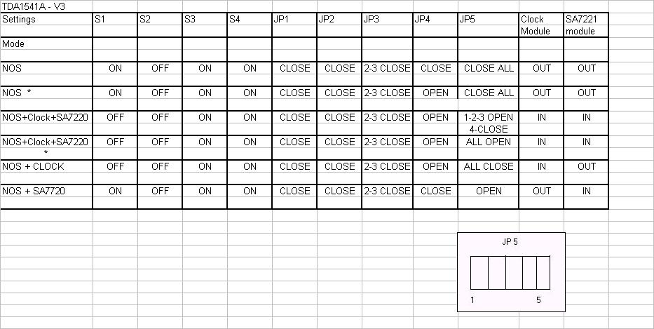

These are the settings I try, and wich are working.
Jumper: JP1 short, JP3 2-3 short, JP2 short
NOS mode
S2 - on off on on - JP4 close - JP5 close all - Clock out - SA7220 - out
NOS mode*
S2 - on off on on - JP4 open* - JP5 close all - Clock out - SA7220 out
NOS+SA7220
S2 - on off on on - JP4 close - JP5 open - Clock out - SA7220 in
NOS+Clock
S2 - off off on on - JP4 open - JP5 close all - Clock in - SA7220 out
NOS+Clock+SA7220
S2 - off off on on - JP4 open - JP5 1-close 2-3-4 open - Clock in - SA7220 in
NOS+Clock+SA7220*
S2 - off off on on - JP4 open - JP5 All open * - Clock in - SA7220 in
As you can see there are 2 mode for NOS and NOS+Clock+SA7220, but what are real ones...

Here is the updated settings chart with Stevox's inputs.
The asterix is for settings which work but need some explanation ( does it ? ).
The diagram shows JP5 as seen on the board. Left of the JP5 print is pin 1 and right of JP5 print is pin 5.
That should clear up any doubts.
Cheers.
Cheers.

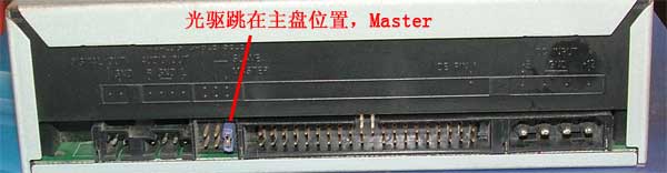

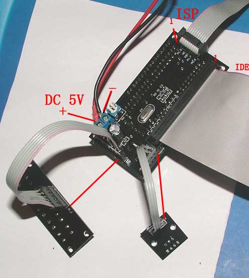

Hi Thomas,
In the photo it shows a cable ISP with pin 1 at the top. I don't have that cable, nor a discription of where it connects to the dac ver.3. My cd rom is set to master and it does not have a spdif digital out. I am also having a communication issue with the rom. The cd controller can see the rom drive, shows when it is open and a cd is inserted, and I can then press play on the button or remote and the rom will play, but then that is all. Stop, pause, etc. will not respond and when I press eject the counter stops on the display, but it still says play. I then need to turn power off for it to work again, then the same happens.

hi kip,
I understand what is the happen of the control, I hadn't test all cd-rom is it compatible to all CD-rom. I only test with ASUS & Plextor only. The best was plextor, more stable & more silent.
if the CD-rom was not compatible to control kit. This will be some function will not work.
