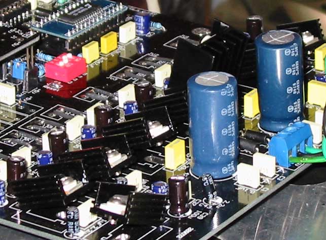

Temperatures.
Here are some operating temperatures.
The board is open and heat sinks slightly tilted to improve air flow.
U4 has a new heat sink .
I'll post a picture as soon as the camera batteries are cxharged.
Transformer secondary 14-0-14 volts. rectified dc is +18.6 V and -19.5 V.
Ambient temp is 30 deg C.
The ( stabilised ) temperature in brackets is when the ceiling fan is working , causing a medium draft of air over the board.
U1 is at 48 degC ( 37 )
U2 is at 44 deg C ( 37 )
U3 is at 43 deg C ( 36 )
U4 is at 91 deg C ( 58 )
U5 is at 58 deg C ( 39 )
U6 is at 37 deg C ( 32 )
U7 is at 56 deg C ( 40 )
U8 is at 39 deg C ( 33 )
U9 is at 33 deg C ( 31 )
SA7220 is at 54 deg C ( 40 )
TDA1541A is at 48 deg C ( 38 )
So having an outboard stabilised supply and a closed box will not help much. Will have to heatsink most chips to the chassis or like what Vikash did.

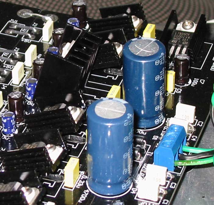

my setup for overheat solution
Hi Ashok,
I removed the U4,installed a dedicate +5V power supply(ultimate mini regulator) with tranfo for SAA7220.
Following the Dine1967’ idea I crossed a profile aluminium bar in the U’s remainder.
Now all works without overheat and the dac sounds better with the dedicate for SAA7220.

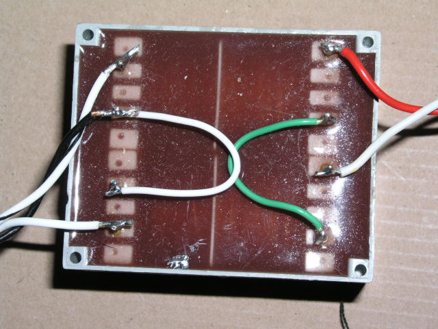

Another question. Now i haven't got any hum left, all capas in place. I tried to use the power trans and argh...
new problem. May be U could advise. It's just to see if i have made wiring fault :
I use "Thomas power trans", in France we have 230v ( 50 Hz). I join 4 and 6 and connect 1 to phase and 9 to neutral... If i'm good the two primary 110V (Power Spec) are in series. I join 14 & 17 to form the OV and 12 and 19 are normaly ( + 15v and -15V).
I didn't connect the secondary (12,19 and intersection of 14,17) to the DAC and i Directly plug 1 and 9 to main supply and
, no noise but quickly the power trans became really hot, platic insolating primary began to "inflate"
So to your opinion, have I made wiring fault
If not was it because in France we have rather 230V or 240V (peak) ?

hi rtd,
your case must be the pri winding was wrong connection.
the pri was.
Pls see the photos of the isolate power trans. I was afraid the phase was invert in your connection, if invert will short circuit& the plastic will blow up get hot with bad smell of the epoxy burn. May be the power trans was damage already.
pls see the photos.
the left side was sec winding small white wire was connet for two winding.
the large two white was 15V, small white wire with the black wire was 0V.
so the left side was 15~0~15V.
the right side was pri winding.
green colour wind was connect two winding in pri winding.
the red & white was ac 220or 230V input.
OK,
this is isolate power trans. In your case. I was worry will,be damage.
thx
thomas

h rtd,
the AWF cap need time to run in!!!!!!
this is a very good cap.
I will use in all my coming DAC.
Your old pwer trans may be not a isolate power trans so han,t this phase connect problem but will catch much noise from pri to sec. Isolate was more clear in digital area.
thx
thomas
