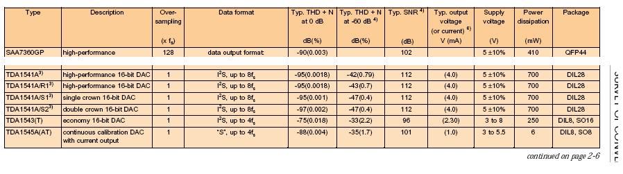

hi ,
TDA1541AS2 groups buy.
Pls check the photo for the sepc of different grade of TDA1541a chips, 1545 & 1543 also contain too.

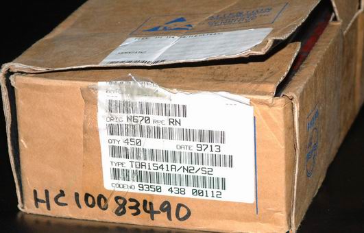

Since 9713 date code was almost the best of the TDA1541AS2 because this date code was under japan manantz & zandan lab standard & request for them to further selection.

All the chips was same date code same box of the chips from taiwan to japan to selections.

hi ,
