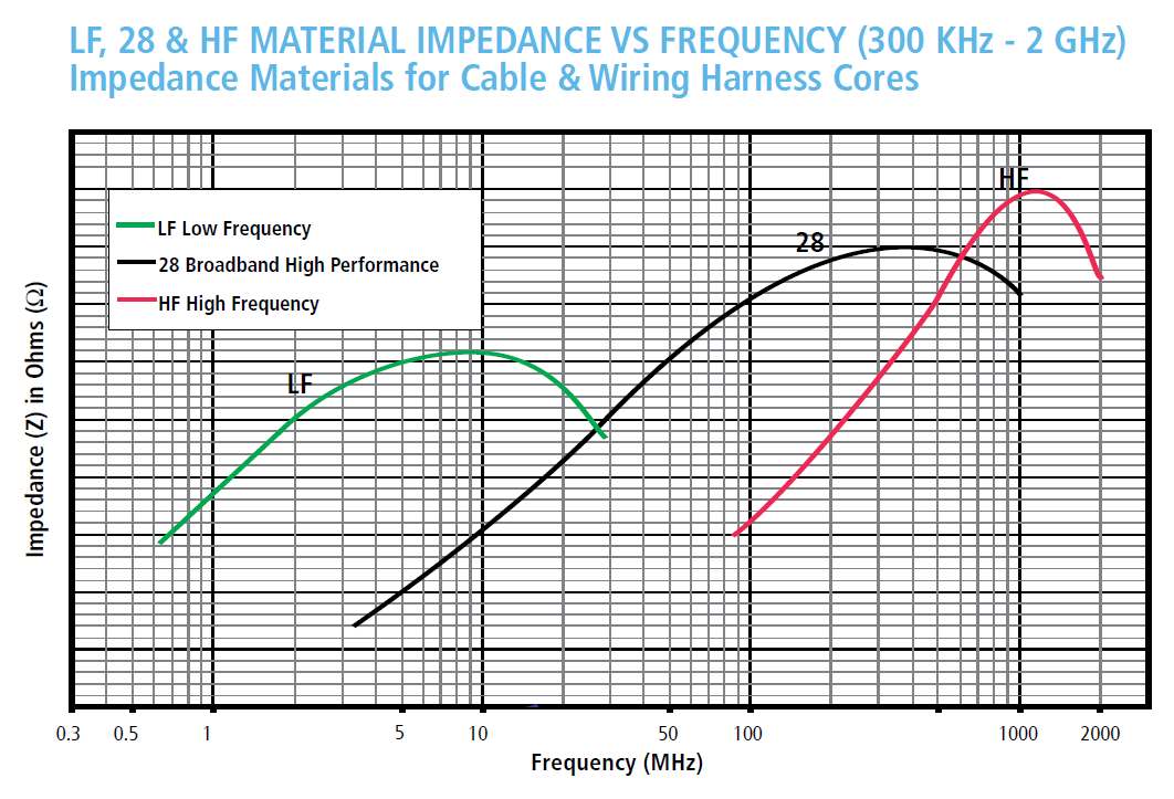

Mark:
I noticed the original spec ferrite core is a LF material core. Laird has a shorter, fatter LF core, the LFB143064-100 in stock at Mouser. Very similar spec, seems like it should work to replace the LFB095051-000. Maybe put a few more turns on the core? It is slightly smaller OD than the Wurth 74270035

I mostly wondered why you chose a core with low frequency optimized ferrite?
Does that matter? Or was it just the size/shape of the core you wanted?

Now that I have done some looking into core materials, I'm guessing the external choke on my Meanwell supply cable is probably #31 material, not great low frequency performance.
https://www.mouser.com/ProductDetail/709-GST25U24-P1J
So an even lower frequency material would be useful.
The Fair-Right 2675023002 has identical dimensions to your original spec Laird LFB095051-000 and is 43 ohms at 500K vs 36 ohms at 500K for the Laird. So it seems to be a good match for the application.
https://www.mouser.com/datasheet/2/150/2675023002-1666507.pdf
Mouser has plenty of Fair-Right 2675023002 in stock. That's the one I will order. Then there will be no worries about an oversize OD.

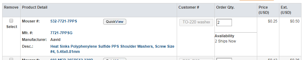

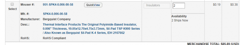

Weren't they there already? I just visited the diyAudio Store page for Noir (link) and clicked on its link to the Mouser shopping cart, in the "DESCRIPTION" section.
The very first item in that cart is the shoulder washer (figure 1 below) and the very last item in the cart is the TO-220 thermal pad (goes between MOSFET and heatsink) in figure 2 below.
What else needs to be purchased, that was missing from the cart?
Mark
Sorry, I was working off the old T2 BOM did not realize you had an updated one for the Noir. Maybe I'll just pull this list and create a new one that only shows the alternate fuse and core, along with RN55D resistors for those who are interested.

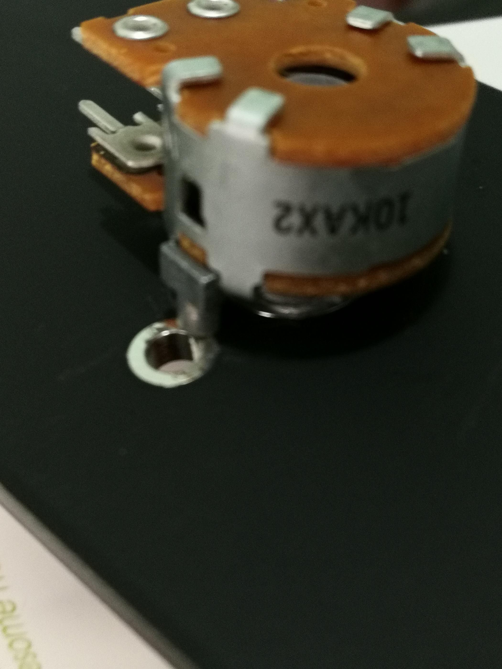

I have ordered the items in the Mouser basket, save 2 items as these weren't in stock.
For the Alps (delivery expected Februari 2020) I chose as temporary replacement:
1688-RK16312A0B85
RK16312A0B85
ALPS Potentiometers
The Alps mentioned above isn't a good replacement, the notch for the lock isn't in the right place:

If it's just a temporary "place holder" while you wait for an ALPS to be delivered, you could think about cutting off that peg with big side-cutting pliers. Or you could file it down with a file. The friction from the front panel fastening nut will hold the potentiometer in a fixed position, at least for a couple of months. You could also consider applying some hot melt glue around the pot, to adhere it to the inside face of the front panel. Hot glue can be removed later with an X-acto knife.
