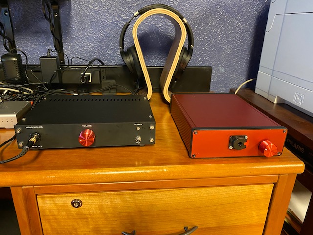

I completed my NOIR build earlier in the week. It was a fun build. When I plugged it in and listened to it thru a DIY pair of bookshelf speakers (old Madison design with Vifa drivers) I was totally floored at the articulate and nuanced the sound that emerged (Roon--> RP3 endpoint--> Hifiberry Dig+ Pro Toslink --> Schiit Modi MB --> NOIR -->ACA --> Speakers). I had never heard those speakers sound so good. Same result with Audeze LCD-1. Color me impressed.
Last year when I built my WHAMMY I used a red case with red Riverstone knobs I bought on Amazon at $10 for a pair. I used the other one on the NOIR. I think the red knob on black case looks terrific.
Congratulations on a very nice build, bchassy! The red knob does really pop against the black background of Noir. Maybe you'll want to also install a red power on/off LED to complete the look ...?
BTW I just ordered a pair of Audeze LCD-X's myself. Really looking forward to pairing them up with Noir (plus a couple other headphone amps, for comparison)!

The red led is a good idea. If I get it done I'll post it. The one I have in there now is more orange than yellow but it's definitely not red enough. Red and black are a great color combo.
