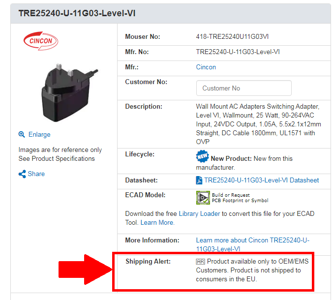

The wall wart suggested for Europe in the other thread is out of stock unfortunately (same for the UK version, which I actually need...).
Would this one work? TRE25240-U-11G03-Level-VI Cincon | Mouser United Kingdom
Ah yes, good catch! I'll check with DigiKey.
Found another one:
VER24US240-JA | XP Power, 24W Plug In Power Supply 24V dc, 1A, Level VI Efficiency, 1 Output Switched Mode Power Supply, Interchangeable | RS Components
More expensive, but free shipments without limit (at least here in the UK) and adaptable to different countries.

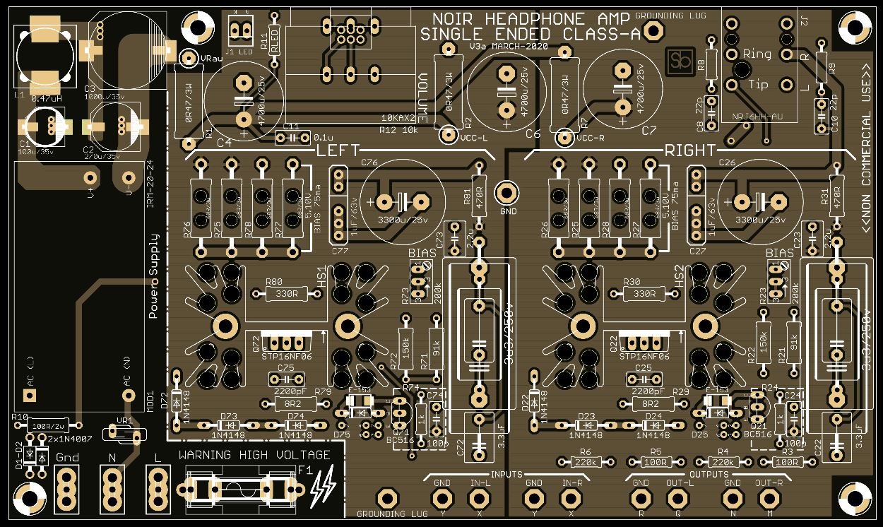

Stuck at home because the Gouv issued a request for everyone to stay home unless you need to go to the grocery store, I did my own version of the Noir, an intriguing very nice HP amp. Tom of Neurochrome did a detailled analysis of the amp and he identified a few areas where the original design may be improved such as the power supply noise floor, channel separation and a slight oscillation under certain load. I don't pretend to be able to improve an already mature design, but I may try. I still used the same circuit topology but I also added a few twists of my own. No need to mention that it is a private project, just for me. The official project is still on diyaudio store. Here is what I did:
I like integrated power supply, so I added a 24V SMPS power supply, with CLC filter (same as my version of the B1 preamp), followed by one common and then two dual CRC filters (one final RC stage per channel) to try to reduce the noise floor, added two possible ALPS volume pots on the same pcb, reroute the input traces up to the pot to separate them with gnd traces and split VCC layers per channel to try to improve channel separation, added a chassis Ground lifter for the audio ground, reversed the VCC on the positive side, and the gnd as I prefer. Finally I also added a snubber network at the output, apparently the original circuit can oscillate a little depending on the load. The snubber exact values (if they are needed) are still not determined... It still fits into the same enclosure, but it doesn't work with the store included front panel. No problem I'll do my own... Here a picture of the concept.

You might be forced to choose the next-bigger Galaxy 1U chassis (230 mm deep instead of stock Noir's 170 mm deep chassis) in order to create enough room for an IEC mains inlet. If so then you can select an IEC inlet with integrated fuse; that will allow the user to replace a fuse from the outside, without having to open the cabinet and fiddle with the PCB. It also allows you to select an IEC inlet with both an integrated fuse and a mains power switch. I don't see any flywire / external I/O terminals for an on-off switch on your PCB layout. Since Noir consumes 8 watts thanks to class-A operation, you might want to turn it off when you're not actively listening.
