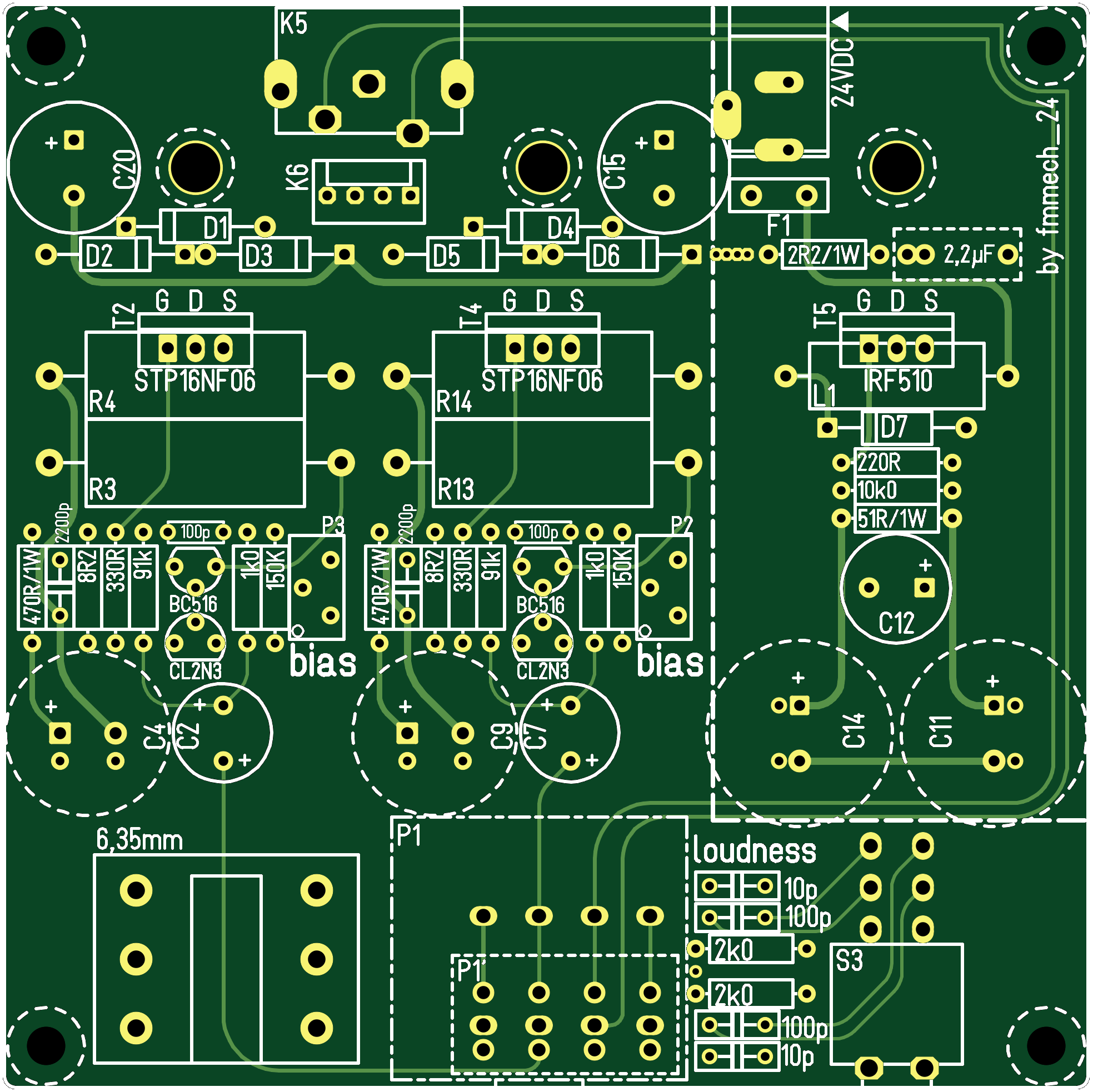

Noir, a two transistor headphone amp: class-A, single ended, 150mA bias

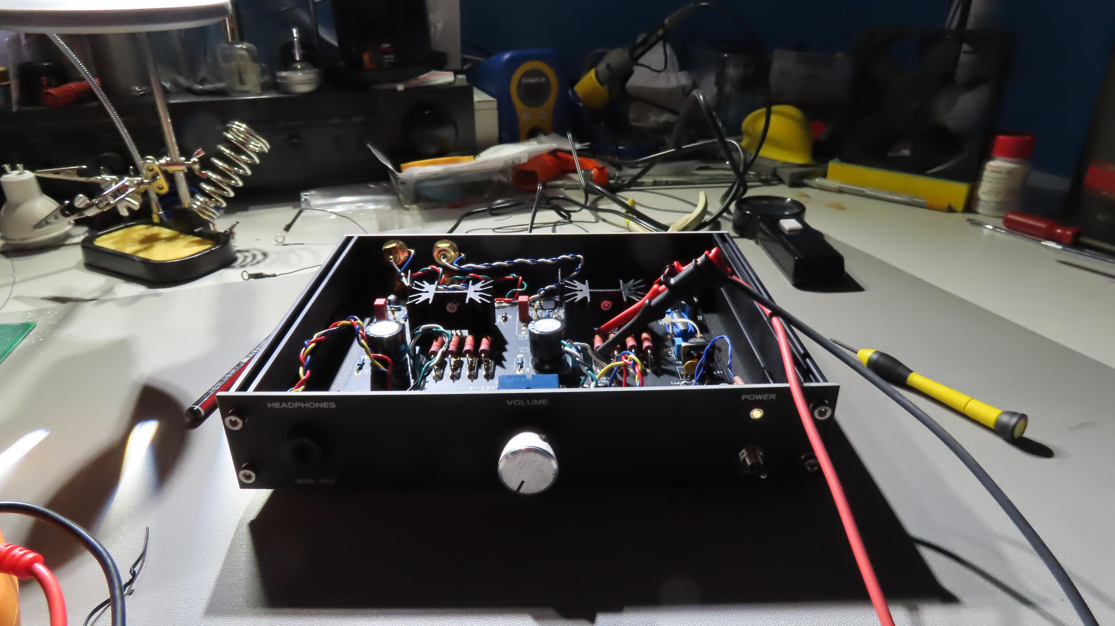

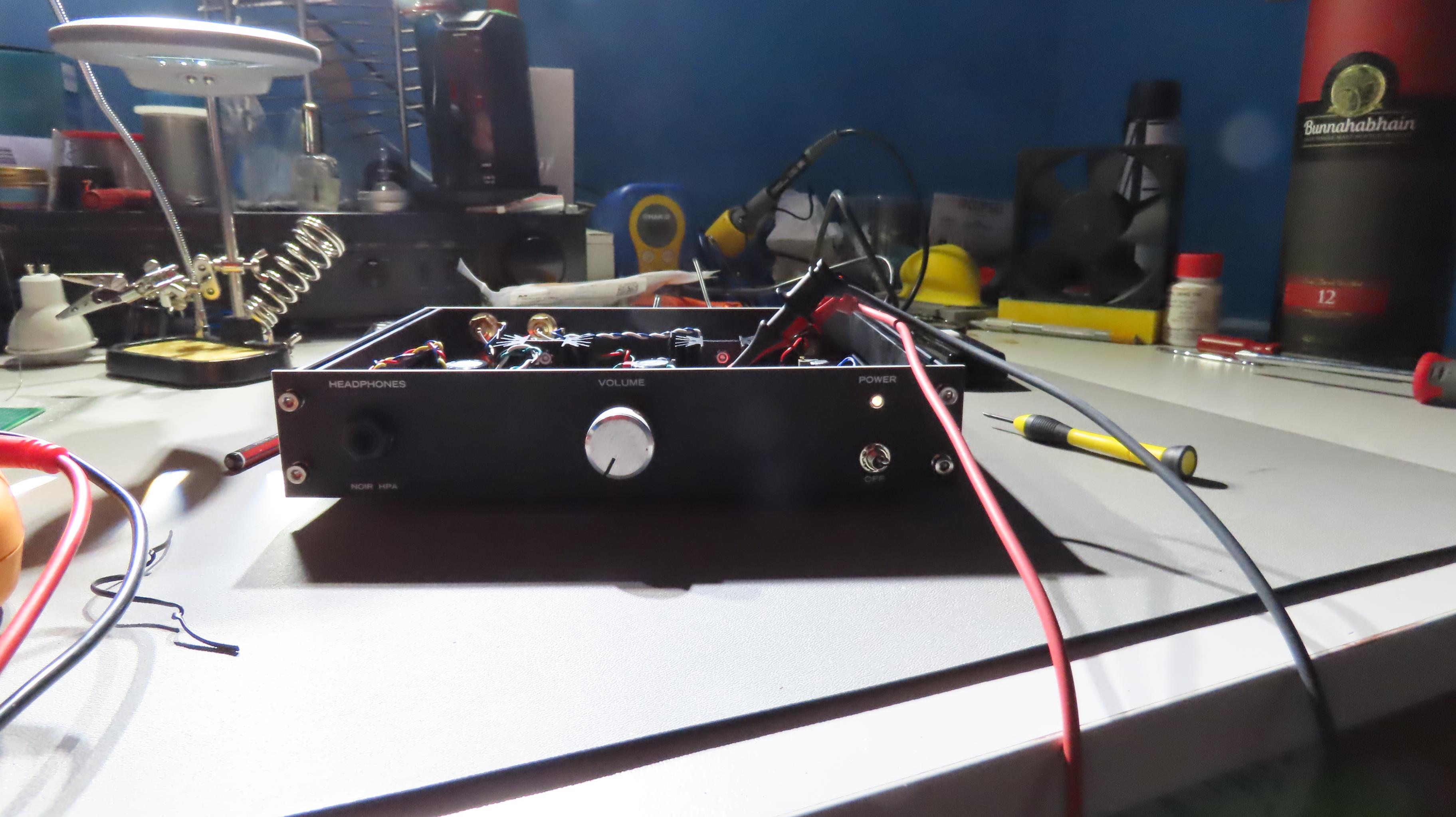

Mine.
Set the bias to 5.1 volts and left it overnight, this morning it reads 5.106 and 5.107.
Gotta be happy with that.

Great job, fmmech_24! You're going to have a lot of fun with your HPA design!

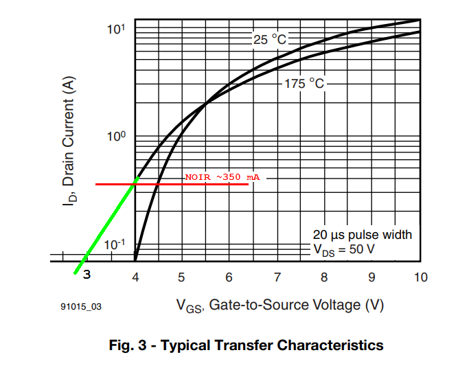

You might want to experiment with different bias voltages and currents than the standard Noir, since your HPA will operate on a lower supply voltage than Noir. Different supply, different optimum bias point.
The IRF510 in your supply smoother, has a fairly large gate-to-source voltage drop. Thus the supply smoother has a fairly large input-to-output voltage drop, perhaps on the order of 4.0 or 4.5 volts.

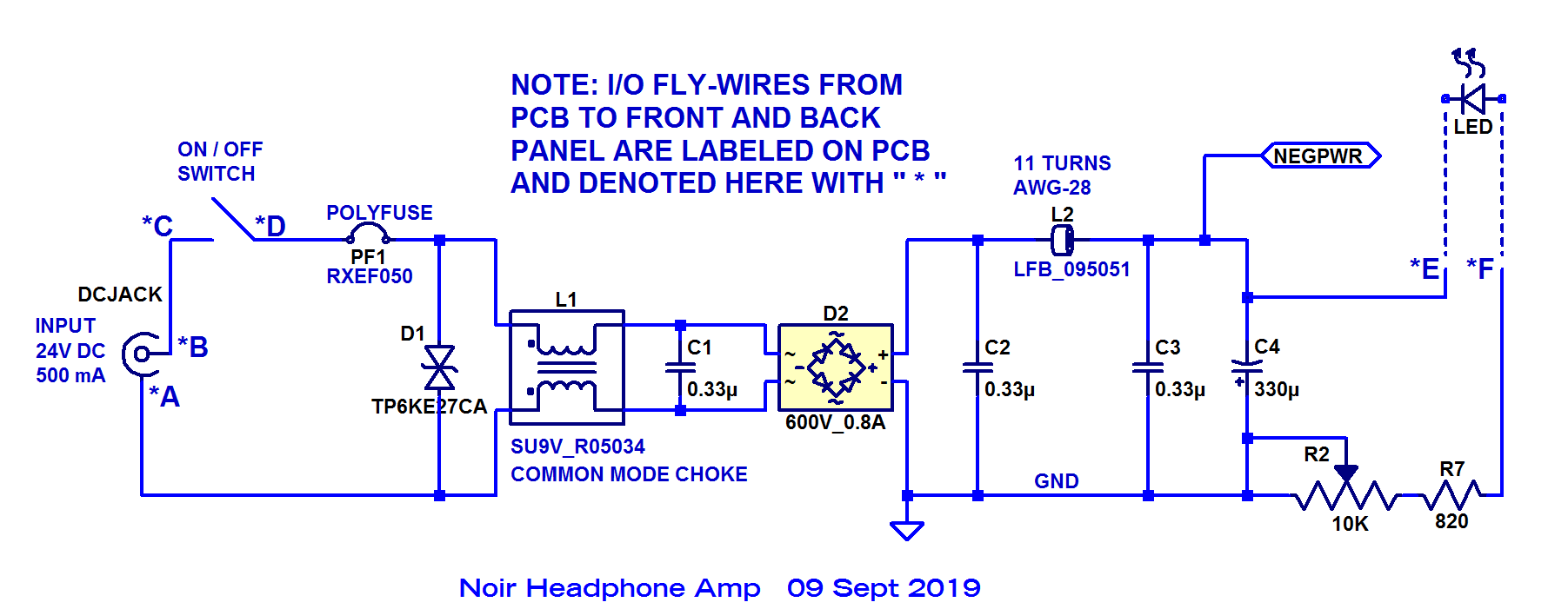

Hey fmm. There is a problem in your circuit. You are about to put the 24v to the Output. Also the bleederresistor is in the powersupplyline. Not on ground as it have to be. Dont know if it is a drawing problem or a "real" problem
PjVervoorn: those look like good choices. US and Canada buyers can also buy the ALPS Blue Velvet potentiometers from Parts Express (here is a LINK), maybe they will also sell to customers in Thailand (?). And of course eBay sells lots and lots of Blue Velvet pots, we just don't know whether they are counterfeit or genuine.
Looking at the power supply schematic shown in Post #1, it looks like the polarity of DC output of D2 is reversed. No doubt the pcb is correct as many amps have been successfully built. 😀
