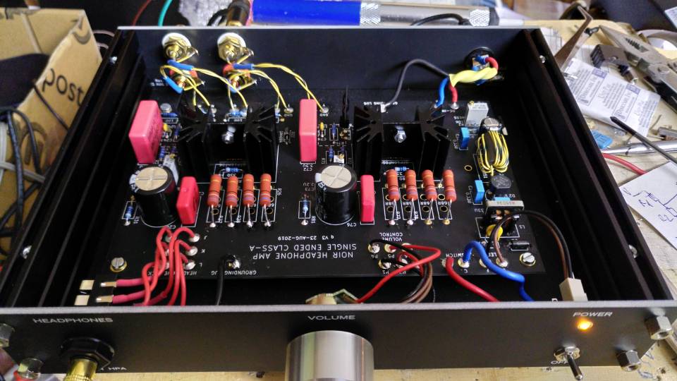

After a few hours of work I could finish my Noir build today. As Mouser does not ship the recommended wallwart to Europe, I ordered a Meanwell with equivalent specs.
Bias es easy to set to 150 mA and so I went on listening after bias had stabilised.
First tunes over my AKG 712pro were not to talk about, yet it became more soud after a while. So I am curious about how it will sound after some forming hours.

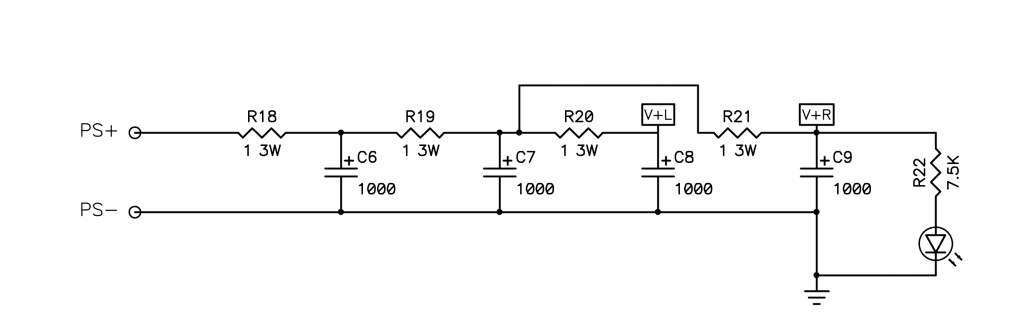

I noticed that the psu cap in the amp is just 330 uF. Somehow I feel inner motivation to put a bigger one on its place. Would this benefit the sound in any way?

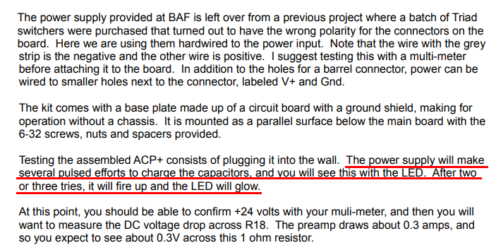

Ernst, many SMPS wall warts contain short circuit protection circuitry, which falsely triggers if there is "too much" capacitance connected across the supply output pins. For example, the "ACP+" project from Burning Amp 2019, connects about 4000 uF from supply to ground, and this is enough to make the wall wart sputter and belch. They're using 24VDC @ 0.5A. If you experiment with larger and larger amounts of bypass capacitance, it would be wise to unplug the headphones before turning the unit on or off!
On the other hand, why not try it? The worst that can happen is: you'll find out how much capacitance is too much. You'll also find out whether you detect any improvement or degradation in the sound.

Congratulations on a beautiful build, Ernst! I like your idea to rotate the 6.35mm headphone jack, it made your wiring extremely clean and tidy. It also looks like you are using a "DACT stepped attenuator" volume control. Kudos for personalizing your unit!
Mark
Mark,
Your kind words make me happy! Yes, this is a DACT type attenuator. I like them as they are more matched channel wise, even I wish they were a bit more logarithmic...
And I use old MKC foils. ZM likes them, so I like them ;-)
