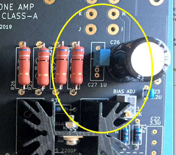

I'm starting to build it up and I receive most of parts. Quick on on C27 and 1U. Which one do you recommend? I usually put WIMA but they seem too big.
I'm going for this one at Digikey (BFC247076105) spacing is good.
Any other recommendation?
The TDK-EPCOS 1uF film caps mentioned in the BOM, Mouser P/N 871-B32529C105J , appear to be backordered at Mouser.
However the same capacitor is in stock and on the shelf, if you're willing to buy it in "Ammo Pack" rather than "Bulk". Which I am. Mouser P/N 871-B32529C105J289
Those who want a really cool-looking capacitor with a green case, manufactured using the acclaimed-by-audiophiles Polypropylene dielectric, can consider Mouser P/N 80-F461BS105M250A
WARNING: measure the available space on the PCB and double check it against the capacitor's datasheet, before ordering. Don't buy one that won't fit!
