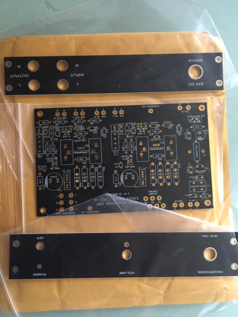

I hope and trust you also read that the set of PCBs sold in the Store, includes front and rear panels for the Galaxy 1U chassis (any & every depth), including pre-drilled holes and pre-printed labels / silkscreen. These panels are made of thick black PCB material, they are PCBs in fact; and they allow builders to complete the Noir without owning or using a drill press. Image from the Store's sales page attached below.
_
If you get the kit, the chassis comes with the solid front panel that you can use the PCB as a drill guide if you so choose. I personally like the solid black/thicker front panel so I went that route but my initial build used the PCB front panel that came with the kit and it works fine (and looks good)

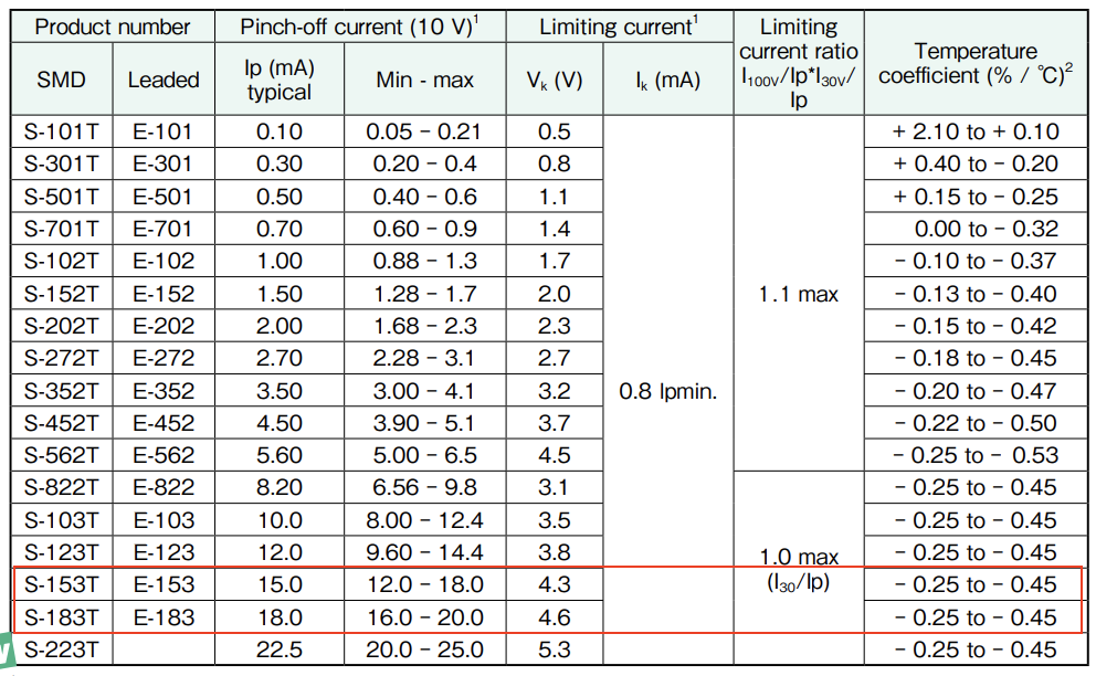

Hi all! I am going to build Noir and have orded the PCB and the chassis already. Now working on the parts list in Mouser.
I have two questions on alternatives as original BOM items are not available at the moment.
1) Current Regulator Diodes D25, D75:
original E-153 is not available, so I want to choose E-183 as an alternative. Their characteristics differ as shown in the first attached picture.

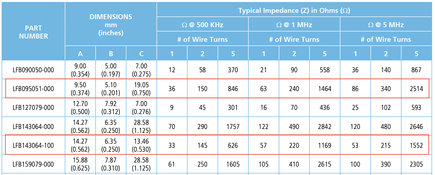

2) Ferrite core:
original LFB095051-000 is not available; want to substitute it with LFB143064-100; a bit different size, but quite similar impedence characteristics (see the second picture). I don't worry about the size, I think it will fit, but would I need to change the number of wire turns with the alternative?
I am good at building these nice things, but, unfortunately, not yet able to understand how they work, so your advice would be very much appreciated.

Have a look at posts #127, 128, 129 in this thread, for ideas about alternative ferrite cores. Wind as many turns as you are able to do comfortably, and be happy.
The PCB includes a footprint for the E-153 in both thru hole AND surface mount packages. My first preference would be to use the designer's chosen part (E-153) in surface mount
link to EU Mouser
My second choice would be to try the E-183 and hope for the best.
link to EU Mouser

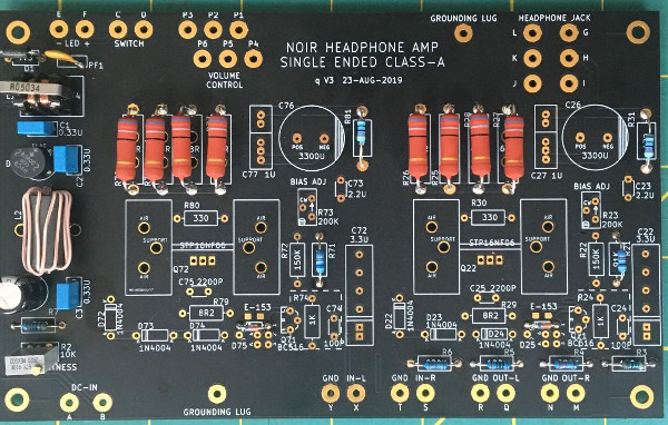

Mark, super simple question, I suppose, but just to be sure for the noob -
Do I understand correctly that R7 (820 ohms) it there just as a minimal resistance to not burn the LED, and if I do not want adjustable R2 as I know what LED and what fixed resistor I want with it, then I can put my resistor in R7 and jumper the R2. Correct?
-Alvis
-Alvis
Just a build update. Its going slow and steady so far. My son did help a little bit but I still did most of the soldering. I like the Mega328 component tester. Its a little inaccurate with the inductors but otherwise pretty good. I have the power supply bits done and some of the resistors for each channel.
I have built Noirs with solid core insulated wire and with stranded insulated wire for L2. They worked equally well in my experience. Use what you've got.
R30 and R80 should be 330 ohms as shown on the PCB and the schematic. Although there's an excellent chance the HPA would work correctly with 100 ohms, 330 is the correct and preferred value. Feel free to try both and see whether you hear any difference.
